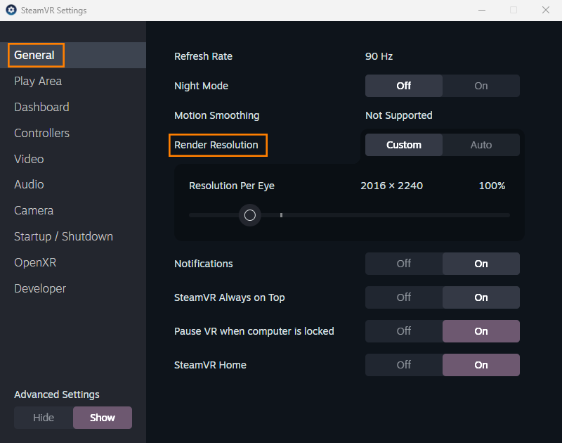

  3. Open SteamVR Settings and make sure that no scaling is applied to resolution:
    Settings -> General -> Render Resolution -> Resolution Per Eye = 100%

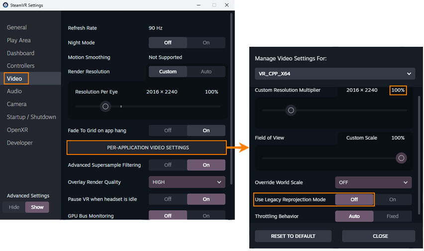

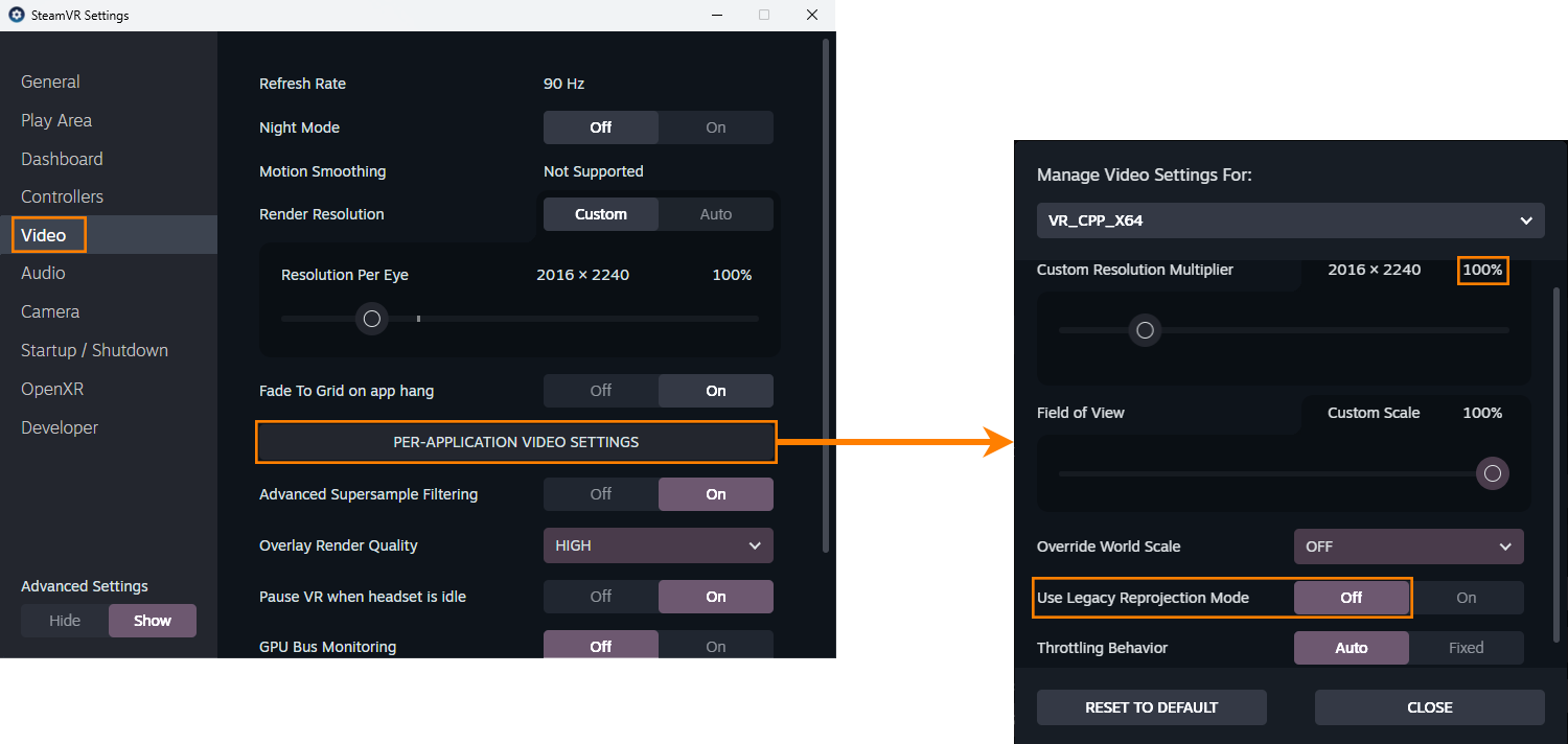

  5. Open the application settings in SteamVR and make sure that no scaling is applied to resolution and Legacy Reprojection is disabled:
    Settings -> Video -> PER-APPLICATION VIDEO SETTINGS

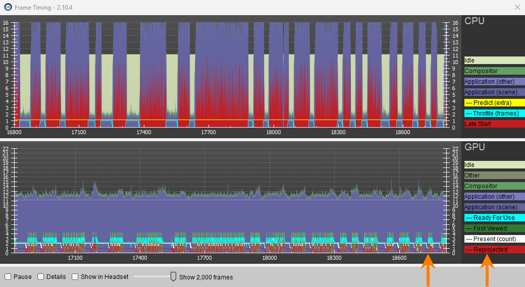

You can verify that reprojection is active by using SteamVR's built-in frame timing tools: Settings -> Developer -> Advanced Frame Timing. A graph overlay will appear showing frame timings.
Look at the GPU graph (bottom part): if you see red spikes or a red line, that indicates reprojection is active:

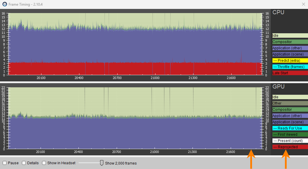

No red indicators mean that reprojection is not working:
