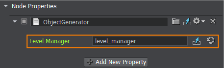

  3. Select the object_generator node in the World Nodes window and drag the level_manager node to the corresponding field of the ObjectGenerator property.
