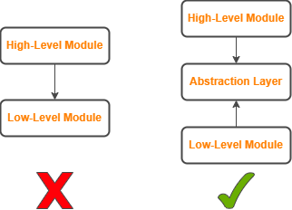

Dependency Injection (DI) is a way to write code that's flexible and easy to manage. Rather than creating or directly referencing its dependencies, a class receives them from outside.
Classes depend on an abstraction (an interface or abstract class) rather than a concrete implementation. This approach adheres to the Dependency Inversion Principle (DIP), which states that high-level modules should not depend on low-level modules; both should depend on abstractions. Moreover, abstractions themselves should not depend on details – the details should depend on the abstraction.
By following DIP, you reduce direct coupling and make it easier to replace components without affecting higher-level logic.
Abstraction diagram

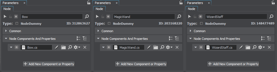

    Nodes with components

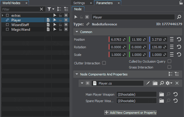

  4. Inject the Concrete Implementation.
    This step is where the wiring happens. The interface reference in the client must be assigned a concrete object instance that implements the interface. There are a couple of ways to do this using UNIGINE features:
    • Via the Editor. In UNIGINE you can expose the interface field in the component parameters. By default, parameters are displayed or hidden in the UI in accordance with access modifiers: public - displayed, otherwise - hidden. But you can show a private or protected one by specifying the corresponding visibility attribute ShowInEditor as shown above in the code sample.
      Then, you simply assign a node with an assigned component that implements your specific interface.
      Using interfaces in Editor

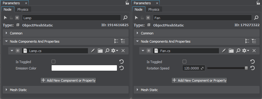

    Nodes with abstract components

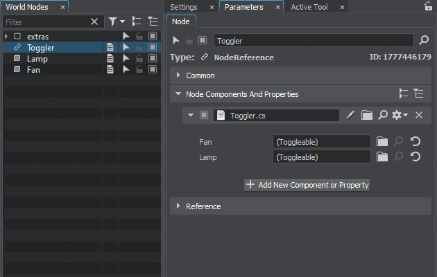

  3. Inject a Concrete Subclass Instance into the Client Class.
    Similar to the interface case, the client that needs the functionality holds a reference of the abstract base class type. Then, because of polymorphism, you can pass specific implementations of the abstract class to the client class in two following ways:
    • Via the Editor. Simply assign a node with the assigned component, that inherits your abstract base class in a node Parameters window:
      Using abstract classes in Editor
