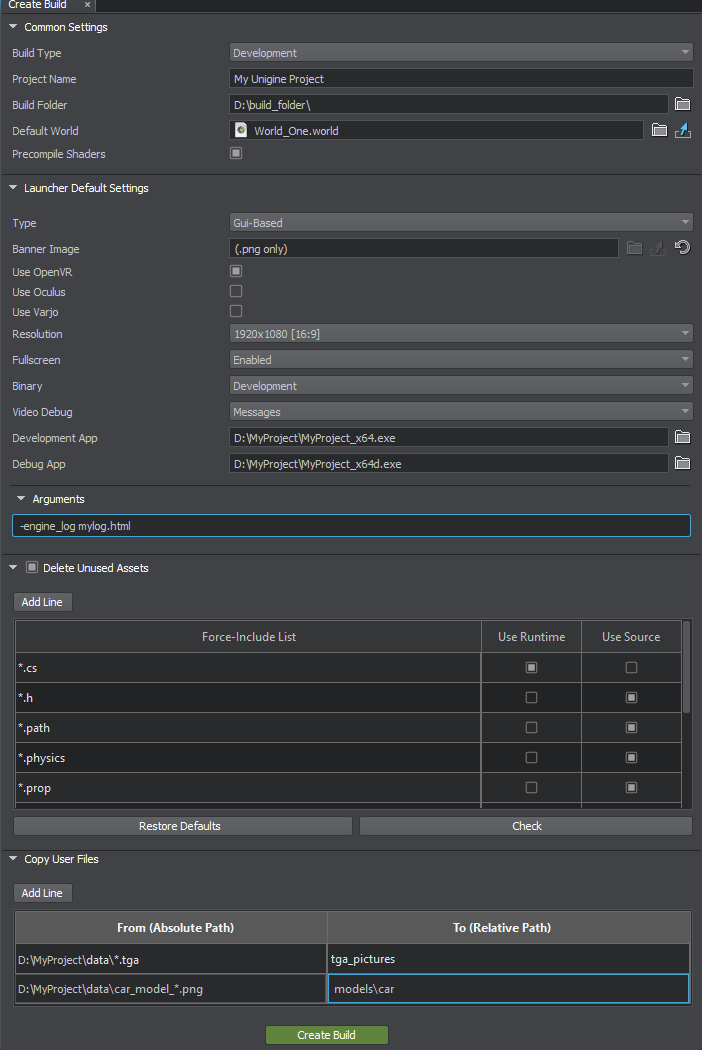

To create a final build for your project via UnigineEditor, perform the following:
  1. In UnigineEditor, select File -> Create Build. The Create Build window will open.
  2. Specify the required settings and click Create Build.

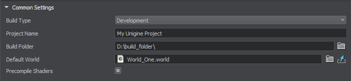

Common Settings#
Build Type
(config)
Type of the build that defines which binaries are copied:
  • Release — optimized binary without any additional debug info.
  • For the Development build, two binaries are copied:
    • development binary — optimized binary with Microprofile enabled
    • debug binary — unoptimized binary with debug information enabled
If the project's SDK is unavailable, this option is unavailable, as well. In this case, Build Type is defined by the build of UNIGINE Engine selected at the project creation.
Project Name
(name)
Name of the output executable or .bat/.sh file. This name shall also be displayed as the Launcher's title and a title of the application window as well.
Build Folder
(path)
Path to the output folder where the build is going to be stored
  • You shouldn't create this folder inside your project folder, as it may significantly increase its size.
  • Build folder should be empty, otherwise, its contents will be deleted!
Default World
(world)
The world that is loaded when the application is started. If no world is selected, the User shall be responsible for loading worlds via code, otherwise, a black screen will be displayed when running the application.
Application Icon
(icon)
Sets the application's icon to a user-provided image. A square *.png image is expected.
Precompile Shaders
(precompile)
If enabled, generates shaders for the current Video API.
Shader cache increases performance and reduces spikes and freezes in the release application, which makes it very important for the release build. If the shaders have already been precompiled, selecting this box won't affect the build time.

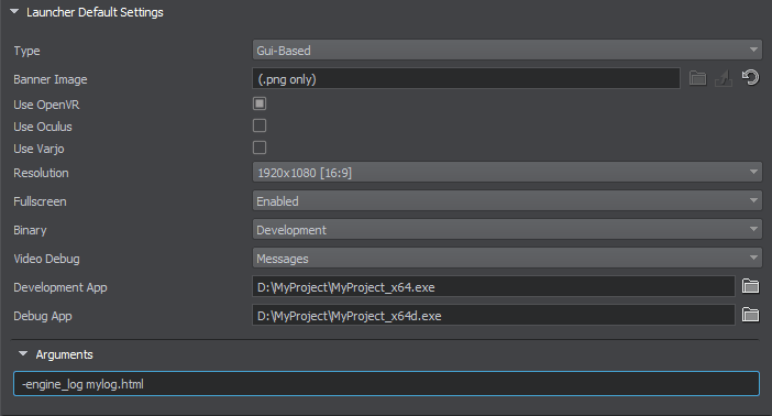

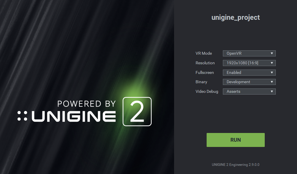

Launcher Default Settings#
These settings are used as default (pre-selected) launcher settings. The launcher for the Development build displays more settings than for the Release build.
GUI-based launcher for the Development Build
Below are the settings used by the tool to generate a launcher for your application.
Type
(launcher)
Type of the launcher:
  • GUI-based — executable file with the name <project_name> is created. Running this file opens the GUI with the default launcher settings. These settings are stored in the <project_name>.lconfig JSON file.
  • <project_name>.bat (or .sh for Linux) file is created that contains the default launcher settings.
    In case of the Development build with the project's SDK available, two files are created: <project_name>_development.bat (or .sh for Linux) and <project_name>_debug.bat (or .sh for Linux).
Banner Image
(banner)
The image to be displayed in the launcher. Available for GUI-based launcher only.
To assign an image, drag it from the Asset Browser.
Only PNG images can be used. Window height is restricted to 600px, so images are automatically shrinked or enlarged to fit this height (proportions are kept).
Use OpenVR Check this box, if your project is intended for OpenVR. This will enable OpenVR mode selection in the application launcher.
Use OpenXR Check this box, if your project is intended for OpenXR. This will enable OpenXR mode selection in the application launcher.
Use Varjo Check this box, if your project is intended for Varjo. This will enable Varjo mode selection in the application launcher.
Necessary VR modes (three options above) for the console mode are specified in the configuration file as follows (list the ones you need):
Source code
"vrmodes": [
	"OpenVR",
	"Varjo"
	"OpenXR",

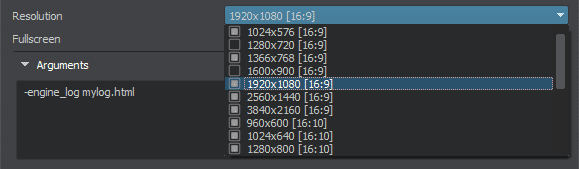

Resolution
(selected_res)
The resolution of the application screen. Multiple resolutions can be selected. The resolution that is clicked upon is set as default.
Multiple resolutions for the console mode are specified in the configuration file via the resolutions parameter (list the ones you need):
Source code
"resolutions": [
        "d": 9,
        "n": 16,
        "w": 960
        "d": 9,
        "n": 16,
        "w": 1024
Fullscreen
(full_screen)
Fullscreen mode:
  • Disabled — application shall run in the windowed mode
  • Enabled — application shall run in the fullscreen mode
  • Borderless Window — application shall run in the fullwindow mode, when an application window is rendered without decorations
Binary
(binary)
Type of the binary to be selected by default in the launcher, if the selected build type is Development build:
  • Development — optimized binary with Microprofile enabled for performance check
  • Debug — unoptimized binary with debug information
This setting is available for the GUI-based launcher only. The .bat/.sh launcher will create scripts to run the correpsonding executable files.
Video Debug
(vdebug)
Toggling the debug context of the Graphics API. Available for the Development build type only.
Release App / Development App / Debug App
(main_release / main_dev / main_debug)
Path to the corresponding binary to be run. The binary depends on the type of build.
This option is for the projects that do not use C# Component System.
Note that the binary is defined automatically, if it remains located in the bin/ folder. If it has been moved elsewhere or rearranged in some other way, the path to the file is to be set manually.
Arguments
(args)
Additional start-up command-line options.
UnigineEditor creates the <project_name>.lconfig file that Launcher uses to run the app. If a user changes any parameters and runs the app, the changes are saved in <project_name>.lconfig. Closing Launcher without running it discards any changes.

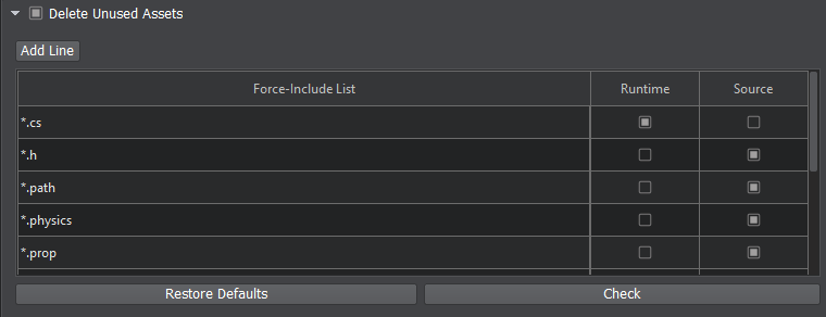

This feature enables you to delete all unused assets from the final build. To turn it on, check the option near the Delete Unused Assets section heading.
The table enabled below allows you to specify assets to be force-included in your final build. Here is how it looks:
The Build tool scans all assets of the types specified as wildcards (including location) in the Force-Include list (*.world, *.cs, *.fbx, *.prop, etc.), automatically resolving all dependencies (an FBX asset shall be checked for all meshes, meshes shall be checked for materials assigned to their surfaces and so on...). Thus, all assets in your project that are used by the assets of the specified types are collected and included in the final build.
You can add more asset types to the list or remove existing ones by simply right-clicking on the desired line (a new line shall be inserted after the one you clicked on). You can also click Restore Defaults to reset the list to its initial state.

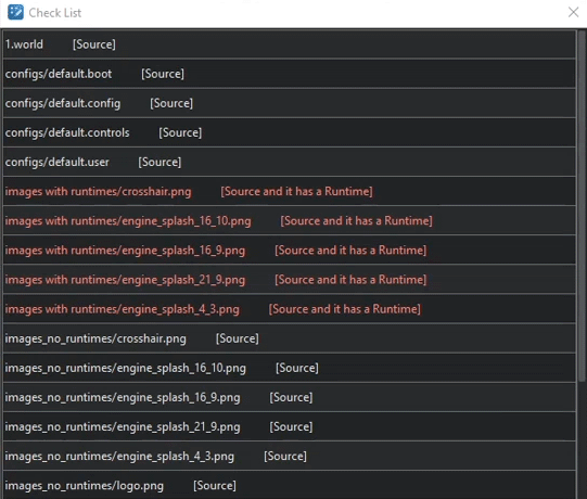

For each type of assets in the list you can specify whether to include runtime or source file. But be careful, as checking only Runtime for .png textures will result in ignoring the ones with the Unchanged option enabled (i.e. having no runtime), they simply won't be included. To check your list against such cases click Check, the following Check List window will open:
In this window all files found in the process of scanning are listed. The ones in white are ok, but the ones in red require your attention, for example, you may mistakenly choose to include source for an asset that has a runtime. So, be sure to look through red ones. The following options are possible:
  • [Source and Runtime] - both boxes are checked (both source and runtime files shall be added).
  • [Source] - when Source is checked and the asset has no runtime (only the source shall be added).
  • [Source and it has a Runtime] (shown in red) - when Source is checked, but the asset has a runtime (only the source shall be added).
  • [Runtime] - when Runtime is checked, and the asset has a runtime (only the runtime shall be added).
  • [No Runtime] (shown in red) - when Runtime is checked, but the asset has no runtime (nothing shall be added).

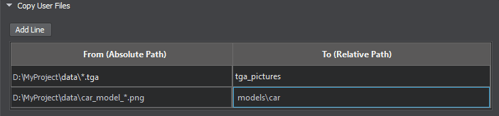

User files are added to the build folder by filling in the table with two columns:
  • From (Absolute Path) — an absolute path to a source file or folder. Folders can be specified using wildcards.
  • To (Relative Path) — path to the destination folder that is relative of the Build Folder. It can be a folder name where the file or files are copied to, or a folder and a file name, i.e. the copied file can be renamed as well.
There are some rules for adding user files to the build folder:
From (Absolute Path) To (Relative Path) Comment
C:\test\<folder_name> <another_folder_name>, or
\<another_folder_name>, or
\<another_folder_name>\
All files and folders inside <folder_name> will be recursively copied. Thus, it doesn't matter if you use slashes or not.
C:\Pictures\screenshot_alb.png \folder_with_pictures\, or
One file with the name indicated in the From column will be copied into <output_folder>\folder_with_pictures\
C:\Pictures\screenshot_alb.png \folder_with_pictures\123.png
But: 123.jpg (or 123.png)
The file will be renamed.
However, if the target file extension is written incorrectly (differs from the actual file extension), a new folder with such name will be created instead, i.e. the resulting path of the example destination files will be:

Wildcards can also be used to define the rules for copying user files.
C:\test\<folder_name>\*.tga <tga_pictures> All files with the indicated extension from the selected folder will be copied to the specified folder.
C:\test\<folder_name>\ab*z.png <another_folder_name> All files with the name starting from ab and ending with z.png from the selected folder will be copied to the specified folder.
C:\test\<folder_name>\nn* <another_folder_name> All files with the name starting from nn from the selected folder will be copied to the specified folder.

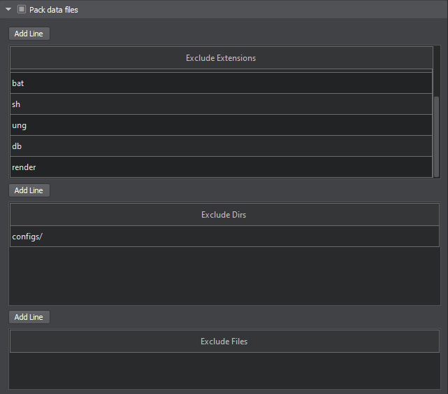

Pack Data Files#
When enabled, this feature packs the project's content files into a single archive file named data.ung, located in the project's data directory.
Packing is primarly used to save disk space or to bundle the production version of project resources. In addition to reducing size, archives also improve resource loading speed, as files are read linearly from a single source.
Configuration options:
Option Description Default Exclusions
Exclude Extensions List of file extensions to exclude from the archive. Files with these extensions will remain unpacked in the data directiory. cache, gpu_cache, exe, bat, sh, ung, db, render
Exclude Directories List of directories to exclude. All files and subdirectories within these will remain unpacked. configs/
Exclude Files List of specific file paths to exclude from packing. (none by default)
The default exclusions are selected to ensure proper engine behavior and avoid runtime issues. Modifying or removing these default exclusions may lead to unexpected results:
  • cache / gpu_cache - These files may be generated or modified by the engine at runtime. Packing them could cause inconsistent cache data to be used, leading to rendering or performance issues.
  • exe / bat / sh - Executable scripts cannot be run directly from inside packed *.ung archive. To ensure correct execution, they must remain as separate files.
  • ung - Nesting *.ung archives inside another *.ung is not supported and can break data access logic.
  • db - Database files are often accessed directly and can be locked or written to at runtime. Packing them can interfere with read/write operations and lead to data corruption.
  • render - These files contain runtime rendering settings. If packed, they become read-only and cannot be dynamically updated by the engine.
  • configs/ - Packing this directory would prevent the engine from modifying or saving these settings, potentially leading to loss of configuration changes.
Although the engine can transparently read content from *.ung archives, any file or folder that needs to be written to, executed, or externally accessed must remain unpacked.

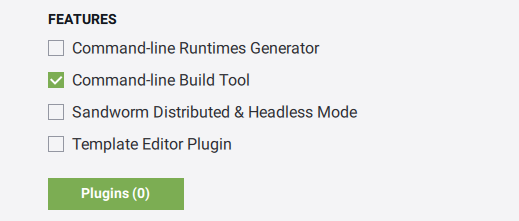

Console Build#
To simplify continuous integration (CI) and batch processing the Build Tool supports console-based management. The Build Tool will be located in the bin folder of your project if the corresponding option is enabled in the Features list in your project configuration.
