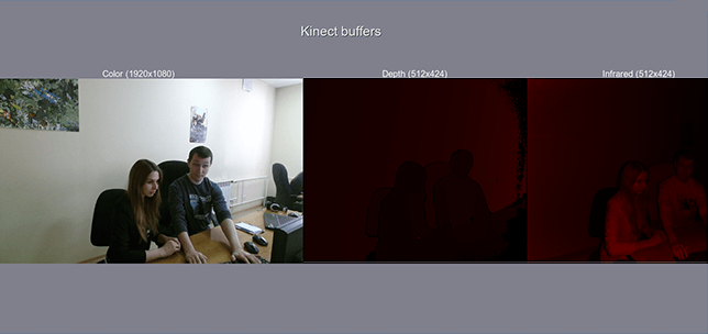

kinect_00 Sample that shows Kinect buffers: color, depth, and IR range

The plugin can receive the following types of data:
- Buffers: color, depth, IR range.
- Virtual skeletons (up to 6 skeletons can be detected): position and orientation of bones in a 3D world, position of hands, accuracy of each bone detection.
- Faces (up to 6 faces can be detected): face boundaries and facial key points (eyes, mouth, nose) in coordinates of color and IR buffers, features (eye glasses, smile, closed eyes).
