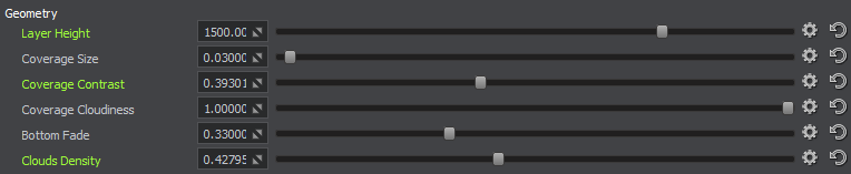

Geometry#
Layer Height | Determines the height of the cloud layer.
Coverage Size | Determines the size of the coverage texture.
Coverage Contrast | This parameter determines the contrast of the coverage texture and can be used for fine tuning. It also makes it possible to gradually increase cloudiness without changing the coverage texture when simulating weather. The lower the value the more cloudy the sky looks.
For this parameter to work properly, the coverage texture must not contain absolutely black pixels.
Coverage Cloudiness | Intensity of storm clouds coverage that is stored in the Green channel of the Clouds coverage texture.
Bottom Fade | Determines the form of clouds bottom. Lower values make the bottom more flat.
Cloud Density | Controls density of the clouds which determines visual appearance. This parameter can be used to simulate cirrus clouds. The default value is 1.
This parameter should only be used when the desired visual appearance cannot be achieved using other parameters. The higher is the cloud density, the higher is the performance. Lower density values can significally reduce performance.

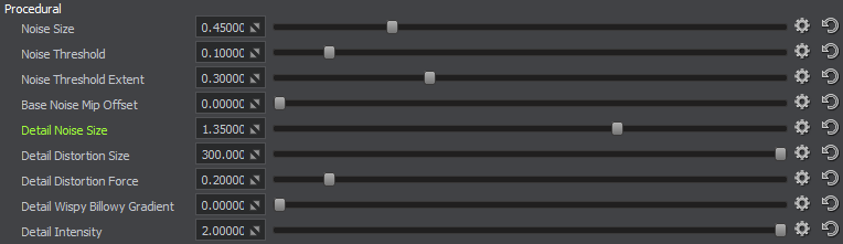

Procedural#
Noise Size | Determines noise graininess. The default value is 0.45. Notice
Higher values reduce performance and may bring up the tiling issue. Recommended range of values is from 0.3 to 1
Noise Threshold | Determines the density threshold of cloud formation. The higher the value the rougher the clouds are. Notice
This parameter should be used only for fine tuning. Significant changes made to this parameter may result in mismatch of cloud shapes and their shadows.
Noise Threshold Extent | This parameter works together with Noise Threshold parameter and adjusts appearance of clouds making it possible to make clouds softer or rougher for a selected noise threshold. Notice
Base Noise Mip Offset | Controls mip levels of the base noise texture in order to reduce blurring at large distances. The recommended range of values is from 0 to 3. Higher values reduce performance. | ||||
Detail Noise Size | Determines the size of details cutout from the clouds. This parameter is analogous to the Noise size parameter. The lower is the value the larger pieces are cutout.
Detail Distortion Size | Determines the scale of clouds detail distortion according to the corresponding texture. This parameter is used to control detail turbulence. The higher is the value the stronger is the detail turbulence effect.
Detail Distortion Force | Determines the intensity of clouds detail distortion. This parameter is used to control detail turbulence. The higher is the value the stronger is the detail turbulence effect.
Detail Wispy Billowy Gradient | Controls the inversion of detail noise. With the default value of 0, the clouds form is as in the detail texture, increasing the value gradually inverts the values from wispy to billowy and from billowy to wispy. | ||||
Detail Intensity | Adjusts detail cutout intensity. Details are cut mostly from the bottom of the clouds. Notice
Thunderclouds are dense and do not have detail cutout. Therefore, they have detail intensity value equal to 0.

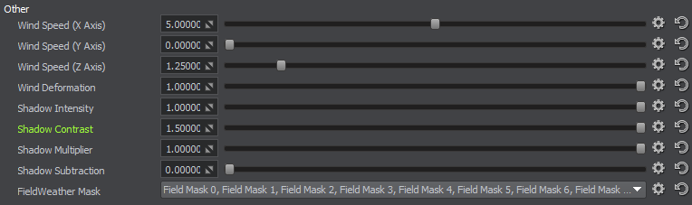

Other#
Wind speed (X axis) | Wind speed along X axis (shifts the coverage texture). | ||||
Wind speed (Y axis) | Wind speed along Y axis (shifts the coverage texture).
Wind speed (Z axis) | Wind speed along Z axis (shifts noise).
Wind Deformation | Control dynamics of moving clouds, i.e. how much clouds change their form as they move. | ||||
Shadow Intensity | Determines the intensity of shadows cast by clouds. This parameter is used for synchronization of visual appearance of clouds with their shadows.
Shadow Contrast | Determines the contrast of shadows cast by clouds.
Shadow Multiplier | Determines darkness of shadows cast by clouds. The lower the value, the darker the shadows are.
Shadow Subtraction | The higher the value, the larger the area under clouds is covered by the shadow. Decreasing the value causes shadows from clouds to be subtracted from the shadow that covers the area under the clouds. The parameter can be set to the maximum value, for example, when the shadow cast by the clouds doesn't fully cover the area beneath, however, clouds look dense enough.
FieldWeather Mask | Bitmask that determines interaction with FieldWeather objects. |
