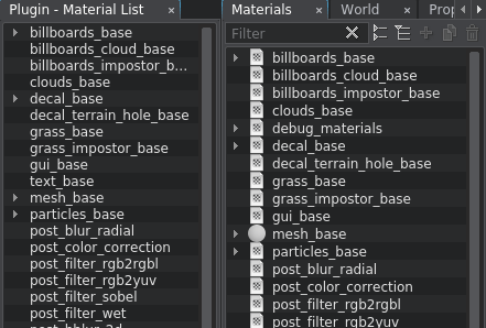

As an example we shall create a simple plugin implementing the basic functionality of the Editor's Materials Hierarchy window (see the picture below).
Materials Plugin
Materials Plugin

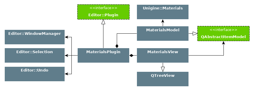

Basically the plugin's architecture looks as follows: Materials Plugin Architecture
Materials Plugin
The MaterialsPlugin class is an initialization point and complete representation of the plugin. It creates necessary data model and via the base interface associates it with the widget, which displays the hierarchy. The model directly interacts with the Materials Manager and transforms information on materials to the required structure.
The plugin interacts will all Editor's external subsystems:
  • Adds a widget to the WindowManager;
  • Adds a new item to the main menu bar;
  • Updates the state of materials widget when the global selection is changed;
  • Updates the global selection when the local selection is changed by sending a SelectionAction to the Undo stack.

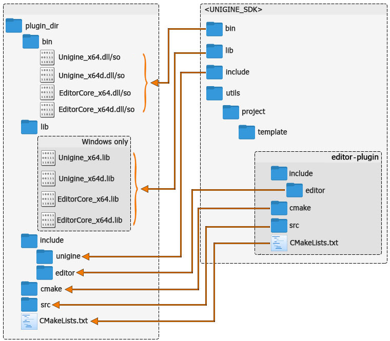

File Structure#
The typical structure of a plugin project should look as follows:
  • project
    • bin - Engine and Editor binaries
      • Unigine_x64.dll/so - Engine library (release).
      • Unigine_x64d.dll/so - Engine library (debug).
      • EditorCore_x64.dll/so - Editor library (release).
      • EditorCore_x64d.dll/so - Editor library (debug).
    • lib - import libraries (Windows only)
      • Unigine_x64.lib - Engine (release).
      • Unigine_x64d.lib - Engine (debug).
      • EditorCore_x64.lib - Editor (release).
      • EditorCore_x64d.lib - Editor (debug).
    • include - public API
      • unigine - Engine's public API.
      • editor - Editor's public API.
    • cmake
    • src - plugin source files
      • Plugin.h
      • Plugin.cpp
      • Plugin.json.in
      • CMakeList.txt
    • CMakeList.txt
The basic components are:
  • Engine and Editor binary files;
  • Engine and Editor public API header files;
  • Plugin source files;
  • Meta-json file;
  • Template CMake-scripts;
Using Plugin Template#
UNIGINE offers you a template to simplify creation of Editor plugins. The template can be found in the following folder: <UNIGINE_SDK>/utils/project/template/editor-plugin
First, we should create a folder for our new Editor plugin project. Then, simply copy all necessary files from the SDK installation directory to this new created folder as shown in the figure below:
If you're creating a project with double precision, the corresponding files to be copied to bin and lib folders must be with the _double suffix.
Copying Files and Folders

Building the Plugin#
In order to build our plugin we also need a couple of files.
We need to create an initial meta data description file (Materials.json.in) to describe our Materials plugin and its dependencies. This file shall be used by CMake to generate the actual plugin .json meta data file.
Materials.json.in
Materials.json.in
Source code
    "Name" : "Materials",
    "Vendor" : "Unigine",
    "Description" : "<p>Provides functionality to overview and manipulate the Engine's materials</p><p>The plugin is used to demonstrate the basic usage of the new `Editor Plugin System` implementation. It contains the main plugin, tree model and tree view instances</p>",
    "Version" : "@PLUGIN_VERSION@",
    "CompatVersion" : "@PLUGIN_COMPAT_VERSION@",
    "Dependencies" : []

Now we can use CMake to build our plugin.
Running the Plugin#
Now as the plugin is built we should copy resulting files to the following folder, so that UnigineEditor's Plugin System could load it automatically:
  • %project%/bin/editor — for Release build;
And finally we launch the UnigineEditor to check our plugin. If everything was done properly, you should see the Materials plugin in the list of loaded plugins (Help -> Plugins).
