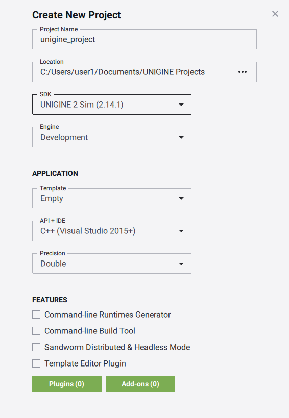

It is very easy to start your own C++ project by using UNIGINE SDK Browser:Начать собственный проект на C ++ с помощью UNIGINE SDK Browser очень просто:

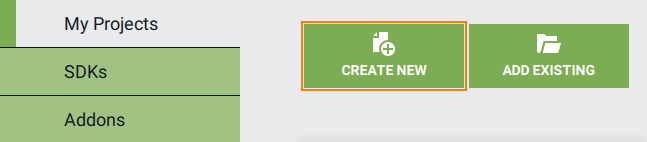

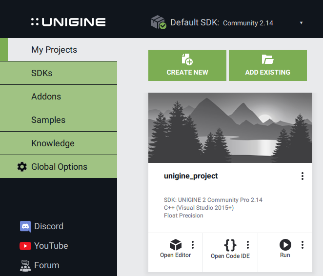

  1. Open the UNIGINE SDK Browser.Откройте браузер UNIGINE SDK.
  2. Go to the Projects tab and click CREATE NEW.
    Перейдите на вкладку Projects и нажмите CREATE NEW.
  3. Specify the following parameters:
    • Project name — specify the name of your project. Project name — specify the name of your project.
    • Location — specify the path to your project folder. Location — specify the path to your project folder.
    • SDK — choose the UNIGINE SDK edition. SDK — choose the UNIGINE SDK edition.
    • API+IDE — choose C++ to start working with the C++ API.
      This parameter depends on a platform:This parameter depends on a platform:
      • On Windows, you can create C++ Visual Studio 2022 project.On Windows, you can create C++ Visual Studio 2022 project.
      • On Linux you can create C++ GNU make project.On Linux you can create C++ GNU make project.
      You can also can create C++ CMake projectYou can also can create C++ CMake project
      This parameter depends on a platform:On Windows, you can create C++ Visual Studio 2022 project.On Linux you can create C++ GNU make project.You can also can create C++ CMake project
    • Precision - specify the precision. In this example we will use double precision.Precision - specify the precision. In this example we will use double precision.
    Read more about these parameters in this article Read more about these parameters in this article
    Project name — specify the name of your project. Location — specify the path to your project folder. SDK — choose the UNIGINE SDK edition. API+IDE — choose C++ to start working with the C++ API.
    This parameter depends on a platform:On Windows, you can create C++ Visual Studio 2022 project.On Linux you can create C++ GNU make project.You can also can create C++ CMake projectPrecision - specify the precision. In this example we will use double precision.Read more about these parameters in this article
    Укажите следующие параметры:
    • Project name — specify the name of your project.Project name - укажите название вашего проекта.
    • Location — specify the path to your project folder.Location - укажите путь к папке вашего проекта.
    • SDK — choose the UNIGINE SDK edition.SDK - выберите редакцию UNIGINE SDK.
      API+IDE - выберите C ++ , чтобы начать работу с C ++ API.
      This parameter depends on a platform:Этот параметр зависит от платформы:
      • On Windows, you can create C++ Visual Studio 2022 project.В Windows вы можете создать проект C++ Visual Studio 2022.
      • On Linux you can create C++ GNU make project.В Linux вы можете создать проект C++ GNU make.
      You can also can create C++ CMake projectВы также можете создать проект C ++ CMake
    • Precision - specify the precision. In this example we will use double precision.Precision - указать точность. В этом примере мы будем использовать двойную точность .
    Read more about these parameters in this article Подробнее об этих параметрах читайте в этой статье .
  4. Click the CREATE NEW PROJECT button. The project will appear in the projects list.
    Щелкните кнопку CREATE NEW PROJECT. Проект появится в списке проектов.

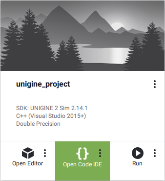

  1. If you created the C++ project for Visual Studio:Если вы создали проект C ++ для Visual Studio :
    1. Choose your C++ project in the UNIGINE SDK Browser and click the Open Code IDE button to open the project in IDE.
      Выберите свой проект C ++ в браузере UNIGINE SDK и нажмите кнопку Open Code IDE, чтобы открыть проект в IDE.

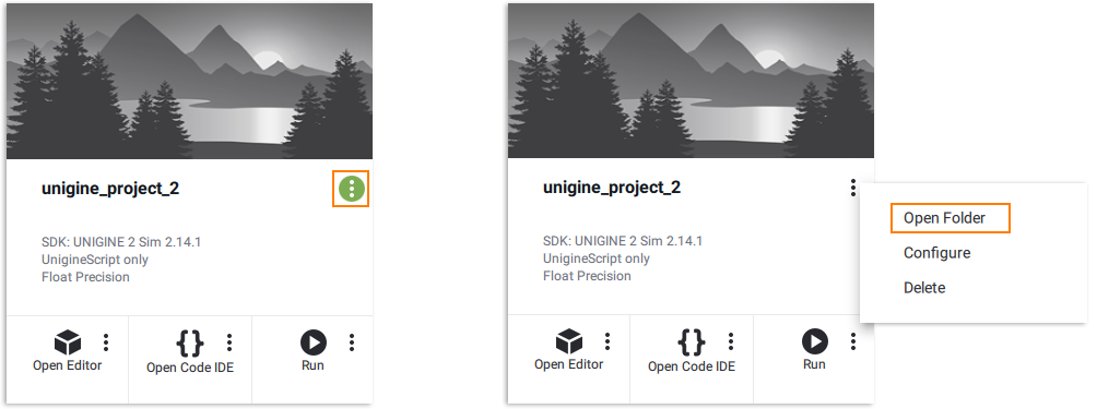

    If you created C++ GNU make project:Если вы создали C++ GNU make project:
    1. On the created C++ project, click on the Other Actions button and then the Open Folder button.
      В созданном проекте C ++ нажмите кнопку Other Actions, а затем кнопку Open Folder.

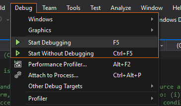

  3. If you use Visual Studio, do the following: Если вы используете Visual Studio, сделайте следующее:

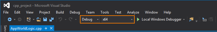

    1. Before compiling your code, check that the appropriate platform and configuration settings for your project are set correctly.
      Перед компиляцией кода убедитесь, что для вашего проекта установлены правильные параметры платформы и конфигурации.

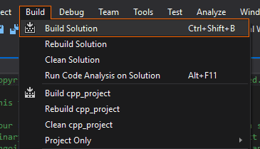

    2. Build your project by clicking Build -> Build Solution in Visual Studio.
      Создайте свой проект, щелкнув Build -> Build Solution в Visual Studio.
    3. Start your project by clicking Debug -> Start in a proper mode in Visual Studio.
      Начните свой проект, щелкнув Debug -> Start в соответствующем режиме в Visual Studio.
