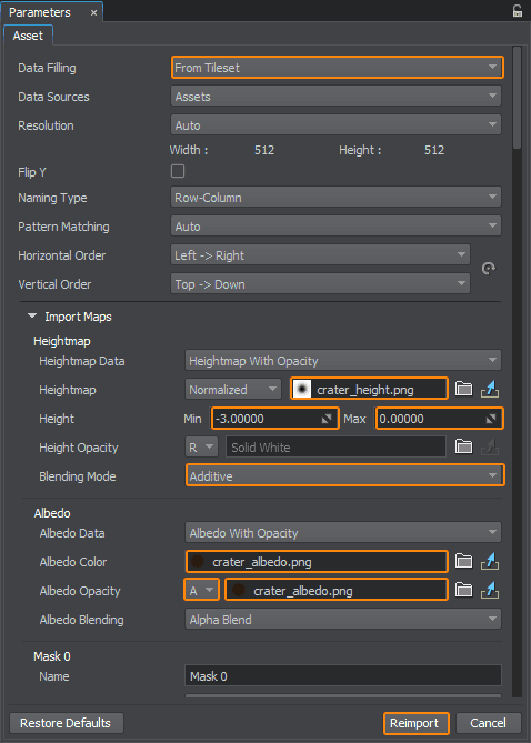

  4. Drag the height.png file directly to the Asset Browser window to add it to your project. In the Import Dialog for your height map, set Image Format to R32F and click Yes.height.png文件直接拖到Asset Browser窗口将它添加到您的项目。对你的高度图导入对话框中,设置Image Format R32F并单击Yes
  5. Drag the albedo.png file directly to the Asset Browser window too. In the Import Dialog for your height map, set Texture Preset to Albedo (RGB — color, A — opacity) and click Yes.albedo.png文件直接拖到Asset Browser窗口。在你的高度地图的导入对话框中,设置Texture PresetAlbedo (RGB — color, A — opacity),然后单击Yes

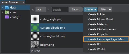

  2. Switch to UnigineEditor and Drag the crater_height.png file directly to the Asset Browser window to add it to your project (just like you did before for the terrain's Height map). In the Import Dialog for your height map, set Image Format to R32F and click Yes.切换到UnigineEditor并将crater_height.png文件直接拖到Asset Browser窗口,将其添加到您的项目中(就像您之前为地形的高度地图所做的那样)。在你的高度地图的导入对话框中,设置Image FormatR32F,然后单击Yes
  3. Drag the crater_albedo.png file directly to the Asset Browser window (just like you did before for the terrain's Albedo map). In the Import Dialog for your albedo map set Texture Preset to Albedo (RGB — color, A — opacity) and click Yes.crater_albedo.png 文件直接拖到 Asset Browser 窗口(就像您之前为 地形的 Albedo 地图)。 在反照率贴图的导入对话框中,将 Texture Preset 设置为 Albedo (RGB — 颜色,A — 不透明度),然后单击 Yes
  4. Select Create -> Create Landscape Layer Map in the Asset Browser.Asset Browser中选择Create -> Create Landscape Layer Map
  5. Enter a name for the layer map: crater.输入层地图的名称:crater
  6. Select your new crater.lmap asset and adjust its settings as shown below (assign our images, select blending mode and adjust heights range for the crater).选择你的新的crater.lmap资源,并调整其设置如下所示(分配我们的图像,选择混合模式和调整火山口的高度范围)。
  7. Click Reimport and process to the Code section below.单击Reimport并处理到下面的 Code部分。
