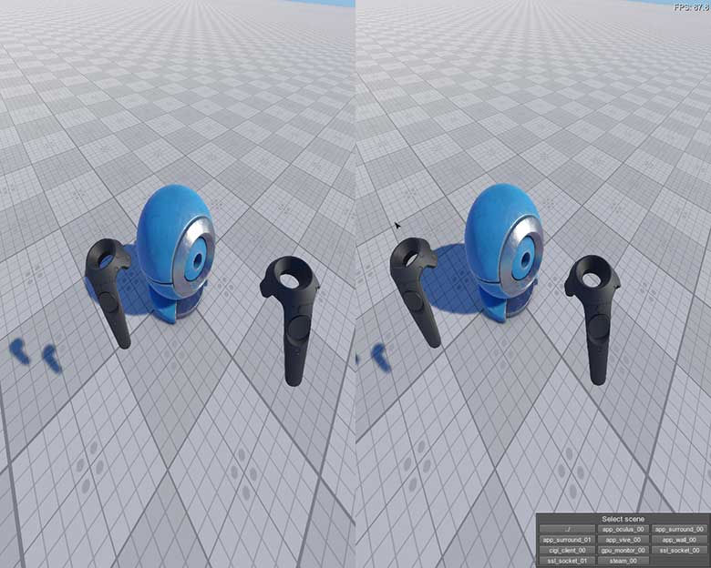

Both the windowed and the full screen modes are supported. By default, on the PC display the image is rendered in mono mode (image from the left eye). Use setViewportMode() to change the mode to stereo (both eyes) as follows:

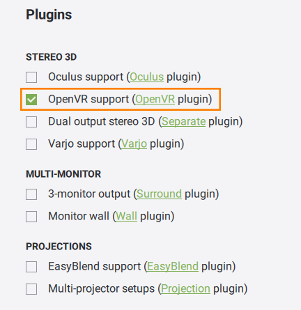

  2. Create a new project with OpenVR support via UNIGINE SDK Browser: click Plugins, check the OpenVR support (OpenVR plugin) option in the form that opens and click OK.
    To add OpenVR support to an existing project, in UNIGINE SDK Browser, click Other Actions -> Configure Project -> Plugins -> OpenVR support (OpenVR plugin) -> Ok.

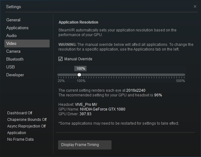

    Please note that by default SteamVR selects resolution based on your computer's performance. Therefore, for best image quality it is recommended to open the Video tab of the SteamVR settings window, enable Manual Override mode and set resolution to 100%.
    So the resolution will be set as follows:
    HTC Vive HTC Vive Pro
    Resolution per eye 1512 x 1680 2016 x 2240
    The same resolution is set for both eyes.
