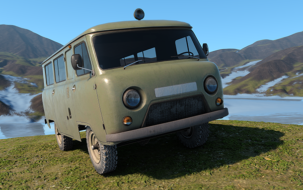

High-Level Vehicle Demo
High-Level Vehicle demo project showcases a new High-Level Car Physics System. To learn more on using the system to create your own wheeled vehicle simulation please refer to this article.
