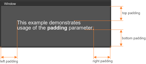

  • padding
    Top, bottom, left and right padding (pixels). The padding serves to set the distance between the border of the widget and its content.
    left, right, top and bottom padding
    The code example is:
    Source code (XML)
    <window name="Test::window" width="250" height="250" export="1" padding="50">
    	<text>Window</text>
    	<font size="20">
    		<label>
    			<text rich="1">This example demonstrates<br/>
    				usage of the <font face="core/gui/fontb.ttf">padding</font> parameter.<br/>
    			</text>
    		</label>
    	</font>
    </window>

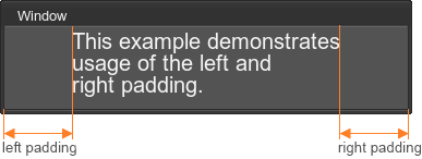

  • padding_lr
    Left and right padding (pixels).
    Source code (XML)
    <window name="Test::window" width="250" height="250" export="1" padding_lr="50">
    	<text>Window</text>
    	<font size="20">
    		<label>
    				usage of the left and<br/>
    				right padding.<br/>
    			</text>
    		</label>
    	</font>
    </window>

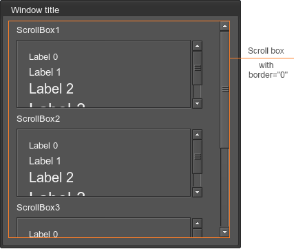

It is also possible to enable or disable the border line of the scroll box. It is useful, for example, if you want to add several scroll boxes with the borders into another scroll box, which has no borders:
Source code (XML)
<scrollbox name="Test::scrollbox" export="0" space="8" border="0" width="200" height="300" align="expand">
	<align align="left">
		<label><text>ScrollBox1</text></label>
		<scrollbox name="Test::scrollbox_1" export="0" space="8" border="1" width="250" height="80">
			<vbox name="Test::vbox_1" export="0" space="8">
				<label><text size="15">Label 1</text></label>
				<label><text size="20">Label 2</text></label>
				<label><text size="25">Label 3</text></label>
			</vbox>
		</scrollbox>
		<label><text>ScrollBox2</text></label>
		<scrollbox name="Test::scrollbox_2" export="0" space="8" border="1" width="250" height="80">
			<vbox name="Test::vbox_2" export="0" space="8">
			</vbox>
		</scrollbox>
		<label><text>ScrollBox3</text></label>
		<scrollbox name="Test::scrollbox_3" export="0" space="8" border="1" width="250" height="80">
			<vbox name="Test::vbox_3" export="0" space="8">
			</vbox>
		<scrollbox>
	</align>
</scrollbox>
The scroll box appears as follows:
