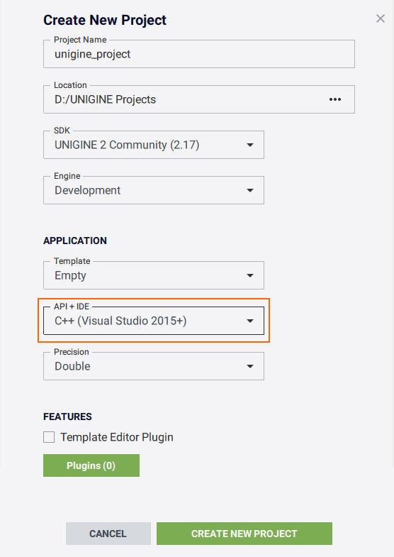

1. Prepare a Project#
Before we can start creating components and implementing our game logic, we should create a new C++ project.
