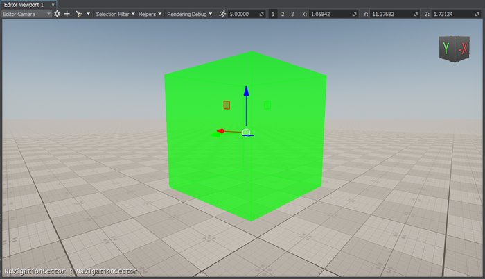

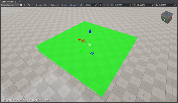

  3. In the Menu bar, choose Create -> Navigation -> Navigation Sector and place the node above the plane.
    To facilitate working with the navigation sectors, activate gizmos for Navigation nodes in the Helpers Panel.
  4. Adjust the Size of the sector in the Parameters window.

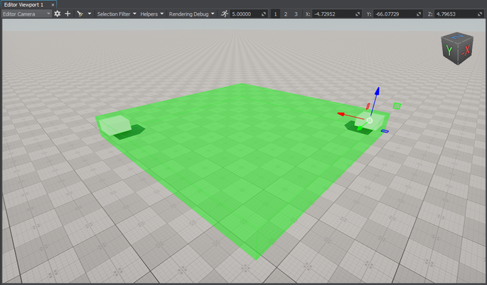

  5. Add 2 nodes that will be used as the start and destination points of the route. We will create 2 boxes (Create -> Primitives -> Box), rename them start and finish, and place inside the navigation sector as pictured below.

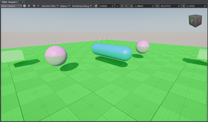

  6. Create several primitives and place them inside the navigation area. We will add a capsule and two boxes.

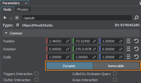

  7. Make them dynamic: switch from Immovable to Dynamic in the Parameters window.

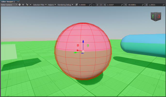

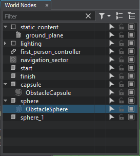

  8. For each primitive, create an obstacle of the required type: in the World Hierarchy window, right-click the primitive, choose Create -> Navigation, and select the obstacle. The created obstacle will be added as a child to the primitive node in the hierarchy.
    It will allow you to change the node and obstacle transformations at the same time without any extra configuration.
  9. Adjust the size of the created obstacles in the Parameters window if necessary.

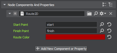

Assigning Component#
When the component logic is implemented and the property is generated, you should assign it to a node.
  1. In UnigineEditor, select Create -> Node -> Dummy and place it in the navigation area.
  2. Select the dummy node and assign the Route2D property to it in the Parameters window.
  3. In the component parameters, specify the start and finish static meshes in the Start Point and Finish Point fields.
  4. Change the Route Color, if necessary.

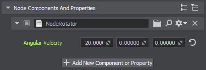

  4. Assign the component to the capsule primitive that should rotate and specify the Angular Velocity:
    The obstacle will rotate as well.

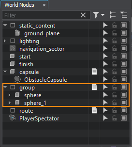

  5. Group the sphere primitives and assign the component to the parent dummy node. It will make the spheres rotate around this parent node (as in the case of a sphere, rotation around its own axis won't affect the route calculation).

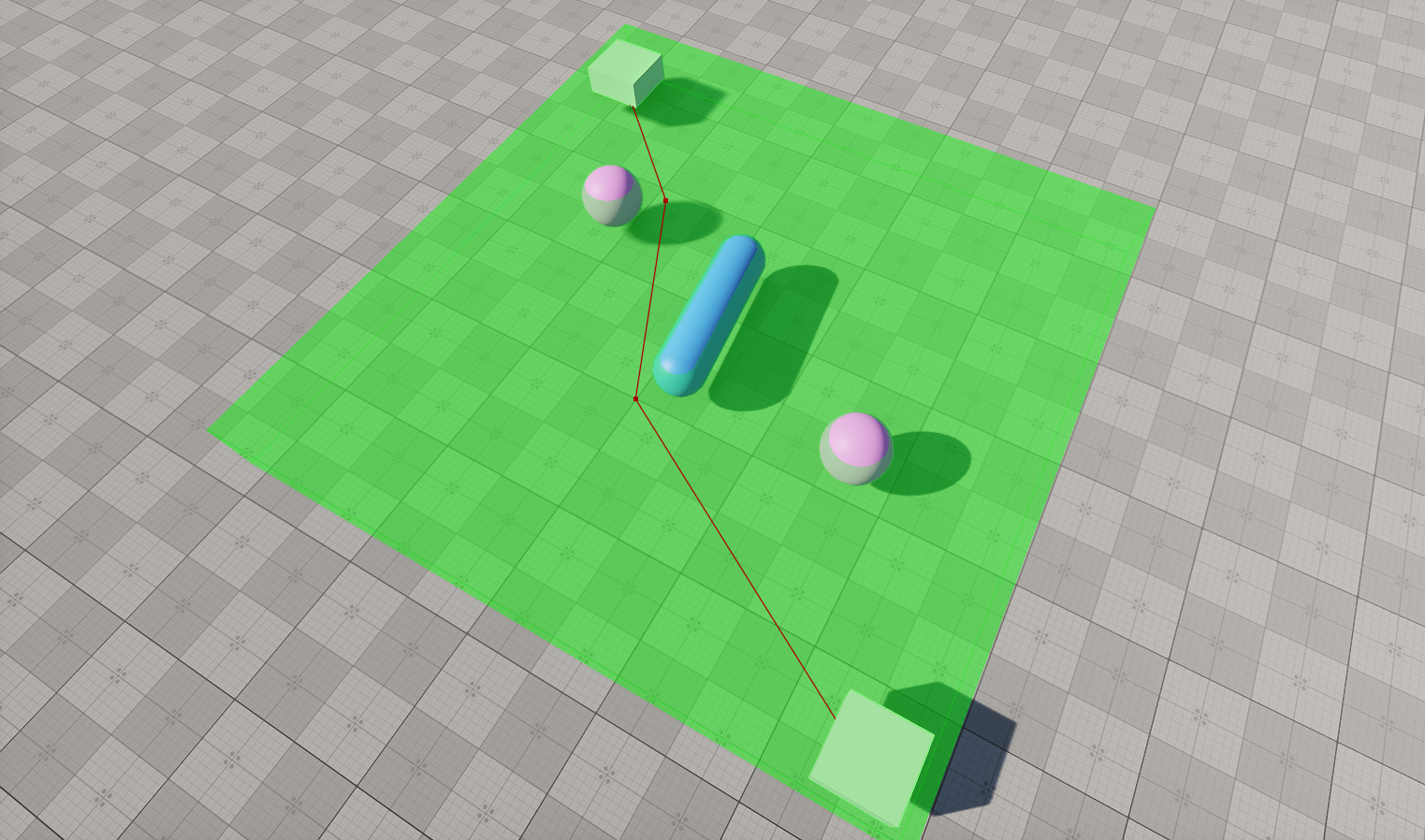

Trying Out#
Launch the application to check the result.
