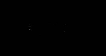

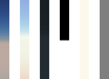

Common Pass#
The Common pass is the very first step of the rendering sequence. In this pass, environment LUTs and the Environment cubemap are rendered. These textures are rendered only once before all the geometry in the scene and will be used further for the final screen composition: for scattering rendering and non-dynamic reflections.
Environment cubemap is composed of six pieces (256x256 px each). |
LUT textures are represented as 1x256 px textures taken from the current state of the loaded LUT textures for scattering. |

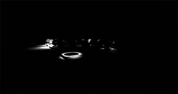

World Light#

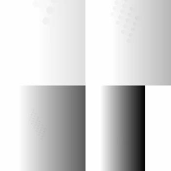

For the world lights, the engine creates cascaded shadow maps. World Light's shadow map is rendered into the orthographic projection.
The shadow map of the world light source is rendered into texture divided into four parts (since the 4 is the maximum quantity of shadow cascades).
Shadow map of the Light World source |
Shadows near the camera have higher resolutions, while shadows that are far away from the camera have fewer details.
Rectangular shadow cascades on the final scene |

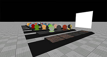

During this step of rendering, the engine fills the Gbuffer (Geometry buffer) for shading.

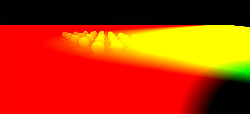

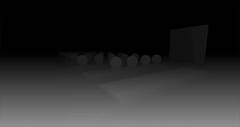

Depth#
The depth buffer contains scene objects in the current field of view (found between the near and far clipping planes). Objects are rendered as pure geometric models and stored into this buffer.
The engine also uses native depth.
The depth data stored in a depth buffer texture format D32F |

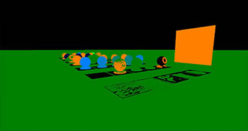

Albedo#
The albedo colors buffer stores pure albedo colors of all material textures:
The texture format is RGBA8 (RT0):

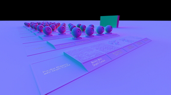

Normal#
The normal buffer stores normal vectors for each vertex of geometry which are required for calculation of the proper lighting.
The texture format is RGBA8 (RT2):

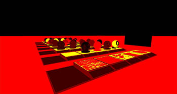

Velocity#
The velocity buffer stores information about the displacement of pixels per frame. When the image is still, the buffer is filled with zero (black) values. These values are necessary to make the temporal anti-aliasing (TAA) and motion blur work correctly.
The texture format is RG16F (RT3):
You can disable the buffer, if you don't need velocity-related effects: motion blur, TAA, etc.

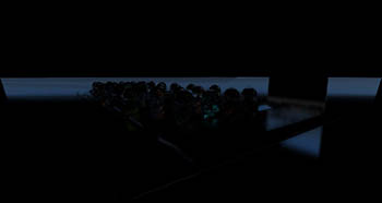

Lightmap#
The lightmap buffer is used to add baked light to the scene.
The texture format is RG11B10F (RT5):

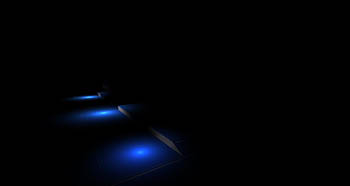

Light sources diffuse layer |
Light sources specular layer |
The engine uses tile rendering technique for Light Omni sources without shadows. With this optimization, Light Omni sources are grouped and rendered in batches, decreasing the number of DIP calls and, therefore, improving the performance.

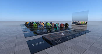

Reflection Pass#
In the reflection pass, planar dynamic reflections (that have already been rendered) are applied. Dynamic reflections are rendered in the same texture that was used for Deferred Reflections.
Planar dynamic reflection is applied |

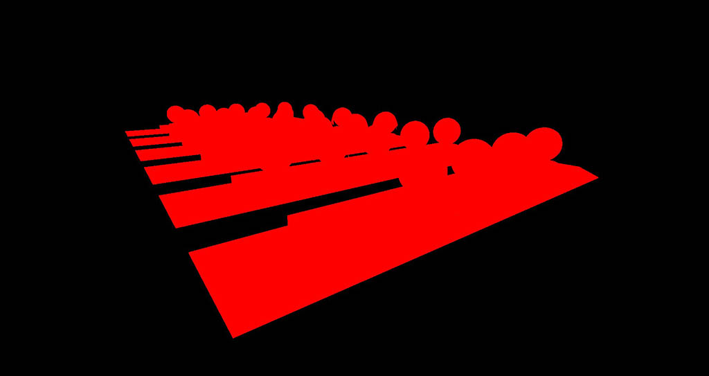

SSAO#
Screen-Space Ambient Occlusion is rendered in its own R8 texture. It is applied in the deferred composite stage.
SSAO can be rendered with or without noise. This option has influence on TAA:
- If noise is enabled and SSAO is rendered in full resolution, there is no TAA during this stage.
- If noise is enabled and SSAO is rendered in half resolution, this stage has its own TAA.

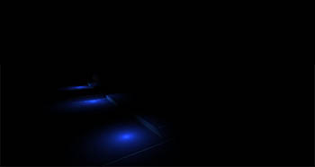

SSGI#
Screen-Space Global Illumination is rendered in one RG11B10F texture.
SSGI stage also has its own TAA.

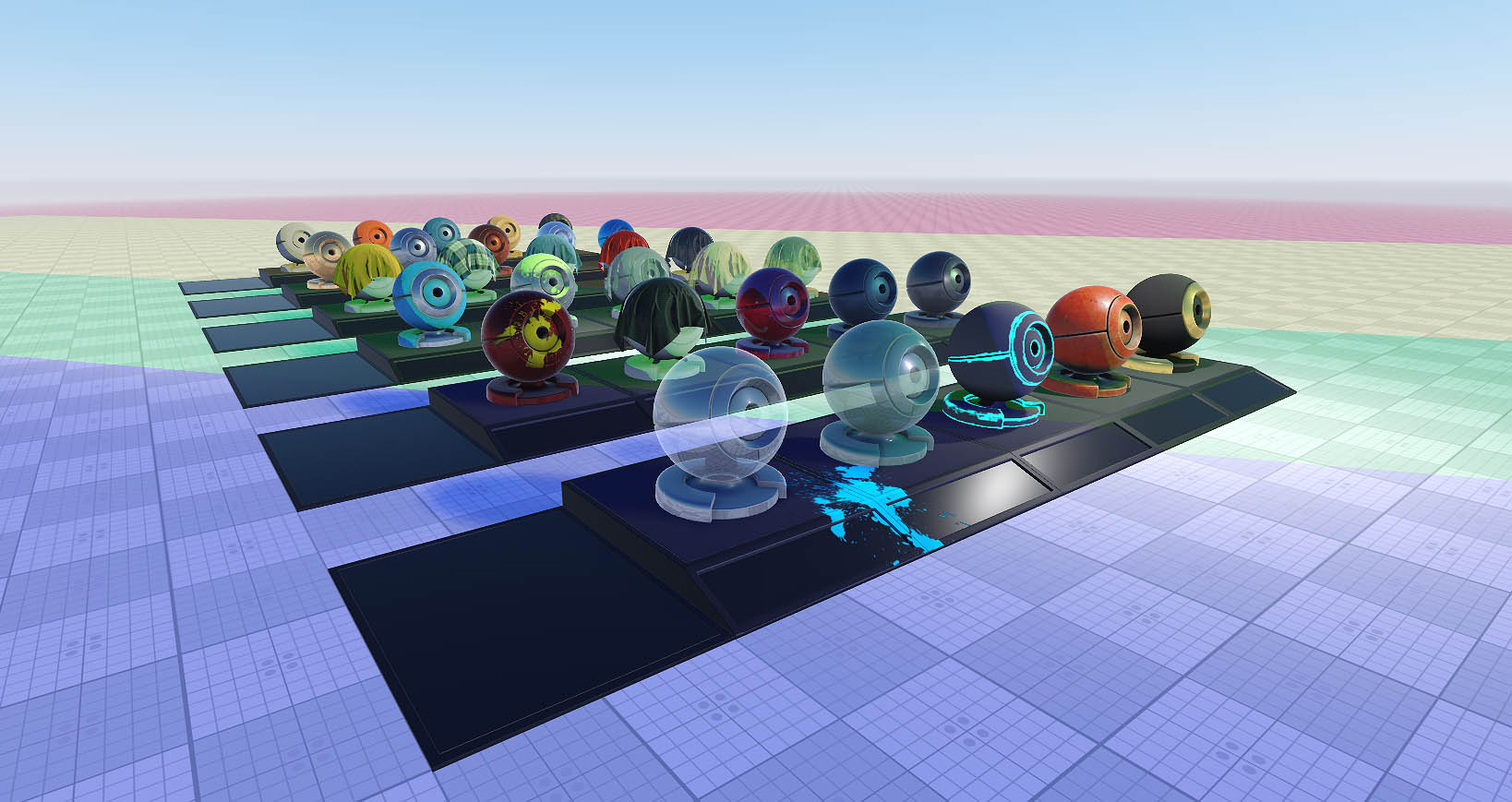

Deferred Composite#
During this stage, the engine uses all necessary textures from the previous stages and passes to create the final texture with opaque geometry. The engine combines buffers and calculates shading for the final texture of this pass.
During this stage, the renderer calculates the light of one world light and applies it. Environment reflections, ambient, and haze (scattering) are also rendered here.
The final image of the deferred pass for opaque geometry (excluding the Emission pass and SSS) |

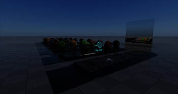

Emission#
The emission pass follows creation of the deferred composite image and applies the emission effect over this image.
Emission applied |

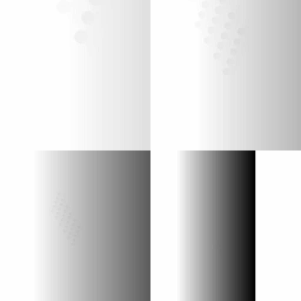

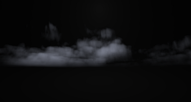

Example of the Clouds texture content |
Due to optimization, Volumetric Clouds are rendered in a certain order depending on the following conditions:
- Before Water and Transparent Objects — if the value of the render_clouds_transparent_order console command is set to 0, and the current camera is below the water highest point or under the surface.
- Between Water and Transparent Objects — if the value of the render_clouds_transparent_order console command is set to 0 and the current camera is above the water highest point.
- After Water and Transparent Objects — if the value of the render_clouds_transparent_order console command is set to 1.

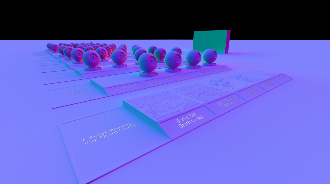

Normal#
The Normal texture stores normals for lighting, and alpha channel stores mesh transparency values (it can be used for soft intersections with water geometry).
The texture format is RGBA8:

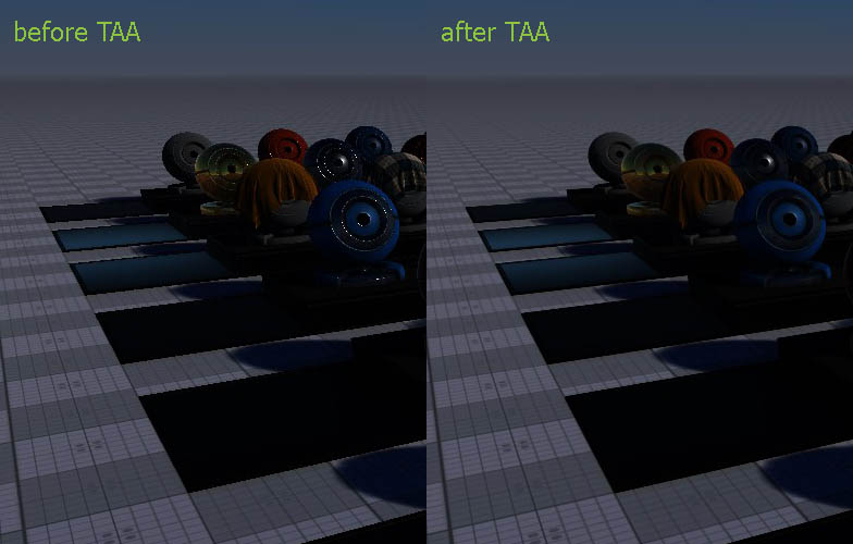

Temporal Anti-Aliasing (TAA)#
This pass is used when TAA is enabled. Otherwise, the engine skips this pass and goes to the next one.
After the TAA |
TAA uses previous frames to improve the current frame by using linear interpolation.

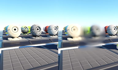

Transparent Blur#
During this stage, blurriness behind transparent objects is applied. The renderer uses the texture from the Transparent Blur Surfaces stage.
The frame with the Transparent Blurriness applied |

Final Screen Composition#
During this stage, the engine assembles the final texture by using all textures that were rendered during the previous steps. Filmic tone mapping, dithering, and the LUT texture are applied here during the final screen composition.
Final screen composition |
