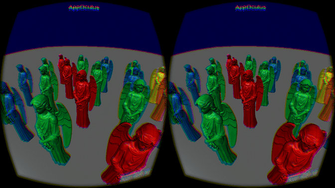

This article describes the <UnigineSDK>/data/samples/plugins/app_oculus_00.cpp sample.
The app_oculus_00 sample demonstrates how to get access to the functions of the Oculus plugin and then set the world scale (via engine.oculus.setPositionScale()). Also the example shows how to recenter the sensor orientation when the r key is pressed.
