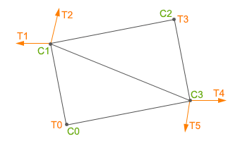

On the picture below, arrows are used to show normals:
Surface that contains 2 adjacent triangles. Here C0...C3 are coordinate vertices, T0...T5 are triangle vertices
The coordinate buffer is an array of coordinate vertices. In order to reduce data duplication, vertices of surface which have the same coordinates are saved only once in the buffer. For example, the coordinate buffer for the surface presented on the picture above is the following:
Output
CB = [C0,C1,C2,C3]
Each polygon of the surface has 3 coordinates. We have 2 polygons, thus, we have 6 vertices, but we save in the CVertices buffer only 4, because 2 of them have the same coordinates. Each coordinate vertex contains coordinates (float[3]) of the vertex.
The number of vertices and coordinate vertices is the same.
The triangle buffer is an array of triangle vertices. For example, the triangle buffer for the surface presented on the picture above is the following:
Output
TB = [T0,T1,T2,T3,T4,T5]

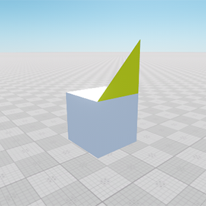

Adding a Surface to the Existing Mesh#
In the following example, we add a surface to the existing mesh and then add necessary vertices and indices for the surface:
  1. Create a new mesh instance from the file.
  2. Add a new surface to the mesh.
  3. Add vertices for the mesh surface.
  4. Create indices for recently created vertices by using the createIndices() function.
  5. Update bounds of the mesh to include the created surface by using the createBounds() function.
  6. Change the surface color.
AppWorldLogic.cpp
AppWorldLogic.cpp
#include "AppWorldLogic.h"
#include <UnigineObjects.h>
AppWorldLogic::AppWorldLogic()
AppWorldLogic::~AppWorldLogic()
int AppWorldLogic::init()
	// load a mesh from the file
	MeshPtr source_mesh = Mesh::create("core/meshes/box.mesh");
	// add a new surface
	source_mesh->addSurface("surface_triangle");
	// add 3 vertices to the new surface
	source_mesh->addVertex(vec3(-0.5f, 0.5f, 0.5f), 1);
	source_mesh->addVertex(vec3(-0.5f, -0.5f, 0.5f), 1);
	source_mesh->addVertex(vec3(-0.5f, -0.5f, 1.5f), 1);
	// create indices for the new surface
	source_mesh->createIndices(1);
	// create a new boundbox for the mesh including new surface
	source_mesh->createBounds();
	// create an ObjectMeshStatic, switch it to procedural mode and set its mesh via the source_mesh instance
	ObjectMeshStaticPtr staticMesh = ObjectMeshStatic::create();
	staticMesh->setMeshProceduralMode(true);
	staticMesh->applyMeshProcedural(source_mesh);
	staticMesh->setMaterialParameterFloat4("albedo_color", vec4(255, 255, 0, 255), 1);
The triangle surface added to the mesh:

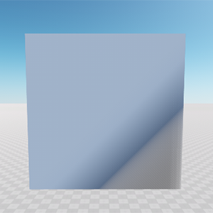

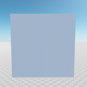

When setTangent() and setNormal() functions were called, the normal and the tangent changed their values.
Let's comment this part of the code:
AppWorldLogic.cpp
AppWorldLogic.cpp
// get the tangent value
quat tangent = mesh->getTangent(0, 0, 0);
// show the tangent value in the console
Log::message("tangent: %0.1f %0.1f %0.1f %0.1f\n",tangent.x, tangent.y, tangent.z, tangent.w);
// set a new value of the tangent
mesh->setTangent(0, quat(vec3(1.0f, 0.0f, 0.0f), 20), 0, 0);
// get the new tangent value
quat new_tangent = mesh->getTangent(0, 0, 0);
// show the tangent value after changing
Log::message("tangent: %0.1f %0.1f %0.1f %0.1f\n",new_tangent.x, new_tangent.y, new_tangent.z, new_tangent.w);
The result will be different. You can see what influence the tangent has on the vertex:
Plane with changed tangent
Plane with unchanged tangent
