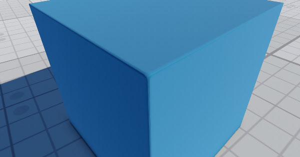

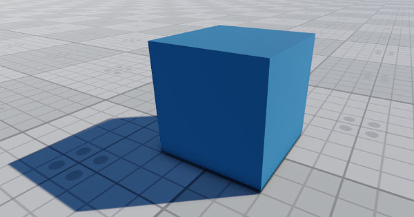

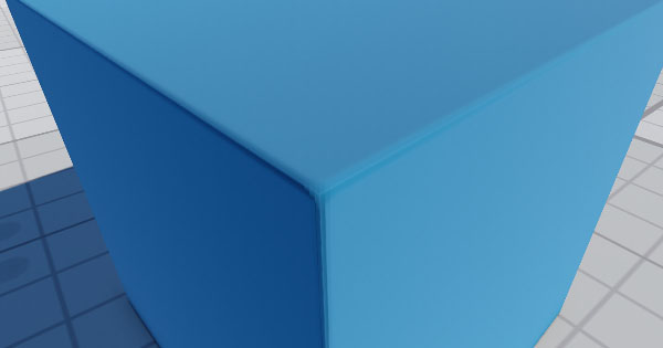

The section contains settings that control screen-space bevels. Using bevels allows you to create smoothed edges of geometry and gives a realistic look to objects in the scene. 本节包含控制屏幕空间斜角的设置。使用斜角可以创建几何的平滑边缘,并为场景中的对象赋予逼真的外观。

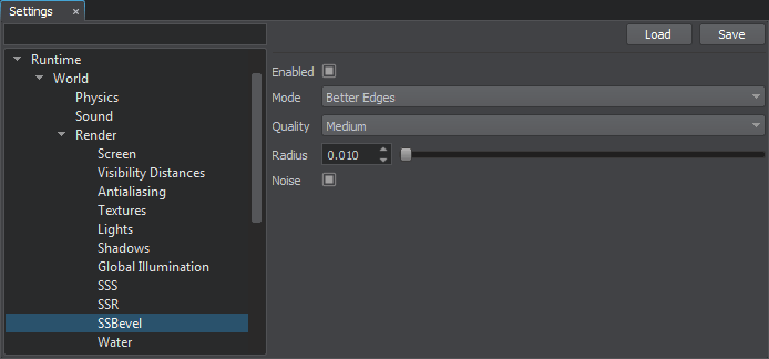

Screen-Space Bevel Settings屏幕空间斜角设置
Settings are applied to materials with the SSBevel state enabled.设置应用于启用了 SSBevel 状态的材质。
Enabled | 切换斜角的打开和关闭。 |
Mode | 设置屏幕空间斜角渲染的模式。可用值:
Quality | 屏幕空间斜角的质量:
Radius | 屏幕空间斜角效果的大小。 |
Noise | 切换允许平滑斜角打开和关闭的噪声。建议在启用TAA的情况下使用噪声,以避免出现视觉伪影。斜角杂讯会在距相机一定距离处应用(即,如果相机离带有斜面的物体太远,则不会应用杂讯)。 |

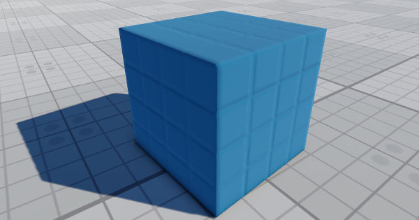

Screen-space bevels are set up per material. The settings described above allow you to set up bevels for all materials with the SSBevel option enabled. However, you can also set up bevels for each material individually via the Parameters window with material settings. 每种材质都设置了屏幕空间斜角。通过上述设置,您可以在启用了SSBevel选项的情况下为所有材质设置斜角。但是,您还可以使用Parameters window with material settings.
