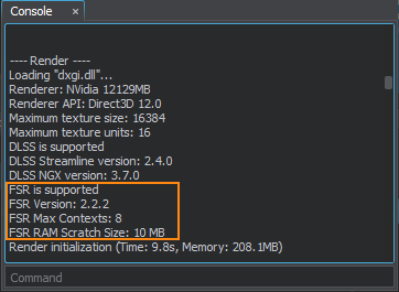

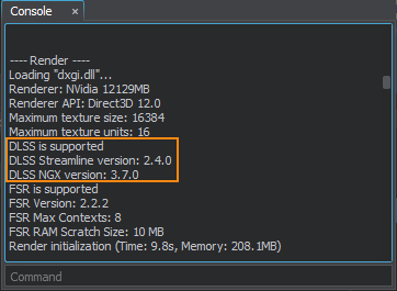

The upscalers are initialized on render initialization. To verify whether they are supported and initialized after application startup, you can do one of the following:升频器在渲染初始化时初始化。 要验证它们是否受支持并在应用程序启动后初始化,可以执行以下操作之一:
  • Check the Render section of the console output.检查控制台输出的Render部分。
  • Run the dlss_info and/or fsr_info console commands.运行dlss_info和/或fsr_info控制台命令。
For example, the Render section may provide the following information:例如,Render部分可以提供以下信息:
源代码
---- Render ----
DLSS is supported
DLSS Streamline version: 2.4.0
DLSS NGX version: 3.7.0
FSR is supported
FSR Version: 2.2.2
FSR Max Contexts: 8
FSR RAM Scratch Size: 10 MB
If the upscaler is not supported, a corresponding message will be displayed in the console.如果不支持upscaler,则控制台中将显示相应的消息。

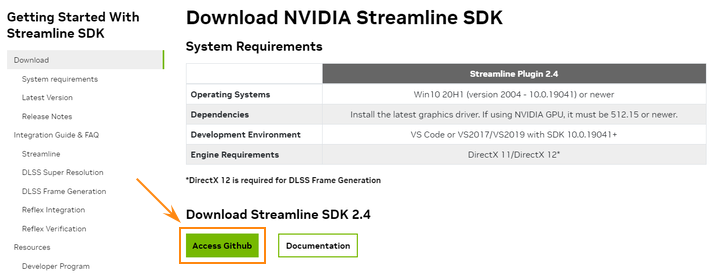

  1. Follow this link to download the NVIDIA Streamline SDK, which serves as a wrapper for DLSS and all its features.按照此链接下载NVIDIA Streamline SDK,它用作包装器 适用于 DLSS 及其所有功能。

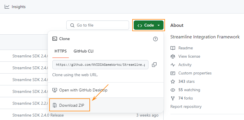

  2. Click Access Github.点击Access Github
  3. On the page that opens, click the green Code button and select Download ZIP from the drop-down list.在打开的页面上,单击绿色的Code按钮,然后从下拉列表中选择Download ZIP

  9. In UnigineEditor, open the console and check that DLSS is available. The corresponding information is provided in the Render section:在UnigineEditor中,打开控制台并检查DLSS是否可用。 相应的信息在Render部分提供:
    If DLSS is not available, the corresponding message will be shown in the console.如果DLSS是不可用,相应的消息将显示在控制台中。

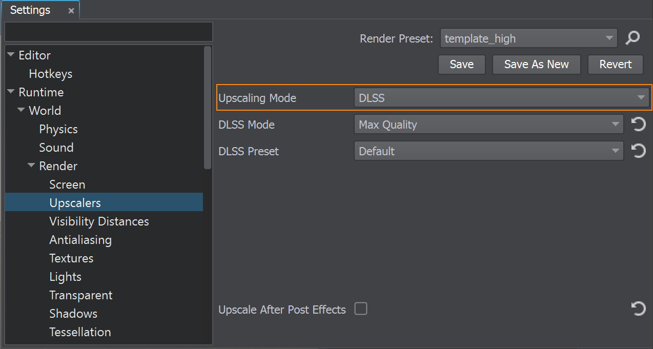

To use DLSS for the scene, enable it in one of the following ways and specify settings:要在场景中使用DLSS,请通过以下方式之一启用它并指定设置:

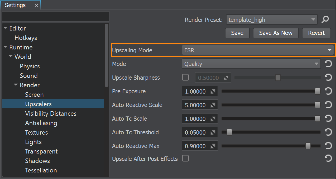

Settings of Upscalers
升频器的设置#
Depending on the current upscale mode, the set of settings differs. Please refer to the Upscalers article.根据当前的高档模式,设置集不同。 请参阅Upscalers文章。

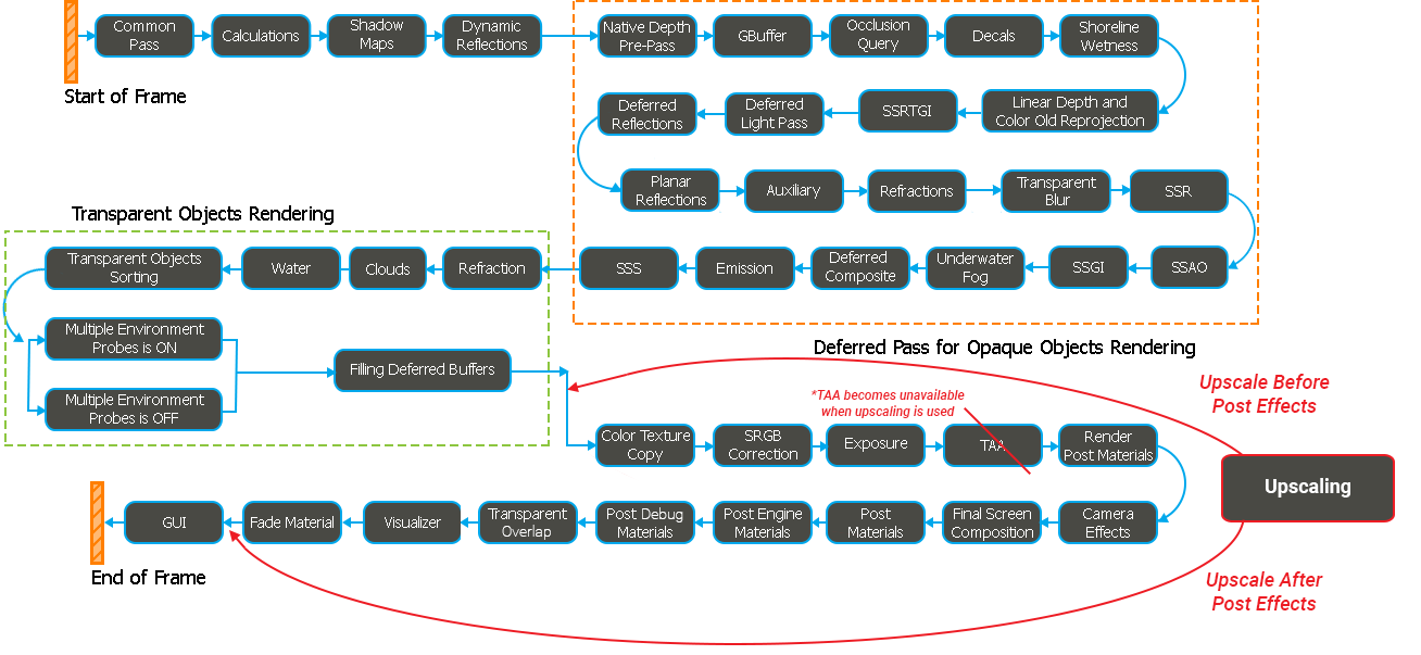

By default, upscaling is applied before all post-processing effects are rendered. However, you can choose to apply upscaling after rendering the post-process effects.默认情况下,在渲染所有后处理效果之前应用放大。 但是,您可以选择渲染后处理效果之后应用放大。
It can be done via the console using the render_upscale_post command or in UnigineEditor by toggling the Upscale After Post Effects parameter.它可以通过控制台使用render_upscale_post命令或在UnigineEditor中通过切换Upscale After Post Effects参数来完成。
