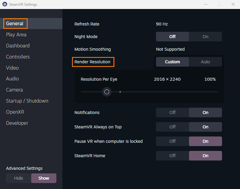

  3. Open SteamVR Settings and make sure that no scaling is applied to resolution:打开SteamVR设置,确保分辨率未进行任何缩放调整:
    Settings -> General -> Render Resolution -> Resolution Per Eye = 100%

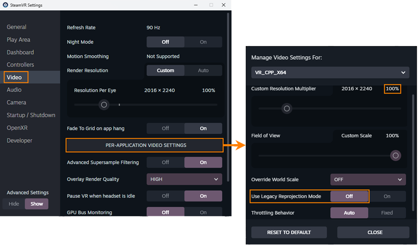

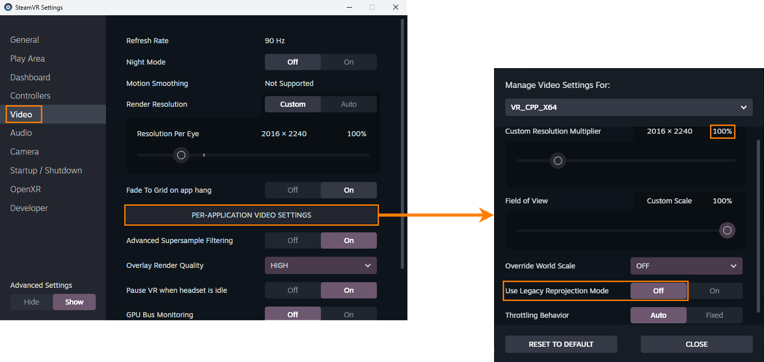

  5. Open the application settings in SteamVR and make sure that no scaling is applied to resolution and Legacy Reprojection is disabled:在SteamVR中打开该应用程序的设置,确保分辨率未进行缩放调整,并且Legacy Reprojection被禁用:
    Settings -> Video -> PER-APPLICATION VIDEO SETTINGS

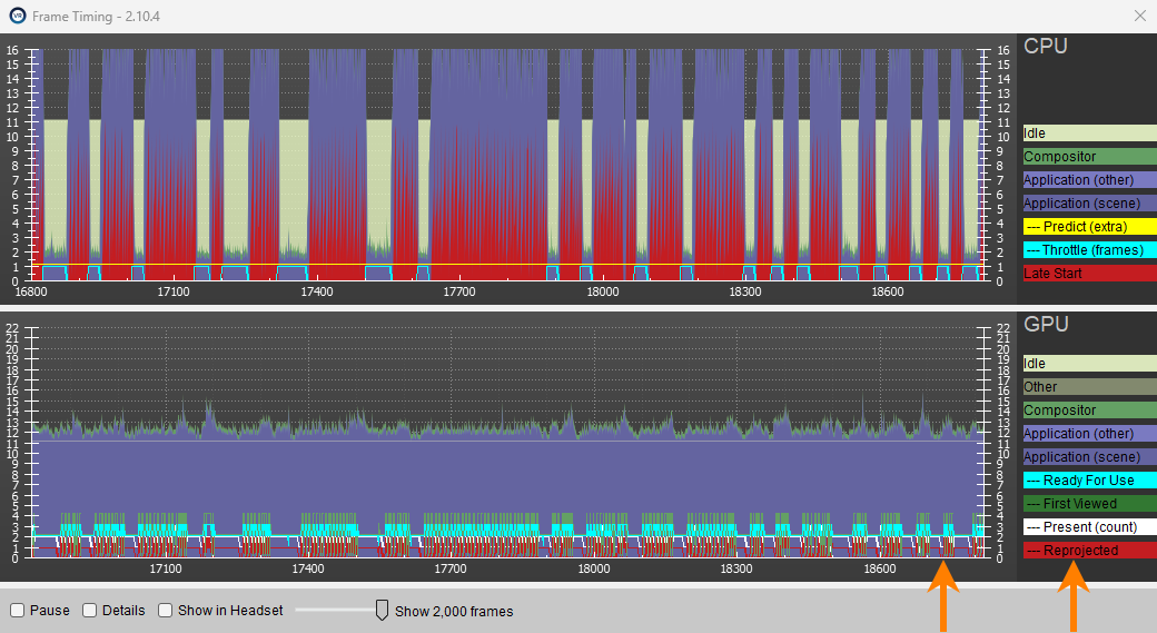

You can verify that reprojection is active by using SteamVR's built-in frame timing tools: Settings -> Developer -> Advanced Frame Timing. A graph overlay will appear showing frame timings.您可以通过SteamVR内置的帧计时工具验证重投影是否激活:Settings -> Developer -> Advanced Frame Timing。此时将显示帧计时图表叠加层。
Look at the GPU graph (bottom part): if you see red spikes or a red line, that indicates reprojection is active:观察GPU图表(底部区域):若出现红色尖峰或红线,表示重投影正在工作::

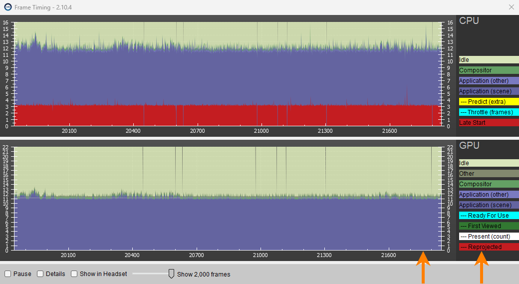

No red indicators mean that reprojection is not working:若无红色标记,则表示重投影未工作::
