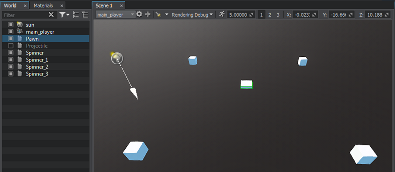

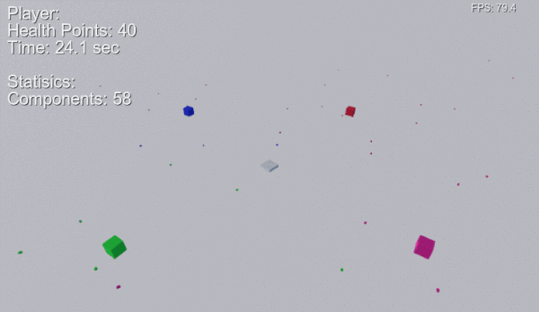

Let's make a simple game to demonstrate how the whole system works.
Game Description#
In the center of the play area, we are going to have an object (Pawn) controlled by the player via the keyboard. It has certain amount of HP and movement parameters (movement and rotation speed).
Four corners of the play area are occupied by rotating objects (Spinner) that throw other small objects (Projectile) in all directions while rotating.
Each Projectile moves along a straight line in the directon it has been initially thrown by Spinner. If a Projectile hits Pawn, Pawn takes damage according to the value set for the hitting Projectile (each of them has a random speed and damage value). Pawn is destroyed if the amount of HP drops below zero.
We use boxes for simplicity, but you can easily replace them with any other objects.

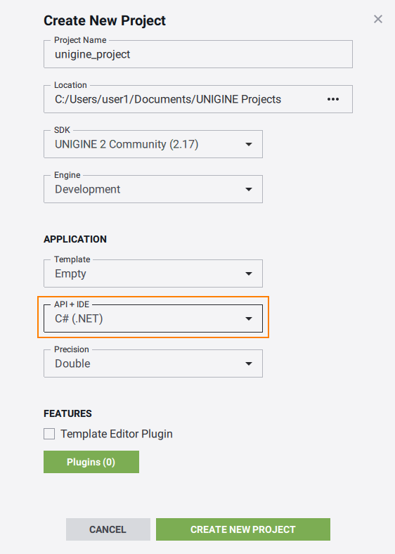

Before we can start creating components and implementing our game logic, we should create a project.
  1. Open the SDK Browser and create a new C# project. To do this, select C# (.NET) in the API + IDE list of the Application section.
  2. Run the Editor by clicking Open Editor.
  3. Prepare the world: delete or disable unnecessary objects, such as static_content, dynamic_content, etc.

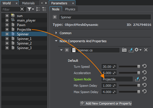

  • Spinner with the following parameters:
    • rotation speed — how fast Spinner rotates
    • acceleration — how fast Spinner's rotation rate increases
    • node to be used as Projectile
    • minimum spawn delay
    • maximum spawn delay
    We are going to initialize Spinner and do something with it each frame. Therefore, this logic will go to the Init() and Update().

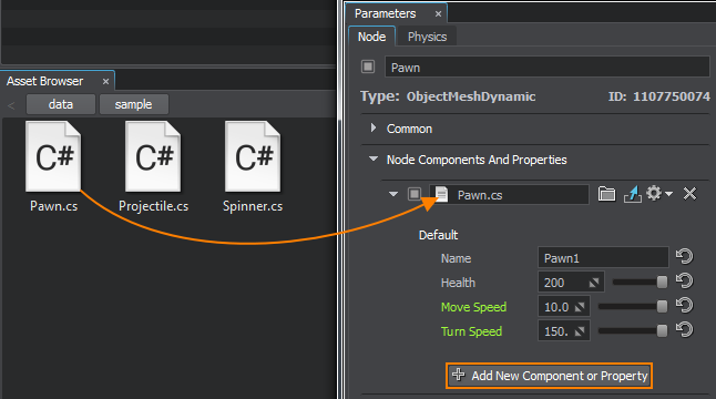

For each of our objects, we should describe logic in a separate C# component. Therefore, we should do the following:
  • Create a C# component for each game entity.
  • Open the source code in the default IDE by double clicking any *.cs asset.
  • Declare all parameters defined above with their default values (if any).
  • Declare which methods we are going to use to implement our logic, and during which stages of the execution sequence to call them.

Creating a Scene via Editor#
  1. Create a World light source to illuminate the whole scene.
  2. Add a new camera to the world and adjust its position. This will be our default camera, so check on its Main Player flag.
  3. Create a Box primitive to represent Pawn. Assign the Pawn component by clicking Add New Component or Property and dragging the asset to the corresponding field. You can also drag the component from the Asset Browser to the node in the Editor Viewport. Adjust the parameters of the player.
  4. Create another smaller box — a template for projectiles. We can disable it since its clones will be used.
  5. Create the required number of objects for Spinners at the same height as Pawn, assign the corresponding component to them and adjust the parameters. Specify the spawn node by dragging the Projectile node to the field.
    On this step the scene looks as follows:

Select a desired play preset on the toolbar and click the Play button to run an instance of the application.
