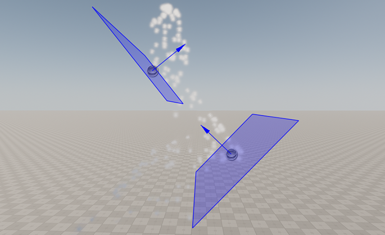

This class represents a deflector for particles generated by Particle Systems. Deflector is a surface field that has no visual representation, but physically interacts with particle systems (other objects are not affected) blocking the way for particles and making them bounce off the deflector's surface. Depending on the specified size, it can be either rectangular or square, plus it can be arbitrarily positioned or rotated to cover the necessary area.
Deflectors are one-sided, meaning the particles can freely penetrate them through one side, and interact only with the opposite one, for example, when falling on it from above.
