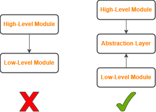

Classes depend on an abstraction (an interface or abstract class) rather than a concrete implementation. This approach adheres to the Dependency Inversion Principle (DIP), which states that high-level modules should not depend on low-level modules; both should depend on abstractions. Moreover, abstractions themselves should not depend on details – the details should depend on the abstraction.类依赖于抽象(接口或抽象类)而不是具体的实现。这种方法遵循依赖倒置原则(DIP),即高层模块不应依赖于低层模块,两者都应依赖于抽象。此外,抽象本身不应依赖于细节,而细节应依赖于抽象。
By following DIP, you reduce direct coupling and make it easier to replace components without affecting higher-level logic.通过遵循DIP,可以减少直接耦合,并更容易在不影响高层逻辑的情况下替换组件。
抽象示意图

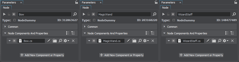

  2. Implement the Interface in a Component.在组件中实现接口
    Create one or more components that implement this interface. They will contain the actual code to perform the work, but from the outside they will be accessed via the interface. You can have multiple implementations of the same interface coexisting, which is a powerful way to swap behaviors. The component that implements the interface is called a service.创建一个或多个实现该接口的组件。这些组件将包含实际执行工作的代码,但从外部访问时将通过接口进行。您可以同时拥有同一接口的多个实现,这是一种强大的行为交换方式。实现接口的组件称为服务。
    源代码 (C#)
    public class WizardStaff : Component, IShootable
    	public void Shoot()
    		Log.MessageLine("The wizard's staff shot a fireball.");
    public class MagicWand : Component, IShootable
    	public void Shoot()
    		Log.MessageLine("The magic wand shot an electric zap.");
    public class Bow : Component, IShootable
    	public void Shoot()
    		Log.MessageLine("The bow shot an arrow.");
    带组件的节点

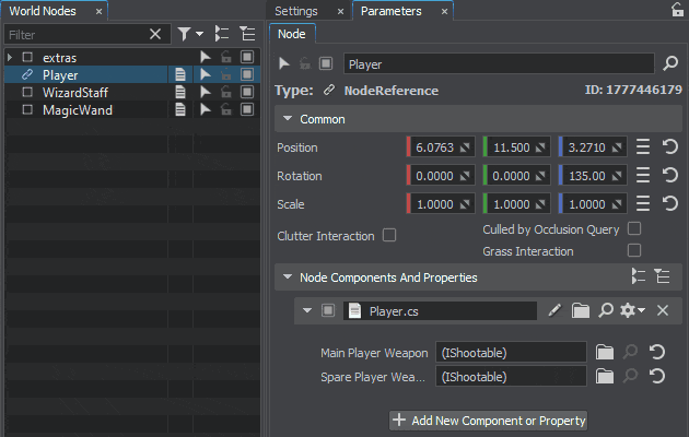

    • Via the Editor. In UNIGINE you can expose the interface field in the component parameters. By default, parameters are displayed or hidden in the UI in accordance with access modifiers: public - displayed, otherwise - hidden. But you can show a private or protected one by specifying the corresponding visibility attribute ShowInEditor as shown above in the code sample.通过编辑器:在UNIGINE中,您可以在组件参数中公开接口字段。默认情况下,参数根据访问修饰符在UI中显示或隐藏:public显示,其他隐藏。但可以通过添加ShowInEditor属性强制显示私有或受保护字段。
      Then, you simply assign a node with an assigned component that implements your specific interface.然后只需附加一个挂载了实现该接口的组件的节点。
      Using interfaces in 通过编辑器使用接口

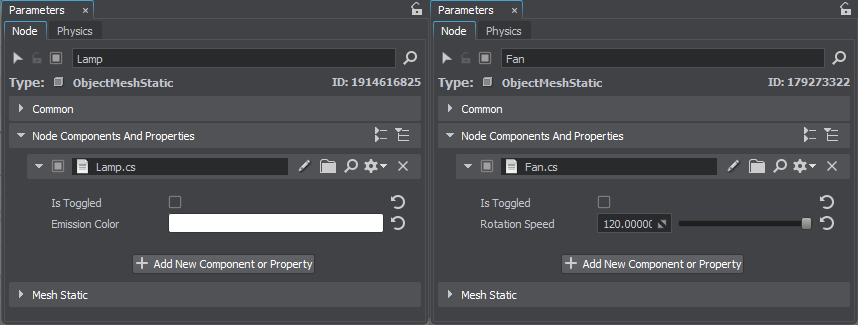

  2. Create Subclasses that Inherit from the Abstract Class.创建继承自抽象类的子类
    Implement one or more classes that extend the abstract base class. Each subclass must implement the abstract methods, providing its own behavior.实现一个或多个扩展抽象基类的子类。每个子类必须实现抽象方法并提供自己的行为逻辑。
    源代码 (C#)
    using System.Collections;
    using Unigine;
    [Component(PropertyGuid = "AUTOGENERATED_GUID")]
    public class Lamp : Toggleable
    	[ParameterColor]
    	public vec4 emission_color = vec4.WHITE;
    	protected override bool On()
    		Log.MessageLine("Lamp::On()");
    		return SetEmissionColor(emission_color);
    	protected override bool Off()
    		Log.MessageLine("Lamp::Off()");
    		return SetEmissionColor(vec4.ZERO);
    	private bool SetEmissionColor(vec4 emission_color)
    		Object obj = (Object)node;
    		if (obj == null)
    			return false;
    		for (var surface = 0; surface < obj.NumSurfaces; surface += 1)
    			obj.SetMaterialParameterFloat4("emission_color", emission_color, surface);
    		return true;
    	private void Init()
    		SetEmissionColor(Toggled ? emission_color : vec4.ZERO);
    源代码 (C#)
    using Unigine;
    public class Fan : Toggleable
    	public float rotation_speed = 120;
    	private float target_speed = 0;
    	private float actual_speed = 0;
    		Log.MessageLine("Fan::On()");
    		target_speed = rotation_speed;
    		return true;
    		Log.MessageLine("Fan::Off()");
    		target_speed = 0;
    		return true;
    	private void Init()
    		target_speed = Toggled ? rotation_speed : 0;
    	private void Update()
    		actual_speed = MathLib.Lerp(actual_speed, target_speed, Game.IFps);
    		node.Rotate(0, 0, actual_speed * Game.IFps);
    带有抽象组件的节点

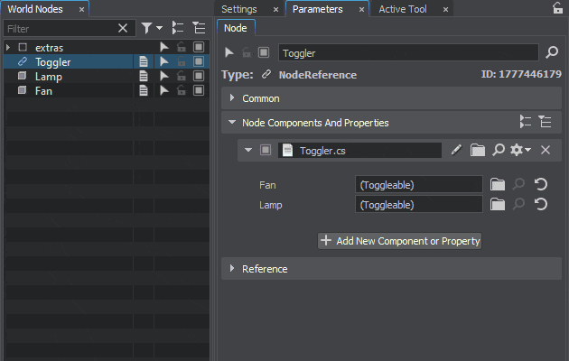

    • Via the Editor. Simply assign a node with the assigned component, that inherits your abstract base class in a node Parameters window:通过编辑器:只需附加一个带有附加组件的节点,该组件在节点参数窗口中继承您的抽象基类。
      在编辑器中使用抽象类
    • Via the API. Retrieving abstract base classes via the API works in a similar way as interfaces.通过API:检索抽象基类的方式与接口类似。
