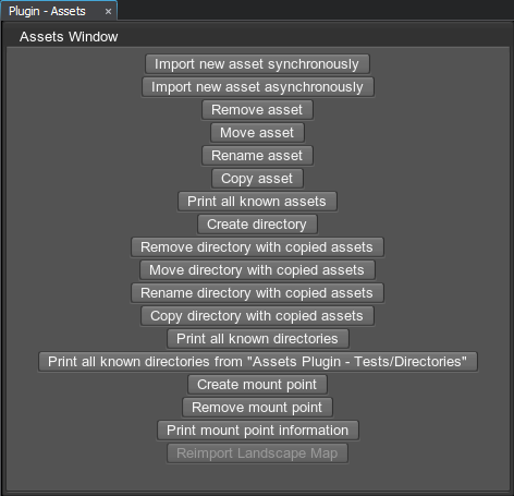

Assets Plugin
Assets PluginAssets插件
Implemented Functions 实现功能
This plugin template implements the basic functionality of the Asset Manager. The plugin interacts with the Asset Manager system and adds a widget to Window Manager. AssetsPlugin allows you to:这个插件模板实现Asset Manager的基本功能。插件与Asset Manager交互系统和部件Window Manager补充道。AssetsPlugin允许你:
Import New Assets Synchronously
同步导入新资源#
The type of operation is used when imported asset(s) is critically important for the current execution of the application. The importing process is executed in the main thread of the application. It represents a blocking system call and the function will not return until the operation is complete.当导入的资源对应用程序的当前执行非常重要时,使用操作的类型。导入过程在应用程序的主线程中执行。它表示一个阻塞系统调用,该函数在操作完成之前不会返回。
This operation is implemented in the plugin as import_new_asset_synchronously() function.这个操作是在插件实现import_new_asset_synchronously()函数。
AssetsPlugin.cpp
源代码 (C++)

Print Paths and GUIDs of All Known Assets
打印所有已知的资源的路径和guid#
Printing out the list of paths and GUIDs for all assets in the root project directory (including all subdirectories). This can be used to iterate over the assets in your project providing information on assets location.打印出所有资源的路径和guid列表在项目根目录(包括所有子目录)。这可以用来遍历资源项目中提供的信息的位置。
This operation is implemented in the plugin as print_all_known_assets() function.该操作在插件中作为print_all_known_assets()函数实现。

Create a New Directory
创建一个新目录#
New directory creation, used to manage files within the project.创建新目录,用于管理项目中的文件。
This operation is implemented in the plugin as create_directory() function.该操作在插件中作为create_directory()函数实现。

Create a Mount Point
创建挂载点#
This operation can be used to add a link to an external folder, shared storage or package (e.g. a library of 3D models, VFX, etc.) to the project.此操作可用于添加一个链接到一个外部文件夹,共享存储或包(例如一个3 d模型库、视效、等等)的项目。
The parameters of the mount point are managed via an instance of the MountPointParameters class - first, we should create an instance and specify necessary settings (path, access mode, etc.) and then tell the AssetManager to create a mount point via the createMountPoint() method. A corresponding .umount file is created in the project's data folder. This is a file in the JSON format that represents the root mount point.挂载点的参数是通过MountPointParameters类的一个实例来管理的——首先,我们应该创建一个实例并指定必要的设置(路径、访问模式等),然后通过createMountPoint()方法告诉AssetManager创建一个挂载点。在项目的data文件夹中创建了一个相应的.umount文件。这是一个JSON格式的文件,表示根挂载点。
This operation is implemented in the plugin as create_mount_point() function.这个操作是在插件实现create_mount_point()函数。

AssetsPlugin.cpp
源代码 (C++)
// Method removing a mount point
void AssetsPlugin::remove_mount_point()
	// checking if the specified mount point exists
	if (!AssetManager::isMountPoint(DIRECTORY_FOR_MOUNT_POINT))
		error_notification(
			String::format("Mount point doesn't exist \"%s\"", DIRECTORY_FOR_MOUNT_POINT));
		return;
	// trying to remove the specified mount point via the AssetManager, displaying a notification depending on the result
	if (AssetManager::removeMountPoint(DIRECTORY_FOR_MOUNT_POINT))
		success_notification(String::format("Mount point has been removed successfully: \"%s\"",
	else
		error_notification(
			String::format("Can't remove mount point: \"%s\"", DIRECTORY_FOR_MOUNT_POINT));
Print Mount Point Information
挂载点打印信息#
This operation can be used to obtain information about a mount point (virtual path, absolute path, access, filters). The parameters of the mount point are managed via an instance of the MountPointParameters class - first, we call the getMountPointParameters() method to fill this instance with necessary data and then use the instance to print information. This is a sample code demonstrating the use of public API.这个操作可以用来获取信息挂载点(虚拟路径,绝对路径、访问过滤器)。挂载点的参数管理通过MountPointParameters类的一个实例——首先,我们称之为getMountPointParameters()方法来填补这一实例提供必要的数据,然后使用实例打印信息。这是一个示例代码展示公共API的使用。

This opreation reimports the selected Landscape Map asset after changing its import parameters. Can be used to reimport an asset existing in the project with a new set of import parameters.该操作在更改所选的Landscape Map资源的导入参数后重新导入它。可用于使用一组新的导入参数重新导入项目中现有的资源。
This operation is implemented in the plugin as reimport_selected_landscape_map() function. This function uses the auxiliary function find_selected_lmap_file() which iterates over the current selection and finds the path to the .lmap asset to be reimported.这个操作是在插件实现reimport_selected_landscape_map()函数。这个函数使用了辅助函数find_selected_lmap_file()遍历当前选择和发现的路径.lmap湾区(资源。
AssetsPlugin.cpp
源代码 (C++)

// function to be executed on changing selection in the Editor
void AssetsPlugin::selection_changed()
	// trying to get an .lmap-file in the current selection
	const String &lmap_path = find_selected_lmap_file();
	// updating the button text and status depending on the result
	const char BUTTON_LMAP_REIMPORT_NAME[] = "Reimport Landscape Map";
	const StringStack<> &button_name = String::format("%s%s%s", BUTTON_LMAP_REIMPORT_NAME,
		lmap_path.empty() ? "" : " - ", lmap_path.get());
	button_lmap_reimporting_->setText(button_name);
	button_lmap_reimporting_->setEnabled(lmap_path.size() > 0);

void AssetsPlugin::build_gui()
	gui_ = window_->getGui();
	WidgetWindowPtr main_window = WidgetWindow::create(gui_, "Assets Window");
	gui_->addChild(main_window, Gui::ALIGN_OVERLAP);
	constexpr int DEFAULT_WIDTH = 800;
	constexpr int DEFAULT_HEIGHT = 400;
	main_window->setWidth(DEFAULT_WIDTH);
	main_window->setHeight(DEFAULT_HEIGHT);
	main_window->setSizeable(true);
	add_buttons(main_window);
	label_notification_ = WidgetLabel::create(gui_);
	main_window->addChild(label_notification_, Gui::ALIGN_EXPAND);
// Auxiliary method adding button elements to the GUI of the Assets Plugin
void AssetsPlugin::add_buttons(const WidgetWindowPtr &main_window)
	auto create_button = [&main_window, this](const char *name, void (AssetsPlugin::*p)()) {
		WidgetButtonPtr button = WidgetButton::create(gui_, name);
		button->getEventClicked().connect(this, p);
		main_window->addChild(button);
		return button;
	// assets
	create_button("Import new asset synchronously", &AssetsPlugin::import_new_asset_synchronously);
	create_button("Import new asset asynchronously",
		&AssetsPlugin::import_new_asset_asynchronously);
	create_button("Remove asset", &AssetsPlugin::remove_asset_asynchronously);
	create_button("Move asset", &AssetsPlugin::move_asset_asynchronously);
	create_button("Rename asset", &AssetsPlugin::rename_asset_asynchronously);
	create_button("Copy asset", &AssetsPlugin::copy_asset_asynchronously);
	create_button("Print all known assets", &AssetsPlugin::print_all_known_assets);
	create_button("Create directory", &AssetsPlugin::create_directory);
	create_button("Remove directory with copied assets",
		&AssetsPlugin::remove_directory_with_copied_assets_asynchronously);
	create_button("Move directory with copied assets",
		&AssetsPlugin::move_directory_with_copied_assets_asynchronously);
	create_button("Rename directory with copied assets",
		&AssetsPlugin::rename_directory_with_copied_assets_asynchronously);
	create_button("Copy directory with copied assets",
		&AssetsPlugin::copy_directory_with_copied_assets_asynchronously);
	create_button("Print all known directories", &AssetsPlugin::print_all_known_directories);
	StringStack<> button_name = String::format("Print all known directories from \"%s\"",
		DIRECTORY_FOR_NEW_DIRECTORIES);
	create_button(button_name, &AssetsPlugin::print_directories_from_test_directory);
	create_button("Create mount point", &AssetsPlugin::create_mount_point);
	create_button("Remove mount point", &AssetsPlugin::remove_mount_point);
	create_button("Print mount point information", &AssetsPlugin::print_mount_point_information);
	button_lmap_reimporting_ = create_button("", &AssetsPlugin::reimport_selected_landscape_map);

	// processing
	AM::getEventProcessBegin().connect(connections_, this, &AssetsPlugin::process_begin);
	AM::getEventProcessEnd().connect(connections_, this, &AssetsPlugin::process_end);
// Auxiliary method setting up an event handler for tracking selection changes in the UnigineEditor
void AssetsPlugin::make_connection_to_selection()
	Selection *selection = Selection::instance();
	connection_selection_ = connect(selection, &Selection::changed, this,
		&AssetsPlugin::selection_changed);
// Auxiliary methods removing event subscriptions
void AssetsPlugin::destroy_connection_from_selection()
	disconnect(connection_selection_);
void AssetsPlugin::destroy_connections_from_asset_manager()
	connections_.disconnectAll();
// Method importing a new asset and waiting for the process to complete (blocking the thread)
void AssetsPlugin::import_new_asset_synchronously()
	// calling an auxiliary function to create a new asset and import it, displaying information on imported asset on success, or an error notification
	String result = create_and_import_new_asset_synchronously();
	if (!result.empty())
			String::format("Asset has imported successfully: \"%s\"", result.get()));
		// set current Editor selection to the imported asset and print information about it
		select_asset(result);
		print_asset_information(result);
	else
		error_notification(String::format("Can't import asset: \"%s\"", result.get()));
// Method importing an asset in the background (non-blocking, returns immediately without waiting for operation completion)
void AssetsPlugin::import_new_asset_asynchronously()
	// making a base target path for the asset and generating a unique virtual path for it
	const StringStack<> &base_asset_path = String::joinPaths(DIRECTORY_FOR_NEW_ASSETS,
		String::basename(TEXTURE_PATH));
	const String &new_texture_path = AssetManager::generateUniquePath(base_asset_path);
	if (!create_asset(TEXTURE_PATH, new_texture_path))
		return;
	// launching the importing process in the background (asynchronously, without blocking the main thread) and displaying a notification, if it has started successfully
	// to catch completion of the operation set a handler via AssetManager::getEventProcessEnd.connect() method (see method "process_end()" here)
	if (AssetManager::importAssetAsync(new_texture_path))
		success_notification(String::format("Asset import process has started successfully: \"%s\"",
			new_texture_path.get()));
	else
		error_notification(
			String::format("Can't start asset import process: \"%s\"", new_texture_path.get()));
// Method removing an asset in the background (non-blocking, returns immediately without waiting for operation completion)
void AssetsPlugin::remove_asset_asynchronously()
	// checking whether there are any assets in the source directory to remove (if not, report and return)
	const Vector<String> &asset_paths = AssetManager::getAssetPathsForDirectory(
		DIRECTORY_FOR_NEW_ASSETS);
	if (asset_paths.empty())
		error_notification(String::format("There are no assets to remove: \"%s\"\n",
			DIRECTORY_FOR_NEW_ASSETS));
		return;
	// launching the asset removal process in the background (asynchronously, without blocking the main thread) and displaying a notification, if it has started successfully
	const String &asset_path_to_remove = asset_paths.last();
	if (AssetManager::removeAssetAsync(asset_path_to_remove))
		success_notification(String::format("Asset removal process has started successfully: \"%s\"",
			asset_path_to_remove.get()));
	else
		error_notification(
			String::format("Can't start asset removal process: \"%s\"", asset_path_to_remove.get()));
// Method moving an asset to a new location in the background (non-blocking, returns immediately without waiting for operation completion)
void AssetsPlugin::move_asset_asynchronously()
	// checking whether there are any assets in the source directory to move (if not, report and return)
		error_notification(String::format("There are no assets to move: \"%s\"\n",
		return;
	// trying to create a destination directory and displaying error notification in case of failure
	if (!AssetManager::createDirectory(DIRECTORY_FOR_MOVED_ASSETS))
		error_notification(
			String::format("Can't create directory: \"%s\"", DIRECTORY_FOR_MOVED_ASSETS));
		return;
	// making a new asset path and generating a unique virtual path for it
	const String &asset_path_to_move = asset_paths.last();
	const StringStack<> &base_asset_path = String::joinPaths(DIRECTORY_FOR_MOVED_ASSETS,
		asset_path_to_move.basename());
	const String &new_asset_path = AssetManager::generateUniquePath(base_asset_path);
	// launching the "move asset" process in the background (asynchronously, without blocking the main thread) and displaying a notification, if it has started successfully
	if (AssetManager::moveAssetAsync(asset_path_to_move, new_asset_path))
			String::format("Asset moving process has started successfully: from \"%s\" to \"%s\"",
				asset_path_to_move.get(), new_asset_path.get()));
	else
		error_notification(String::format("Can't start asset moving process: from \"%s\" to \"%s\"",
// Method renaming an asset asynchronously (non-blocking, returns immediately without waiting for operation completion)
void AssetsPlugin::rename_asset_asynchronously()
	// getting paths for all assets in the directory and checking whether it is empty (if so, report and return)
		error_notification(String::format("There are no assets to rename: \"%s\"\n",
		return;
	// as an example, we rename the last file
	const String &asset_path_to_rename = asset_paths.last();
	const StringStack<> &new_asset_dir_path = String::dirname(asset_path_to_rename);
	const char *NEW_ASSET_FILE_NAME = "Renamed Asset";
	StringStack<> new_asset_path = String::joinPaths(new_asset_dir_path, NEW_ASSET_FILE_NAME);
	new_asset_path += '.' + String::extension(asset_path_to_rename);
	new_asset_path = AssetManager::generateUniquePath(new_asset_path);
	// getting a base name for it to set while renaming
	const StringStack<> &new_asset_name = new_asset_path.basename();
	// putting a new "asset rename" task to a queue and displaying the corresponding notification depending on the result
	if (AssetManager::renameAssetAsync(asset_path_to_rename, new_asset_name))
			String::format("Asset renaming process has started successfully: from \"%s\" to \"%s\"",
				asset_path_to_rename.get(), new_asset_path.get()));
	else
		error_notification(String::format("Can't start asset renaming process: from \"%s\" to \"%s\"",
// Method copying an asset asynchronously (non-blocking, returns immediately without waiting for operation completion)
void AssetsPlugin::copy_asset_asynchronously()
		error_notification(String::format("There are no assets to copy: \"%s\"\n",
		return;
	// as an example, we copy the last file
	const String &asset_path_to_copy = asset_paths.last();
	// creating a new directory
	if (!AssetManager::createDirectory(DIRECTORY_FOR_COPIED_ASSETS))
		error_notification(
			String::format("Can't create directory: \"%s\"", DIRECTORY_FOR_COPIED_ASSETS));
		return;
	// making a base path and generating a unique virtual path for a new copy of the asset
	const StringStack<> &base_asset_path = String::joinPaths(DIRECTORY_FOR_COPIED_ASSETS,
		asset_path_to_copy.basename());
	// putting a new "asset copy" task to a queue and displaying the corresponding notification depending on the result
	if (AssetManager::copyAssetAsync(asset_path_to_copy, new_asset_path))
			String::format("Asset copying process has started successfully: from \"%s\" to \"%s\"",
				asset_path_to_copy.get(), new_asset_path.get()));
	else
		error_notification(String::format("Can't start asset copying process: from \"%s\" to \"%s\"",
// Method printing out the list of paths and GUIDs for all assets in the root project directory (including all subdirectories)
void AssetsPlugin::print_all_known_assets()
	Log::message("[Assets Plugin] All asset paths:\n");
	for (const String &path : AssetManager::getAssetPaths())
		Log::message("\t%s\n", path.get());
	Log::message("\n[Assets Plugin] All asset GUIDs:\n");
	for (const UGUID &guid : AssetManager::getAssetGUIDs())
		Log::message("\t%s\n", guid.getFileSystemString());
	Log::message("\n");
// Method printing out general information for the specified asset path
void AssetsPlugin::print_asset_information(const char *asset_path)
	const UGUID &asset_guid = AssetManager::getAssetGUIDFromPath(asset_path);
	// It's only to demonstrate the usage of some API functions:
	Log::message("[Assets Plugin] Asset information:\n");
	Log::message("\tVirtual path: %s\n", AssetManager::getAssetPathFromGUID(asset_guid).get());
	Log::message("\tFile GUID: %s\n", asset_guid.getFileSystemString());
	Log::message("\tAccess: %s\n",
		AssetManager::isAssetWritable(asset_path) ? "read & write" : "read-only");
	auto get_import_parameters_as_string = [asset_path] {
		const CollectionPtr &parameters = AssetManager::getAssetImportParameters(asset_path);
		return convert_vector_to_flat_string(parameters->getNames());
	Log::message("\tImport parameter names: %s\n", get_import_parameters_as_string().get());
	// getting the list of GUIDs for all runtimes generated for the asset path and displaying general information about them (if any)
	const Vector<UGUID> &runtime_guids = AssetManager::getRuntimeGUIDs(asset_path);
	if (runtime_guids.empty())
		Log::message("\tNo runtimes\n");
	else
		Log::message("\tRuntimes:\n");
		for (int i = 0, count = runtime_guids.size(); i < count; ++i)
			const UGUID &rt_guid = runtime_guids[i];
			Log::message("\t\tRuntime #%d is %s: Alias (%s) File GUID (%s)\n", i,
				AssetManager::isRuntimePrimary(rt_guid) ? "primary" : "non-primary",
				AssetManager::getRuntimeAlias(rt_guid).get(), rt_guid.getFileSystemString());
// Method creating a new directory
void AssetsPlugin::create_directory()
	// making a base path for a new directory and generating a unique virtual path for it
	const StringStack<> &base_path = String::joinPaths(DIRECTORY_FOR_NEW_DIRECTORIES,
		"New Directory");
	const String &new_path = AssetManager::generateUniquePath(base_path);
	// creating a new directory for the specified path and displaying the corresponding notification
	if (AssetManager::createDirectory(new_path))
			String::format("Directory has been created successfully: \"%s\"", new_path.get()));
		assert(AssetManager::isDirectoryWritable(new_path));
	else
		error_notification(String::format("Can't create directory: \"%s\"", new_path.get()));
// Method removing a directory with assets (non-blocking, returns immediately without waiting for operation completion)
void AssetsPlugin::remove_directory_with_copied_assets_asynchronously()
	// checking if the specified directory exists (if not, report and return)
	if (!AssetManager::isDirectory(DIRECTORY_FOR_COPIED_ASSETS))
		error_notification(
			String::format("Directory doesn't exist: \"%s\"", DIRECTORY_FOR_COPIED_ASSETS));
		return;
	// putting a new "remove directory" task to a queue and displaying the corresponding notification depending on the result
	if (AssetManager::removeDirectoryAsync(DIRECTORY_FOR_COPIED_ASSETS))
		success_notification(String::format("Directory removal process has started successfully: \"%s\"",
	else
		error_notification(
			String::format("Can't start directory removal process: \"%s\"", DIRECTORY_FOR_COPIED_ASSETS));
// Method moving a directory with assets to a new location (non-blocking, returns immediately without waiting for operation completion)
void AssetsPlugin::move_directory_with_copied_assets_asynchronously()
	// checking if the source directory exists (if not, report and return)
		error_notification(
		return;
	// making a base destination path and generating a unique virtual path for it
		"New Directory");
	// putting a new "move directory" task to a queue and displaying the corresponding notification depending on the result
	if (AssetManager::moveDirectoryAsync(DIRECTORY_FOR_COPIED_ASSETS, new_path))
			String::format("Directory moving process has started successfully: from \"%s\" to \"%s\"",
				DIRECTORY_FOR_COPIED_ASSETS, new_path.get()));
	else
		error_notification(String::format("Can't start directory moving process:  from \"%s\" to \"%s\"",
// Method renaming a directory with assets (non-blocking, returns immediately without waiting for operation completion)
void AssetsPlugin::rename_directory_with_copied_assets_asynchronously()
		error_notification(
		return;
	// generating a unique virtual path for the destination directory and getting its base name to change it
	const String &new_path = AssetManager::generateUniquePath(DIRECTORY_FOR_COPIED_ASSETS);
	const StringStack<> &new_name = new_path.basename();
	// putting a new "rename directory" task to a queue and displaying the corresponding notification depending on the result
	if (AssetManager::renameDirectoryAsync(DIRECTORY_FOR_COPIED_ASSETS, new_name))
			String::format("Directory renaming process has started successfully: from \"%s\" to \"%s\"",
	else
		error_notification(String::format("Can't start directory renaming process: from \"%s\" to \"%s\"",
// Method copying a directory with assets to the specified path (non-blocking, returns immediately without waiting for operation completion)
void AssetsPlugin::copy_directory_with_copied_assets_asynchronously()
		error_notification(
		return;
	// making the destination base path, to which the directory is to be copied, and generating a new unique virtual path for it
		"New Directory");
	// launching the copying process in the background (asynchronously, without blocking the main thread) and displaying a notification, if it has started successfully
	if (AssetManager::copyDirectoryAsync(DIRECTORY_FOR_COPIED_ASSETS, new_path))
			String::format("Directory copying process has started successfully: from \"%s\" to \"%s\"",
	else
		error_notification(String::format("Can't start directory copying process: from \"%s\" to \"%s\"",
// Method listing all directories known to the AssetManager
void AssetsPlugin::print_all_known_directories()
	Log::message("\n[Assets Plugin] All directory paths:\n");
	for (const String &path : AssetManager::getDirectoryPathsAll())
	Log::message("\n");
// Method listing all subdirectories of the specified path, that are known to the AssetManager
void AssetsPlugin::print_directories_from_test_directory()
	Log::message("\n[Assets Plugin] Directory paths from \"%s\":\n", DIRECTORY_FOR_NEW_DIRECTORIES);
	for (const String &path : AssetManager::getDirectoryPaths(DIRECTORY_FOR_NEW_DIRECTORIES))
	Log::message("\n");
// Method creating a new mount point
void AssetsPlugin::create_mount_point()
	// checking if a path for a mount point to be created already exists and displaying the corresponding notifications
	if (AssetManager::isExist(DIRECTORY_FOR_MOUNT_POINT))
		if (AssetManager::isAsset(DIRECTORY_FOR_MOUNT_POINT))
			error_notification(
				String::format("Target path already contains a known asset: \"%s\"", DIRECTORY_FOR_MOUNT_POINT));
		else if (AssetManager::isMountPoint(DIRECTORY_FOR_MOUNT_POINT))
			assert(AssetManager::isDirectory(DIRECTORY_FOR_MOUNT_POINT));	// Mount point is a directory
				String::format("Mount point for the target path already exists: \"%s\"", DIRECTORY_FOR_MOUNT_POINT));
		else if (AssetManager::isDirectory(DIRECTORY_FOR_MOUNT_POINT))
			error_notification(
				String::format("Target path already contains a known directory: \"%s\"", DIRECTORY_FOR_MOUNT_POINT));
		else
			// May be some reserved file or directory already exists there
			error_notification(
				String::format("Target path already exists and may contain a reserved file or some directory: \"%s\"", DIRECTORY_FOR_MOUNT_POINT));
		return;
	// making an absolute path to the mount
	StringStack<> abs_dir_path = String::normalizeDirPath(Engine::get()->getDataPath());
	abs_dir_path = abs_dir_path.trimLast("/");
	abs_dir_path = abs_dir_path.dirname();
	abs_dir_path = String::joinPaths(abs_dir_path, MOUNT_POINT_DIRECTORY_NAME);
	// getting an existing directory for the absolute path or creating it
	if (!Dir::mkdir(abs_dir_path))
		error_notification(String::format("Can't create directory \"%s\"", abs_dir_path.get()));
		return;
	// creating an instance of the MountPointParameters class to specify necessary settings for a new mount point to be created (path and access mode)
	MountPointParametersPtr mount_params = MountPointParameters::create();
	mount_params->setAbsolutePath(abs_dir_path);
	mount_params->setAccess(MountPointParameters::ACCESS_READWRITE);
	// trying to create a new mount point for the specified path and parameters, displaying a notification depending on the result
	if (AssetManager::createMountPoint(DIRECTORY_FOR_MOUNT_POINT, mount_params))
		success_notification(String::format("Mount point has been created successfully: \"%s\"",
		assert(AssetManager::isMountPoint(DIRECTORY_FOR_MOUNT_POINT));
	else
		error_notification(
			String::format("Can't create mount point: \"%s\"", DIRECTORY_FOR_MOUNT_POINT));
		error_notification(
		return;
	else
		error_notification(
// Method printing complete information about the mount point (virtual path, access, and filters)
void AssetsPlugin::print_mount_point_information()
		Log::message("[Assets Plugin] Mount point doesn't exist: \"%s\"\n",
			DIRECTORY_FOR_MOUNT_POINT);
		return;
	Log::message("[Assets Plugin] Mount point information\n\n");
	Log::message("\tVirtual path: \"%s\"\n", DIRECTORY_FOR_MOUNT_POINT);
	// retrieving parameters of the specified mount point to a MountPointParameters class instance and print information using its data
	const MountPointParametersPtr mount_params = AssetManager::getMountPointParameters(
	Log::message("\tAbsolute path: \"%s\"\n", mount_params->getAbsolutePath());
	Log::message("\tAccess: \"%s\"\n",
		(mount_params->getAccess() == MountPointParameters::ACCESS_READONLY) ? "read-only"
																			 : "read & write");
	// retrieving exclusive filters of the specified mount point to a vector and printing its contents or a corresponding message in case filters are not set
	const Vector<String> &exclusive_filters = mount_params->getExclusiveFilters();
	if (exclusive_filters.empty())
		Log::message("\tNo exclusive filters\n");
	else
		Log::message("\tExclusive filters: %s\n", convert_vector_to_flat_string(exclusive_filters));
	// retrieving ignore filters of the specified mount point to a vector and printing its contents or a corresponding message in case filters are not set
	const Vector<String> &ignore_filters = mount_params->getIgnoreFilters();
	if (ignore_filters.empty())
		Log::message("\tNo ignore filters\n");
	else
		Log::message("\tIgnore filters: %s\n", convert_vector_to_flat_string(ignore_filters));
	Log::message("\n");
// Method reimporting the selected Landscape Map (.lmap) asset
void AssetsPlugin::reimport_selected_landscape_map()
	if (lmap_path.empty())
		return;
	// getting current import parameters for the .lmap asset to an instance of the Collection class
	CollectionPtr source_import_parameters = AssetManager::getAssetImportParameters(lmap_path);
	LandscapeMapImportParametersPtr lmap_import_parameters = LandscapeMapImportParameters::create();
	lmap_import_parameters->load(source_import_parameters);
	// switching the data filling mode import parameter for the asset
	using DataMode = LandscapeMapImportParameters::DATA_FILLING_MODE;
	DataMode mode = lmap_import_parameters->getDataFillingMode();
	switch (mode)
	case DataMode::DATA_FILLING_MODE_FROM_TILESET: mode = DataMode::DATA_FILLING_MODE_MANUAL; break;
	case DataMode::DATA_FILLING_MODE_MANUAL: mode = DataMode::DATA_FILLING_MODE_FROM_TILESET; break;
	lmap_import_parameters->setDataFillingMode(mode);
	// saving new import parameters and using them to reimport asset asynchronously with corresponding notification on starting the process
	CollectionPtr dest_import_parameters = lmap_import_parameters->save();
	if (AssetManager::reimportAssetAsync(lmap_path, dest_import_parameters))
			"Asset reimport process has started successfully: \"%s\"", lmap_path.get()));
	else
		error_notification(
			String::format("Can't start asset reimport process: \"%s\"", lmap_path.get()));
// auxiliary method setting the current Editor selection to an asset having the specified path
void AssetsPlugin::select_asset(const char *asset_path)
	// checking if an asset with the specified path exists and getting its guid
	assert(AssetManager::isAsset(asset_path));
	if (asset_guid.isEmpty())
		error_notification(String::format("Invalid path for asset: \"%s\"", asset_path));
		return;
	// setting the current Editor selection to an asset with the specified guid
	SelectionAction::applySelection(SelectorGUIDs::createRuntimesSelector({asset_guid}));
// auxiliary method displaying a success message
void AssetsPlugin::success_notification(const char *message) const
	notification(message, Math::vec4_green);
// auxiliary method displaying an error message
void AssetsPlugin::error_notification(const char *message) const
	notification(message, Math::vec4_red);
// auxiliary method displaying a generic notification message using the specified color
void AssetsPlugin::notification(const char *message, const Math::vec4 &color) const
	if (label_notification_)
		label_notification_->setFontColor(color);
		label_notification_->setText(message);
	Log::message(color, "[Assets Plugin] %s\n", message);
// Method creating and importing an asset synchronously (blocking the thread until the operation is completed)
String AssetsPlugin::create_and_import_new_asset_synchronously() const
	String result;
	// making a base path for a new asset to be imported
	// asking  the Asset Manager to generate a unique
	String new_texture_path = AssetManager::generateUniquePath(base_asset_path);
		return result;
	// waiting for the texture asset to be imported by the AssetManager and returning the result (new texture path on success of an empty string on failure)
	if (AssetManager::importAssetSync(new_texture_path))
		result = std::move(new_texture_path);
	return result;
// Auxiliary method creating an asset with the specified destination path for the specified source path
bool AssetsPlugin::create_asset(const char *source_path, const char *dest_path) const
	// retrieving a path to destination directory and creating it via the AssetManager (the corresponding handler shall be executed)
	const StringStack<> &dir_path = String::dirname(dest_path);
	if (!AssetManager::createDirectory(dir_path))
		error_notification(String::format("Can't create directory: \"%s\"", dir_path.get()));
		return false;
	// opening the source file for reading data
	FilePtr source_asset = File::create(source_path, "rb");
	if (!source_asset->isOpened())
		error_notification(String::format("Can't open asset for reading: \"%s\"", source_path));
		return false;
	// opening the destination asset file for writing data
	FilePtr dest_asset = File::create(dest_path, "wb");
	if (!dest_asset->isOpened())
		error_notification(String::format("Can't open asset for writing: \"%s\"", dest_path));
		return false;
	// declaring a 32Kb buffer for transferring data
	const size_t MEMORY_SIZE = 1024 * 32;
	Vector<unsigned char> memory(MEMORY_SIZE);
	// reading and writing data from the source file to the destination asset
	while (0 == source_asset->eof())
		const size_t bytes_read = source_asset->read(&memory[0], memory.size());
		const size_t bytes_written = dest_asset->write(&memory[0], bytes_read);
		if (bytes_read != bytes_written)
			dest_asset->close();
			dest_asset.clear();
			Dir::remove(dest_path);
			error_notification(String::format("Can't write data to asset: \"%s\"", dest_path));
			return false;
	return true;
// Auxiliary method iterating over the current selection and finds the path to the first .lmap asset in the current Editor selection.
String AssetsPlugin::find_selected_lmap_file() const
	String lmap_path;
	// getting guids of runtimes for all currently selected assets, returning an empty string if nothing is selected
	const SelectorGUIDs *selector = Selection::getSelectorRuntimes();
	if (!selector || selector->empty())
		return lmap_path;
	// getting guids of all currently selected assets
	const Vector<UGUID> &selected_guids = selector->guids();
	for (const UGUID &guid : selected_guids)
		// obtaining asset path by its GUID and checking if the path corresponds to a registered asset
		String virtual_path = AssetManager::getAssetPathFromGUID(guid);
