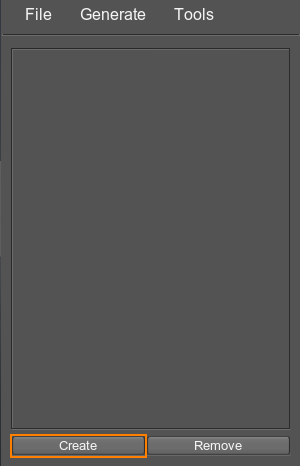

创建配置#
To start creating a setup from scratch, use the Create button.要从头开始创建设置,请使用Create按钮。
You can also use the Wall Generator to generate a wall of viewports.您还可以使用Wall Generator生成拼接屏。
Save the configuration via the menu (File -> Save) and then load it (File -> Load) to initiate rendering of the configured viewports.通过菜单(File -> Save)保存配置,然后加载它(File -> Load)以启动配置的视口的渲染。

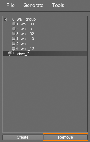

To remove the viewport, select it in the viewports tab and use the Remove button. Keep in mind, that if a viewport is in the wall group, it cannot be removed individually, only the whole group is removed.要删除视口,请在视口选项卡中选择它并使用Remove按钮。 请记住,如果一个视口在Wall组中,它不能单独删除,只有整个组被删除。

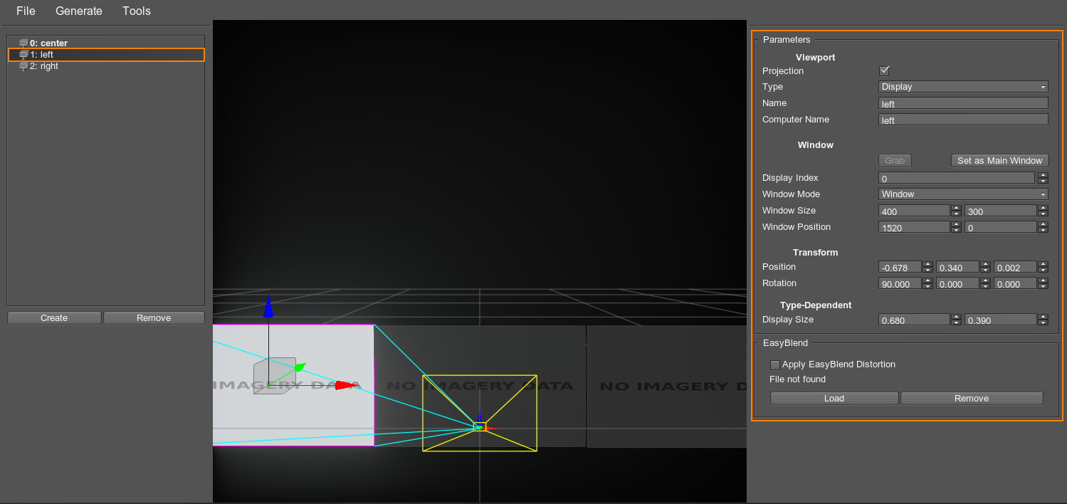

配置视口#
To configure a viewport, select it either in the viewports tab or in the display&projection visualization area. The following settings become available:要配置视口,请在视口选项卡或显示和投影可视化区域中选择它。 以下设置变为可用:
Viewport
Projection
Toggles correction of the image in the viewport. If disabled, the image is rendered as seen from the point of view without any distortions (i.e. regardless of the viewport plane position in the configuration space). If enabled, the image takes into account the projection angle (i.e. the viewport plane position relative to the point of view in the configuration space) and distorts the rendered image accordingly.切换视口中图像的校正。如果禁用,图像将按照视点呈现,没有任何失真(即,无论视口平面在配置空间中的位置如何)。如果启用,图像将考虑投影角度(即相对于配置空间中的视点的视口平面位置)并相应地扭曲渲染图像。
Projection Disabled投影禁用
Projection Enabled投影启用
Type
Image type rendered in the viewport. The image is rendered differently due to the different approach to the calculation of the projection matrix. Thus, you need to select the image type based on the device which is going to render the image:视口中呈现的图像类型。由于计算投影矩阵的方法不同,图像呈现的方式也不同。因此,你需要根据渲染图像的设备来选择图像类型:
  • DisplayDisplay(显示屏)
  • ProjectorProjector(投影仪)
Name Viewport name displayed in the window title bar and in the viewports tab on the left side of the SpiderVision Setup window.显示在窗口标题栏和SpiderVision Setup窗口左侧的视口选项卡中的视口名称。
Computer name
The name of the computer on which the viewport is to be displayed. If the box is empty, the viewport is displayed on any PC. If the name is set, the viewport is only displayed on the PC that has a matching name.要在其上显示视图的计算机的名称。如果该框为空,则在任何PC上显示该视窗。如果设置了名称,则视口只显示在具有匹配名称的PC上。
The computer name can also be set at the application instance start-up by using the corresponding start-up command.计算机名也可以在应用程序实例启动时通过使用相应的启动命令来设置。
Window
Grab The button that allows copying the currently set position, display index and window size to the window settings. The option is unavailable for a window controlled by another application instance (for example, when using Syncker) — in such a case you need to open SpiderVision Setup for that instance and grab that window transforms.该按钮允许将当前设置的位置、显示器索引和窗口大小复制到窗口设置。该选项对于由另一个应用程序实例控制的窗口不可用(例如,当使用Syncker时);在这种情况下,您需要为该实例打开SpiderVision Setup并获取窗口转换。
Set as Main Window The button that makes the window rendering the currently selected projection the main window. The main window is the window that displays the console and allows camera control.使渲染当前所选投影的窗口成为主窗口的按钮。主窗口是显示控制台并允许相机控制的窗口。
Display index OS index of the display on which the viewport should be rendered. If set to the index that exceeds (total number of displays - 1), the viewport is displayed on the monitor with the index 0.视窗应在其上呈现的显示器的OS索引。如果设置的索引超过(显示器总数- 1),则视口在索引为0的显示器上显示。
Window mode
Mode of the displayed window.显示的窗口的模式。
  • Window — bordered OS windowWindow:带边框的操作系统窗口
  • FullscreenFree — borderless window that uses the OS display resolution data to set the window sizeFullscreenFree:使用操作系统显示分辨率数据来定义窗口大小的无边界窗口
  • WindowBorderless — borderless OS window with the configurable sizeWindowBorderless:无边界操作系统窗口与可配置的大小
Window size Size of the window on the display (in pixels) if it is in the Window mode.显示器上的窗口的大小(像素),如果它是在Window模式。
Window position The window position on the screen (screen-space coordinates of the upper left corner).窗口在屏幕上的位置(左上角的屏幕空间坐标)。
Transform
Position The viewport plane position relative to the point of view (does not affect runtime if Projection Enabled is disabled).视口平面相对于视点的位置(如果 Projection Enabled 被禁用,不影响运行时)。
Rotation The viewport plane rotation relative to the point of view (does not affect runtime if Projection Enabled is disabled).视口平面相对于视点的旋转(如果 Projection Enabled 被禁用,不影响运行时)。
Type Dependent
Display size Physical size of the display to which the image is rendered (for Display image type). The value is set in meters.渲染图像的显示器物理尺寸(对于Display图像类型)。该值以米为单位设置。
Offset Offset of the projected image relative to the viewer (for Projector image type). The value is set in meters.投影图像相对于观看者的偏移量(对于Projector图像类型)。该值以米为单位设置。
Aspect Width-to-height ratio of the projected image (for Projector image type).投影图像的宽高比(对于Projector图像类型)。
Vertical FOV Vertical field of view, in degrees (for Projector image type).垂直视野,单位为度(对于Projector图像类型)。
Horizontal FOV Horizontal field of view, in degrees (for Projector image type). This value is calculated automatically depending on the Vertical FOV and is provided for information.水平视野,单位为度(对于Projector图像类型)。
