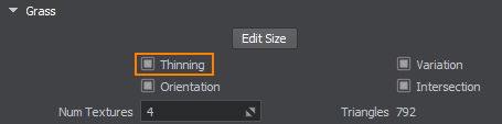

Thinning Grass
间草#
Except reducing the number of cells rendered per frame, the grass field can be thinned out with a distance. For this, enable the Thinning option to reduce the number of grass polygons rendered across the grass Fade distance.除了减少每帧渲染的单元数之外,还可以使草地变远。为此,启用Thinning选项可以减少在草Fade distance上渲染的草多边形的数量。
