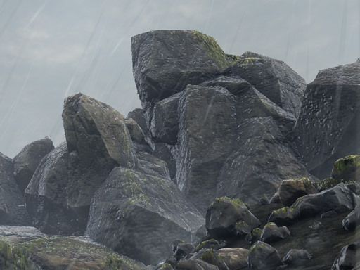

This postprocess material allows you to create an effect of a reflective wet surface, with water flowing down it. (See how to apply a postprocess material to the selected surface).
The material is mapped only along the X and Y axes. If a surface is not slanted to any side and completely flat, there will be no water flow on it (only reflection).
