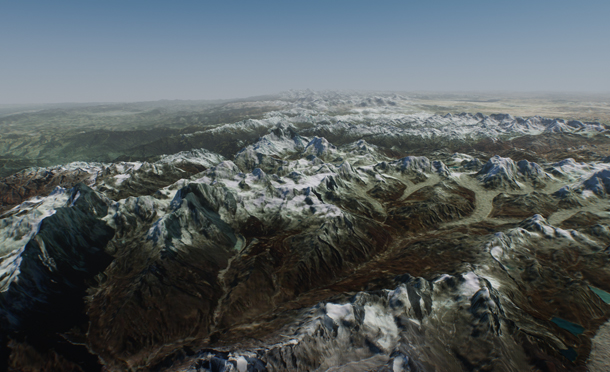

Global Terrain is a virtually limitless terrain representing a certain fragment of the Earth's surface. It can be generated on the basis of ordinary raster images and/or GIS data. In case of using GIS data, the appearance of the Global Terrain object is determined by the accuracy and availability of geospatial data. It should be noted that there are areas of the Earth's surface with only low-resolution data available or even no geospatial data at all.
This type of terrain can be successfully used for flight simulators: most of the time the plane remains at a very high altitude and low-resolution data is sufficient. High-resolution data is necessary only around landing and take-off areas.

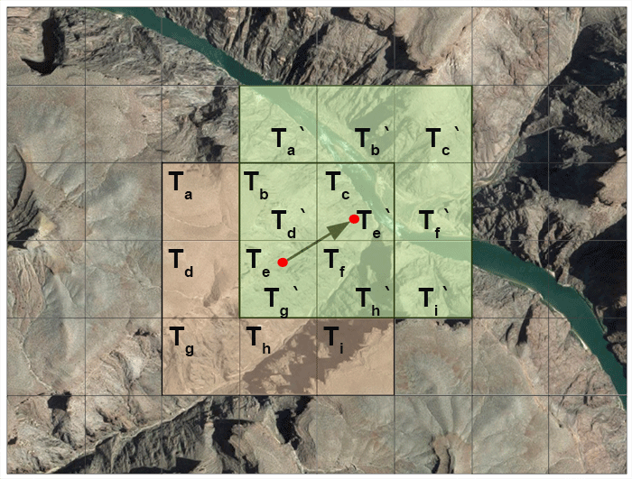

Global Terrain has a regular grid and is represented as a tileset. Each tile has a fixed size of 128 x 128 pixels. The number of tiles in each dimension (X and Y) is determined by the area size and data density. The higher the density the more tiles will be generated for the corresponding tileset.
For example, we have a height data texture with the density of 100 meters per pixel for an area of 50 square kilometers. Thus, we need (50000/100) x (50000/100) = 500 x 500 pixels which can be covered by 4 x 4 tiles.
Terrain tiles are stored on disk using a special format. The number of tiles, that can be stored on a disk is limited only to its capacity.
At run time, the tiles around the viewpoint are automatically loaded to GPU memory according to visibility distances specified for corresponding LODs. These visibility distances determine the number of tiles to be loaded and can be automatically reduced by the Engine in case if a GPU memory limit was reached.
Visible tiles change as the viewpoint moves along the terrain.

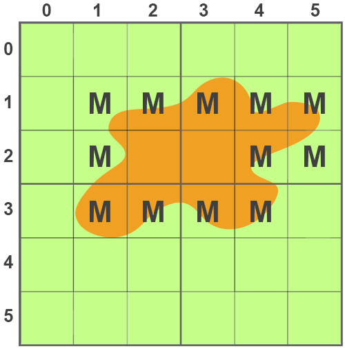

As it was mentioned, there might be no data available for a more detailed LOD of a certain area. In this case the values of the two adjacent LODs are blended together to provide a smooth look without sharp edges or black holes. Blending is performed by means of linear interpolation on the basis of masks generated by the Landscape Tool for a certain tile.
Masks are generated only for those tiles that contain the border between areas with different resolution.
Let us consider the following example. Suppose we have two LODs:
  • LOD1 with the resolution of 100 meters per pixel — green area
  • LOD0 with the resolution of 30 meters per pixel — orange area
In this case masks are generated only for the tiles marked with M.

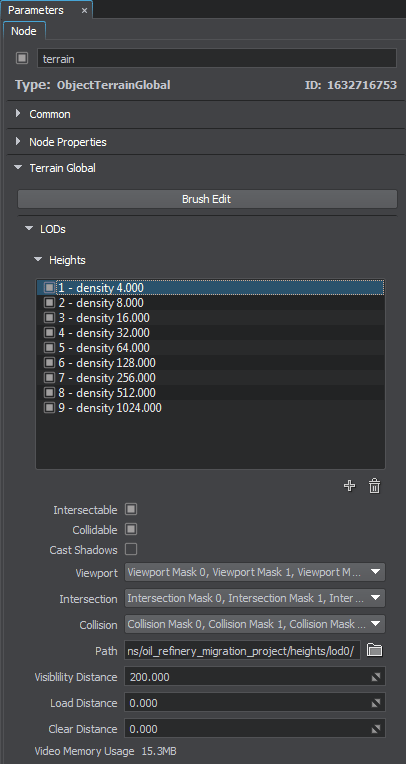

Parameters of a certain LOD of the height data layer can be accessed via the LODs section of the Node tab in the Parameters window.
You can add a new height or remove an existing one by clicking or respectively. Added heights can be toggled on and off by using checkboxes inside the Height window.
Parameters window, Node tab, LODs section.
The following parameters are available for the Height LODs:
  • Intersectabletoggle intersection detection for the current height LOD on and off.
  • Collidable — toggle collision detection for the current height LOD on and off.
  • Cast Shadow — toggle shadow casting for the current height LOD on and off. You can use this parameter for performance optimization: disable shadow casting for high-poly LODs and enable for low-poly ones.
    When only the low-poly LOD casts shadows, the high-poly LOD may be shadowed in areas where it shouldn't be. To reduce this effect, use the Shadow Offset parameter of the terrain material.
  • Viewportviewport mask for the current height LOD.
  • Intersectionintersection mask for the current height LOD.
  • Collisioncollision mask for the current height LOD.
  • Path — path to a folder, in which the current height LOD is stored.
  • Visibility distance — the distance starting from which the tiles of the current height LOD become visible.
  • Load distance — the distance starting from which the tiles of the current height LOD are loaded into memory.
  • Clear distance — the distance starting from which the tiles of the current height LOD are removed from memory.
  • Video memory usage — memory consumption of the current height LOD.

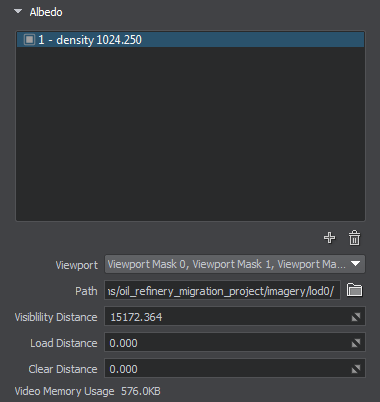

Albedo Data#
Parameters of a certain LOD of the albedo data layer can be accessed via the Albedo section of the Node tab in the Parameters window.
You can add a new LOD or remove an existing one by clicking or respectively. Added albedo layers can be toggled on and off by using checkboxes inside the Albedo window.
Parameters window, Node tab, Albedo section.
The following parameters are available for the Albedo LODs:
  • Viewportviewport mask for the current albedo LOD.
  • Path — path to a folder, in which the current albedo LOD is stored.
  • Visibility Distance — the distance starting from which the tiles of the current albedo LOD become visible.
  • Load Distance — the distance starting from which the tiles of the current albedo LOD are loaded into memory.
  • Clear Distance — the distance starting from which the tiles of the current albedo LOD are removed from memory.
  • Video Memory Usage — memory consumption of the current albedo LOD.

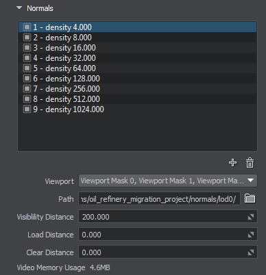

Normal Data#
Parameters of a certain LOD of the normal data layer can be accessed via the Normals section of the Node tab in the Parameters window.
You can add a new LOD or remove an existing one by clicking or respectively. Added normal layers can be toggled on and off by using checkboxes inside the Normals window.
Parameters window, Node tab, Normals section.
The following parameters are available for the Normal LODs:
  • Viewportviewport mask for the current normal LOD.
  • Path — path to a folder, in which the current normal LOD is stored.
  • Visibility Distance — the distance starting from which the tiles of the current normal LOD become visible.
  • Load Distance — the distance starting from which the tiles of the current normal LOD are loaded into memory.
  • Clear Distance — the distance starting from which the tiles of the current normal LOD are removed from memory.
  • Video Memory Usage — memory consumption of the current normal LOD.

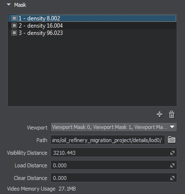

Parameters of a certain LOD of the masks data layer can be accessed via the Mask section of the Node tab in the Parameters window.
You can add a new LOD or remove an existing one by clicking or respectively. Added mask layers can be toggled on and off by using checkboxes inside the Mask window.
Parameters window, Node tab, Mask section.
The following parameters are available for the Mask LODs:
  • Viewportviewport mask for the current masks LOD.
  • Path — path to a folder, in which the current masks LOD is stored.
  • Visibility Distance — the distance starting from which the tiles of the current masks LOD become visible.
  • Load Distance — the distance starting from which the tiles of the current masks LOD are loaded into memory.
  • Clear Distance — the distance starting from which the tiles of the current masks LOD are removed from memory.
  • Video Memory Usage — memory consumption of the current masks LOD.

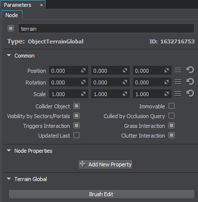

You can edit any height, albedo or mask LOD of the Global Terrain object using the Terrain Editor tool.
To start editing the current terrain, click Brush Edit in the Terrain Global section of the Node tab in the Parameters window.
The Terrain Editor window will be displayed.
When you're done editing the terrain, click either Apply to apply all changes and exit the terrain editor, or Cancel to discard your changes.

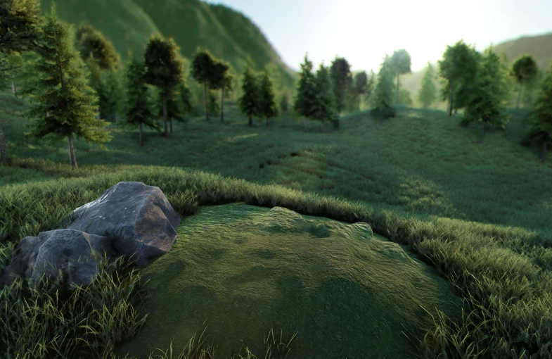

Creating Decal-Based Holes#

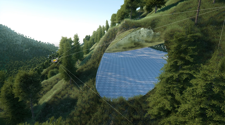

In some cases you may need to cut out an area of the terrain surface. For this purpose the Decal-Based Holes feature is supported by Global Terrain.

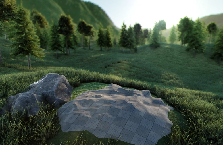

Place any decal (orthographic, projected or a mesh one) with the decal_terrain_hole_base material assigned over the desired location.
This will create a hole in the terrain surface.
A decal-based hole in a terrain with a circle mask applied.
Accurate intersection with decal-based terrain holes is supported, enabling collision detection as well as all corresponding Editor features such as selection, snapping to surface, etc.
