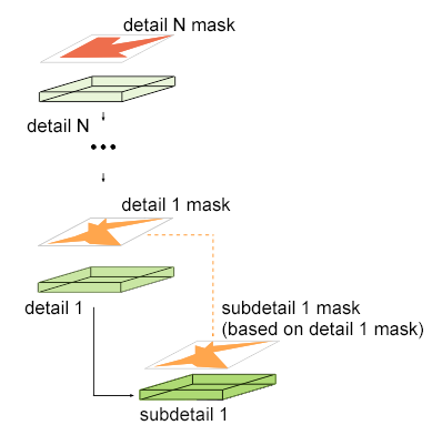

  • Base materialterrain_global_base is a basic material that is used to adjust various visualization and optimization parameters and control post processing effects for the whole global terrain. It's like a root layer, other layers will overlap (or overlay) the base material.
  • Detail is a set of textures and parameters that is used for terrain visual representation. Details are organized in a hierarchy and use detail masks. The hierarchy determines the order in which they are stacked on the terrain surface (overlap or overlay)
  • Subdetails have the same textures and parameters as details, but use the mask of their "parent" and can generate their own masks based on the parent's masks.

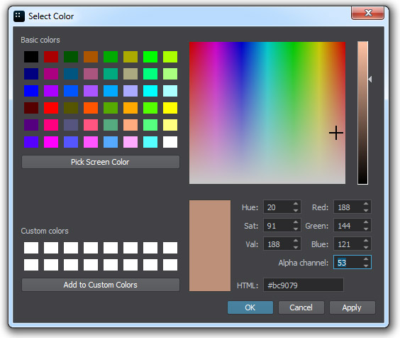

  • Mask by Albedo — here you can select a color of the imagery to be used as a mask. In this case, all areas on the terrain having selected color will be covered by the detail.
    You can click Pick Screen Color button and then click on any point on the terrain that has the desired color. Alpha value determines the color range to be selected.

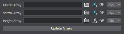

Texture Arrays#
Albedo, normal, and height textures for all details are stored in separate texture arrays. For each of the arrays, you can specify texture size.
  • Albedo Array — array of albedo textures of the detail
  • Normal Array — array of normal textures of the detail
  • Height Array — array of height textures of the detail
Texture arrays are not updated automatically. After making any changes to detail textures you should click Update Arrays.

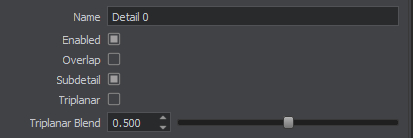

Common Parameters#
  • Name — the name of the detail. When you change the name, it will be automatically changed in the hierarchy.
  • Enabled — enable or disable the detail.
    Disabling a detail will automatically disable all its subdetails (if any).
  • Overlap — enable overlap blending mode.
    • Overlap mode for details is used for drawing them atop of terrain (without blending). Unlike Overlay, this mode is used to render details without any color alteration, for example, flowers, stones, etc.
    • If this option is disabled, the material is blended in the overlay blending mode. When detail materials are rendered in the Overlay mode, the colors of the surface and detail material diffuse textures are blended.
  • Subdetail — use the mask of the parent detail.
    Each detail uses a mask generated by the Landscape Tool (or generates its own mask by using own height texture with blending parameters based on the selected mask). A subdetail uses the mask of its parent detail (or generates its own mask based on the parent's mask).

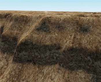

  • Triplanar — enable or disable triplanar texture mapping for the detail.
    When triplanar texture mapping is disabled, planar UV mapping is used instead. On the left picture below, you can see that the texture gets stretched on steep faces.
    Triplanar texture mapping is off (planar UV is used instead).
    Triplanar texture mapping is on.
  • Triplanar Blend — this value adjusts blending between triplanar texture projections.

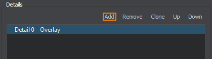

Adding a Detail#
To add a detail, click the Add button in the Details group.
In the Details group, you can perform the following operations:
  • Add — add a new detail.
  • Remove — remove a selected detail from the list.
  • Clone — clone the selected detail.
  • Up — move the detail up in the hierarchy.
  • Down — move the detail down in the hierarchy.
