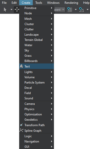

To add a text object to the scene via UnigineEditor, do the following:
- Run the project with UnigineEditor.
- On the Menu bar, click Create -> Text.
- Place the Text object somewhere in the world.

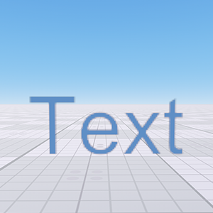

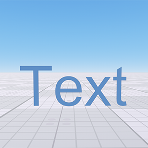

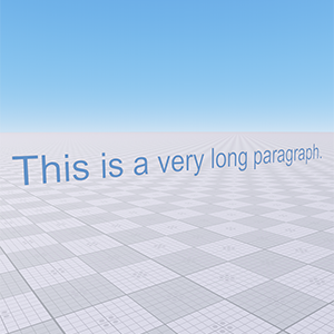

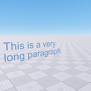

Wrap Width | Text wrap width in units. The text will wrap if its physical size will be greater than the set value. If 0 is set, text wrapping is disabled.
Size | Font size, in dots. The more dots, the higher the size of the font. To match dots with a 3D space, there is a set value: 288 dots per unit. For example, if you have the Arial font with the size of 20, the physical height of the letter can be calculated as 20/288=0.0694 units. | ||||
Resolution | Resolution of the texture into which the text will be rendered. The lower the value, the less detailed will be the text and the less video memory will be required for the texture.
The resolution doesn't influence the text's physical size.

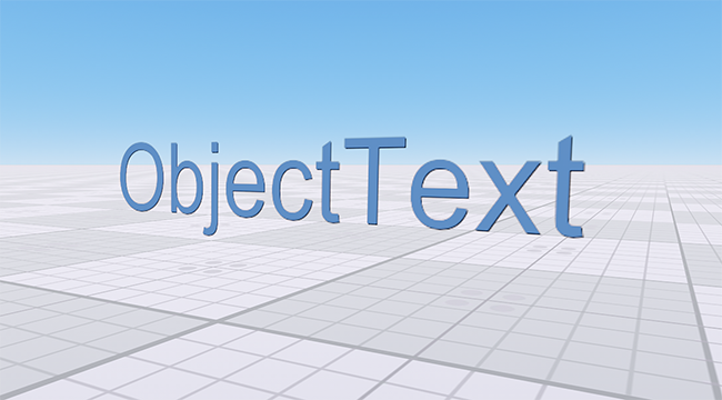

Rich text | Flag indicating if the rich text formatting is enabled. The following tags are supported:
<image/> and <table/> tags are not available. |
