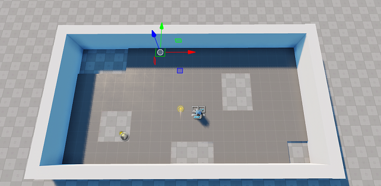

Let's create a plane with an emission material to represent the Color Zone.
- Choose Create->Mesh->Static and search for plane.mesh.
- Place it in the world via the Viewport.
- Rename the node color_zone.
- Scale it to the size of the play area and position it between the floor and the ground, so it is visible only through the holes.

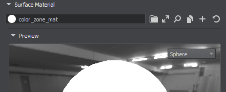

Create a color_zone_mat material inherited from mesh_base and assign it to the plane surface.
In the States tab, check the Emission option.

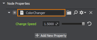

Switch back to the UnigineEditor and attach the ColorChanger property to the color zone visualization (color_zone).

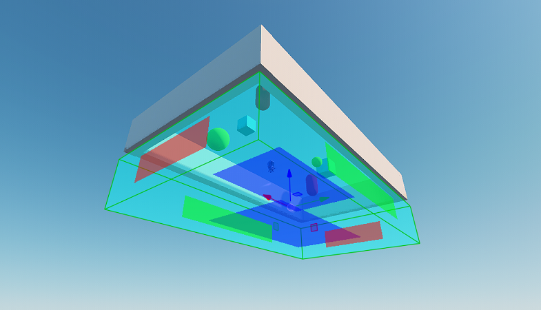

To get rid of objects that were thrown in the Color Zone, let's use a World Trigger. The trigger defines an area into which a physical object will fall and a callback that fires when an object gets inside.

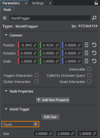

- Create a new World Trigger by choosing Create->Logic->World Tigger and place it in the world.
Check the Touch option in the Parameters Window of the World Trigger node to make the trigger fire callbacks on partial contact with another node.
Position it beneath the ground and adjust its size so it covers the whole play area by going to Parameters and clicking Edit Size. Adjust the size of the World Trigger in the Viewport.

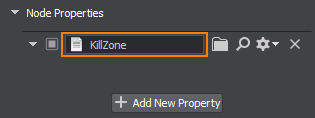

Switch back to UnigineEditor and add the KillZone component to the previously created World Trigger.

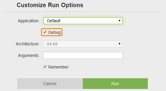

To run the project via the SDK Browser, click on the ellipsis beneath the Run button to open the Customize Run Options window. By default your IDE builds a Debug version of your applications, while the SDK Browser is configured to launch the Release one. So, before clicking Run you should check the Debug option to run the proper executable to check out your progress while developing your application.
