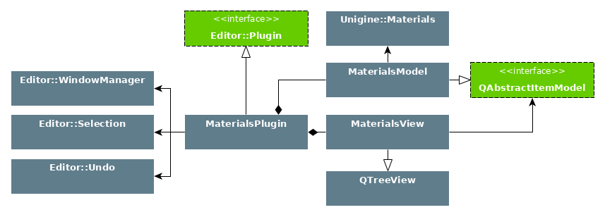

Basically the plugin's architecture looks as follows:基本上插件的架构如下所示:
Materials Plugin Architecture
Materials Plugin材质插件
The MaterialsPlugin class is an initialization point and complete representation of the plugin. It creates necessary data model and via the base interface associates it with the widget, which displays the hierarchy. The model directly interacts with the Materials Manager and transforms information on materials to the required structure.MaterialsPlugin 类是插件的初始化点和完整表示。 它创建必要的数据模型并通过基本接口将其与显示层次结构的小部件相关联。 模型直接与 Materials Manager 交互,并将材质信息转换为所需的结构。
The plugin interacts with Engine Materials System and Editor's external subsystems:该插件与 Engine Materials System 和 Editor 的外部子系统交互:
  • Adds a widget to WindowManager.WindowManager 添加一个小部件。
  • Adds a new item to the main menu bar.将新项目添加到主菜单栏。
  • Updates the state of materials widget when the global selection is changed.更改全局选择时更新材质小部件的状态。
  • Updates the global selection when the local selection is changed by sending a SelectionAction to the Undo stack.通过将 SelectionAction 发送到 Undo 堆栈来更改本地选择时更新全局选择。

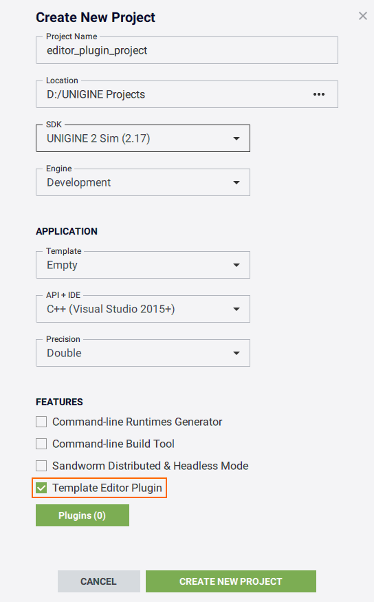

To start developing your plugin for UnigineEditor perform the following actions:要开始为 UnigineEditor 开发插件,请执行以下操作:
  1. Check the Editor Plugin Template option when creating a new project in SDK Browser (or choose Other Actions -> Configure Project if you want to use your new Editor plugin in an existing project).检查 Editor Plugin Template 选项时创建一个新项目SDK Browser 中(如果您想在现有项目中使用新的编辑器插件,请选择 Other Actions -> Configure Project)。
    Adding a plugin template
  2. Click Create New Project (or Update Configuration if you're adding a template to an existing project).单击 Create New Project(如果要将模板添加到现有项目,则单击 Update Configuration)。
After clicking the Create New Project / Update Configuration button, a set of projects for the Editor plugins will be added to your UNIGINE project's source folder and all necessary files will be added to these folders depending on your operating system and API + IDE selection in project settings:单击 Create New Project / Update Configuration 按钮后,编辑器插件的一组项目将添加到您的 UNIGINE 项目的 source 文件夹中,并且所有必要的文件都将添加到此文件夹中,具体取决于您的操作系统和项目设置中的 API + IDE 选择:
  • Windows OS: C++ (Qt-based / CMake) or UnigineScriptCMake will be used to build your plugin.Windows OS: C++ (Qt-based / CMake) or UnigineScriptCMake 将用于构建您的插件。
  • Windows OS: C# (.NET) or C++ (Visual Studio) — a .vcxproj project will be created and Visual Studio 2015+ will be used to build your plugin.Windows OS: C# (.NET) or C++ (Visual Studio) — 将创建一个 .vcxproj 项目,并使用 Visual Studio 2015+ 构建您的插件。
  • LinuxCMake will be used to build your plugin regardless of project configuration.LinuxCMake 将用于构建您的插件,无论项目配置如何。

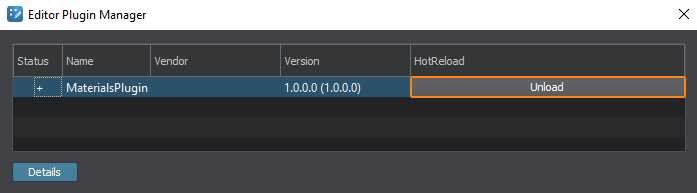

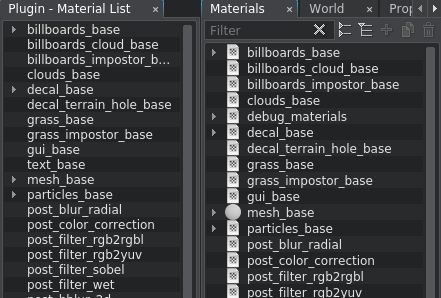

You can open this project in your IDE, build it, and give it a test drive right in the Editor as the project is pre-configured to launch with the UnigineEditor.您可以在 IDE 中打开该项目,构建它,然后在编辑器中对其进行测试,因为该项目已预先配置为使用 UnigineEditor 启动。

Running the Plugin
运行插件#
As the plugin is built, all resulting files are automatically copied to the %project_name%/bin/plugins/Unigine/ folder, so that UnigineEditor Plugin System could load it automatically.随着插件的构建,所有生成的文件都会自动复制到%project_name%/bin/plugins/Unigine/文件夹,这样UnigineEditor 的插件系统可以自动加载它。
And finally we launch UnigineEditor to check our plugin. If everything was done properly, you will see the MaterialsPlugin plugin in Editor Plugin Manager (Windows -> Editor Plugin Manager).最后我们启动 UnigineEditor 来检查我们的插件。如果一切正常,您应该会在Editor Plugin Manager (Windows -> Editor Plugin Manager) 中看到 MaterialsPlugin 插件。
Plugins List
You can unload and load your plugin again when necessary via the corresponding button in the HotReload column.您可以在必要时通过 HotReload 列中的相应按钮再次卸载加载插件。
