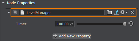

  3. Switch back to UnigineEditor and create a new Dummy Node called level_manager and place it somewhere in the world.切换回 UnigineEditor 并创建一个名为 level_manager 的新 Dummy Node 并将其放置在世界某处。
  4. Add a LevelManager component to the level_manager node via the Parameters window in the UnigineEditor.通过 UnigineEditor 中的 Parameters 窗口将 LevelManager 组件添加到 level_manager 节点。

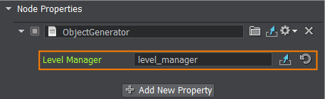

  3. Select the object_generator node in the World Nodes window and drag the level_manager node to the corresponding field of the ObjectGenerator property.选择object_generator节点World Nodes窗口拖动level_manager节点的对应字段ObjectGenerator财产。
