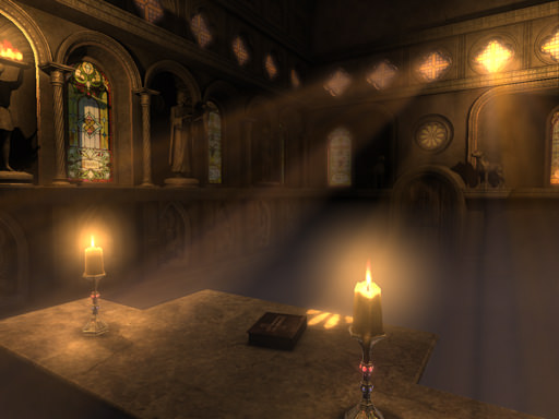

Volumetric objects are used to simulate different kinds of volumes depending on their materials:Volumetric objects用于模拟不同类型的体量,具体取决于它们的材质:
Visible light volumes (they are not light sources, therefore, they don't illuminate the scene):可见光体积(它们不是光源,因此不会照亮场景):
- Spheres of light around omnidirectional light sources Spheres
- Beams from directional light sources 光束来自方向光源
- Light volumes around flat light emitters Light volumes周围的平光发射器
- Sun beams falling into a room through openings 太阳光束从开口进入房间
- Fog that obscures objects inside its volume Fog使其卷内的对象模糊不清
