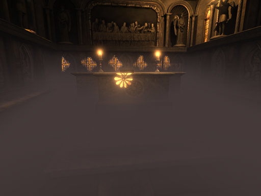

Volume Box with a fog material on the floor与雾材质体积箱在地板上
Volume Box with a fog material卷盒带有雾状材质

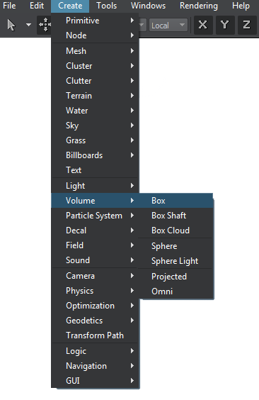

Creating a Box Object创建框对象#
To create a Box object, perform the following steps:创建一个框对象,请执行以下步骤:
- On the Menu bar, click Create -> Volume -> Box.
- Place the Box object somewhere in the world.将Box对象放置在世界的某个地方。
- Specify the Box object parameters.指定 Box 对象 参数。

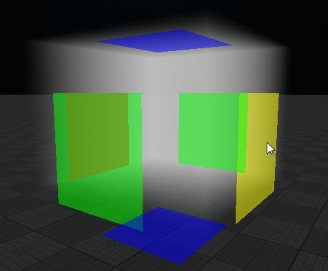

Edit Size | Toggles the editing mode for the Volume Box node. When enabled, the Volume Box sides that can be resized are highlighted with the colored rectangles. To change the size of a side, drag the corresponding rectangle.
Size | Length, width, and height of the box (in units) along X, Y, and Z axes.盒子沿X、Y和Z轴的长度、宽度和高度(单位)。 |
