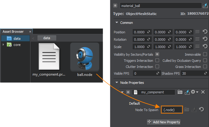

In UNIGINE, you should use World::loadNode to load a hierarchy of nodes from a .node asset. In this case the hierarchy of nodes that was saved as a NodeReference will be added to the scene. You can refer to the asset either via a component parameter or manually by providing the virtual path to it:在UNIGINE中,应使用World::loadNode从.node资源加载节点的层次结构。在这种情况下,将另存为NodeReference的节点层次结构添加到场景中。您可以通过以下方式引用资源:组件参数或通过提供虚拟路径对此:
// MyComponent.h
PROP_PARAM(File, node_to_spawn);
// MyComponent.cpp
void MyComponent::init()
// load a hierarchy of nodes from the asset
NodePtr spawned = World::loadNode(node_to_spawn.get());
spawned->setWorldPosition(node->getWorldPosition());
NodePtr spawned_manually = World::loadNode("nodes/node_reference.node");
In case of using the approach of component parameters, you should also specify the .node asset:如果使用组件参数方法,则还应指定.node资源:
You can also spawn the NodeReference as a single node (without extracting the content) in the world:您还可以将NodeReference生成为世界上的单个节点(不提取内容):
