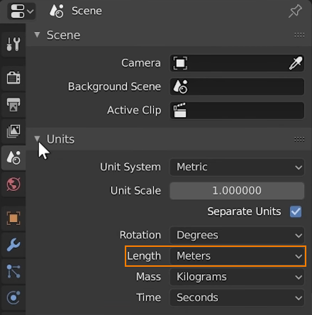

  • Check that Meters are set as working units.检查仪表是否设置为工作单位。
    Blender scale should be: 1 unit = 1 meter.Blender标度应为:1 unit = 1 meter

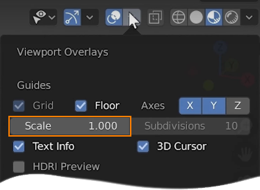

    For convenience, you can set the grid cell size equal to 1 meter:为了方便起见,您可以将网格像元大小设置为等于1米:

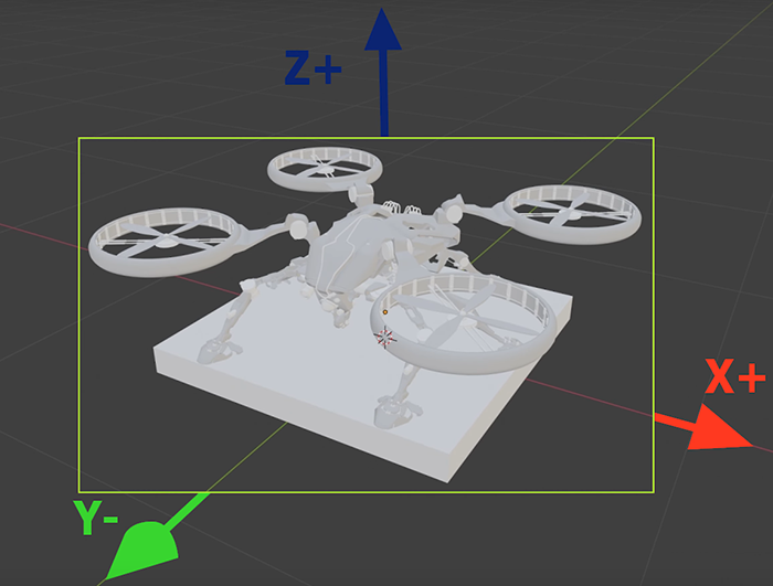

  • Orient the model towards the negative direction of the Y axis, which is the front direction in Blender.将模型朝向Y轴的负方向(即Blender中的正向)定向。
  • Set the actual model size.设置实际模型尺寸。
