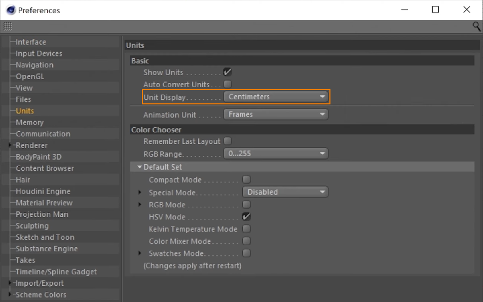

  • Select Edit -> Preferences... and check that Centimeters are set as Unit Display.选择Edit -> Preferences...并检查“厘米”是否设置为“单位显示”。

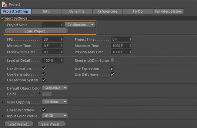

    In the Project Settings, check that Centimeters are set as working units.Project Settings中,检查是否已将厘米设置为工作单位。

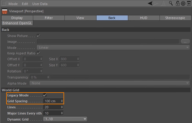

    In the Viewport options (Options -> Configure), Background tab, set the grid cell size of 1 meter for convenience.在“视口”选项(Options -> Configure)的“ Background”选项卡中,为方便起见,将栅格像元大小设置为1米。

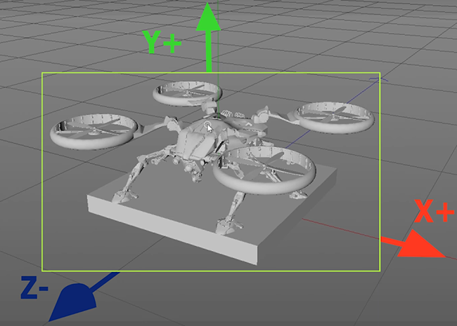

  • Orient the model towards the negative direction of the Z axis.将模型朝向Z轴的负方向。
  • Set the actual model size.设置实际模型尺寸。

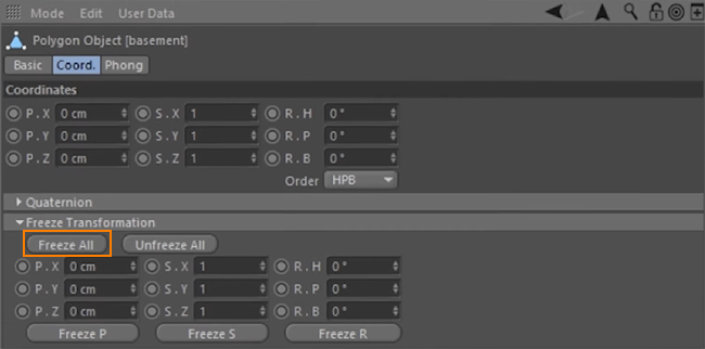

  • Freeze all transformations to avoid placement issues.冻结所有转换以避免放置问题。

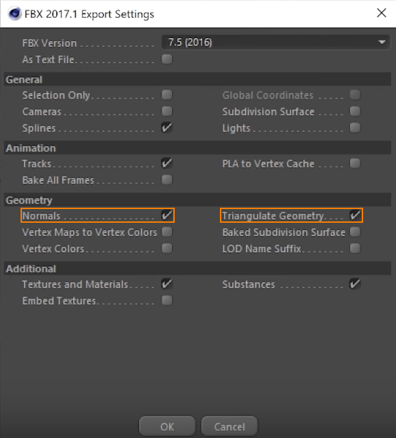

As soon as your model is ready for export, click File -> Export... -> FBX.一旦准备好导出模型,请单击File -> Export... -> FBX
In the Export Settings window, enable Normals and Triangulate Geometry.在“导出设置”窗口中,启用NormalsTriangulate Geometry
