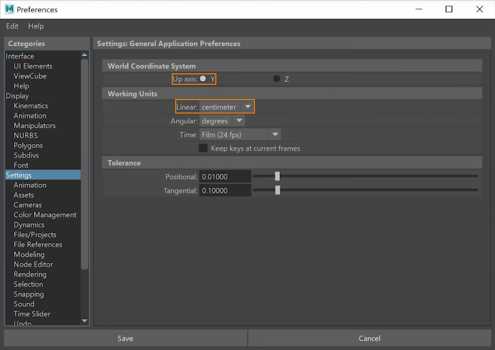

  • Check that World Coordinate System and Working Units are set as follows:检查是否按照以下方式设置了World Coordinate SystemWorking Units

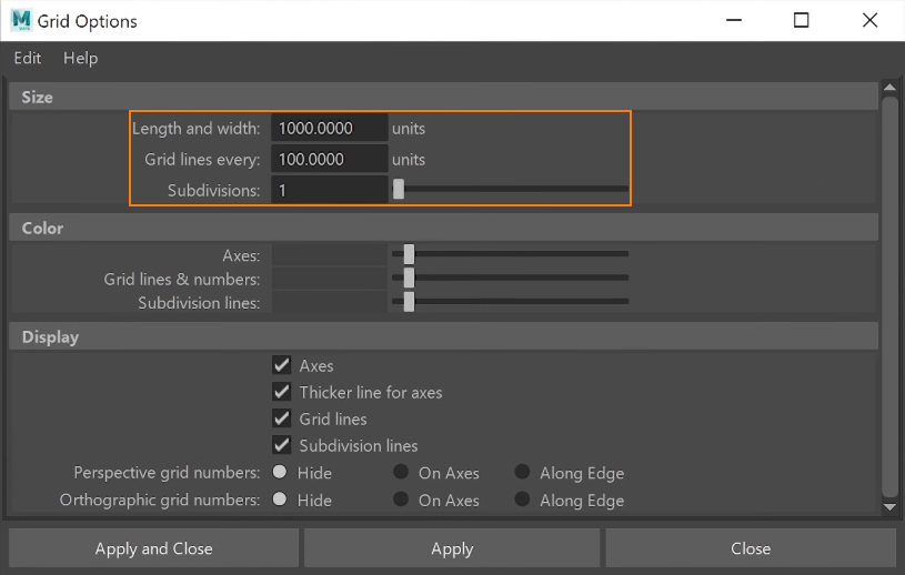

    For convenience, you can set the grid cell size equal to 1 meter. Click Display -> Grid and set the following:为了方便起见,您可以将网格像元大小设置为等于1米。单击Display -> Grid并设置以下内容:

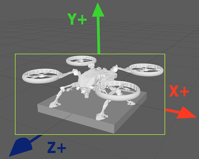

  • Orient the model towards the positive direction of the Z axis, which is the front direction in Autodesk Maya.将模型朝向Z轴的正方向(即Autodesk Maya中的正向)定向。
  • Set the actual model size.设置实际模型尺寸。

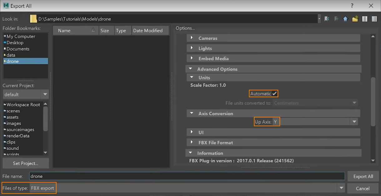

As soon as your model is ready for export, click File -> Export All....一旦准备好导出模型,请单击File -> Export All...
Export settings should be the following:导出设置应为以下内容:
  • Files of type: FBX export
  • Units: Automatic
  • Up Axis: Y
