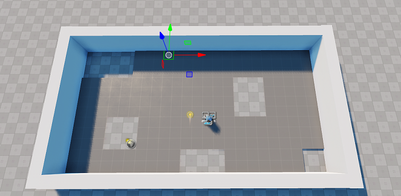

  1. To create Color Zones select some floor tiles in a group (holding the Shift hotkey), right-click and choose Unpack To Node Content.要创建颜色区域,在一组中选择一些地砖(按住Shift热键),右键单击并选择Unpack To Node Content
  2. Then disable Collisions for these nodes but make sure that Intersection is enabled, so that the character's turning works correctly.然后为这些节点禁用Collisions,但确保Intersection是启用的,以便字符的旋转工作正常。
  3. To make them invisible, go to Viewport Mask and click Clear All. This way all bits of mask are set to 0 and they will not match the Camera's Viewport Mask.要使它们不可见,请转到Viewport蒙版,然后单击Clear All。这样所有的掩码位都被设置为0,它们将不会匹配相机的Viewport掩码。
  4. Disable Collision option for the ground node. Now, physical objects can fall through the holes and the ground.ground节点禁用Collision选项。现在,物理物体可以从洞里掉到地上。

Let's create a plane with an emission material to represent the Color Zone.让我们用发射材质创建一个平面来代表颜色区域。
  1. Choose Create->Mesh->Static and search for plane.mesh.选择 Create->Mesh->Static 并搜索 plane.mesh
  2. Place it in the world via the Viewport.通过Viewport将其放置在世界中。
  3. Rename the node to color_zone.重命名节点color_zone
  4. Scale it to the size of the play area and position it between the floor and the ground, so it is visible only through the holes.将其缩放到游戏区域的大小,并将其放置在地板和地面之间,所以只有通过孔才能看到它。

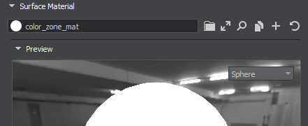

  5. Create a color_zone_mat material inherited from mesh_base and assign it to the plane surface.创建一个color_zone_mat材质继承mesh_base,并将其分配给plane表面。
  6. In the States tab, check the Emission option.States选项卡中,检查Emission选项。

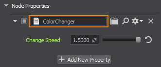

  3. Build and run the solution to generate a property file for the component.构建和运行的解决方案组件生成一个属性文件。
  4. Switch back to the UnigineEditor and attach the ColorChanger property to the color zone visualization (color_zone).切换回UnigineEditor,并将ColorChanger属性附加到颜色区域可视化(color_zone)。

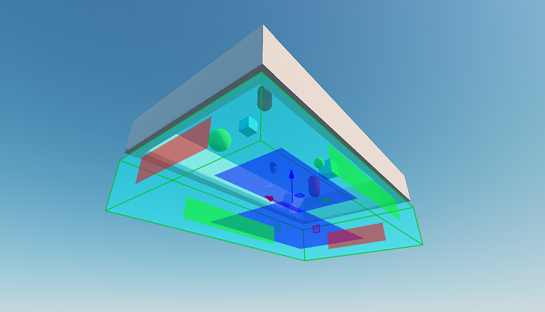

Step 4. Add a World Trigger
步骤4。添加一个世界触发器#
To get rid of objects that were thrown in the Color Zone, let's use a World Trigger. The trigger defines an area into which a physical object will fall and a callback that fires when an object gets inside.为了摆脱在颜色区域中抛出的对象,让我们使用 World Trigger。 触发器定义了一个物理对象将落入的区域,以及一个在对象进入时触发的 callback

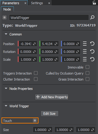

  1. Create a new World Trigger by choosing Create->Logic->World Tigger and place it in the world.通过选择Create->Logic->World Tigger创建一个新的World Trigger,并将其放到世界中。
  2. Check the Touch option in the Parameters window of the World Trigger node to make the trigger fire callbacks on partial contact with another node.World Trigger 节点的 Parameters 窗口中选中 Touch 选项,使触发器在部分接触时触发 callbacks 与另一个节点。
  3. Position it beneath the ground and adjust its size so it covers the whole play area by going to Parameters and clicking Edit Size. Adjust the size of the World Trigger in the Viewport.将它放置在地面下,调整它的大小,让它覆盖整个游戏区域,点击参数和Edit Size。在视口中调整World Trigger的大小。

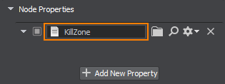

  5. Build and run the solution to generate a property file for the component.构建并运行解决方案以生成组件的属性文件。
  6. Switch back to UnigineEditor and add the KillZone component to the previously created World Trigger.切换回UnigineEditor并添加KillZone触发组件之前创建的世界。

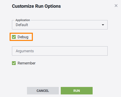

  8. To run the project via the SDK Browser, click on the ellipsis beneath the Run button to open the Customize Run Options window. By default your IDE builds a Debug version of your applications, while the SDK Browser is configured to launch the Release one. So, before clicking Run you should check the Debug option to run the proper executable to check out your progress while developing your application. 通过SDK Browser运行项目,单击省略号在Run按钮打开Customize Run Options窗口。默认情况下IDE构建Debug版本的应用程序,而SDK浏览器配置为启动Release。点击Run前你应该检查Debug选项运行适当的可执行的检查你的进展在开发您的应用程序。
