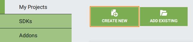

  1. Open the UNIGINE SDK Browser.打开UNIGINE SDK浏览器。
  2. Go to the Projects tab and click CREATE NEW.
    转到Projects选项卡,然后单击CREATE NEW

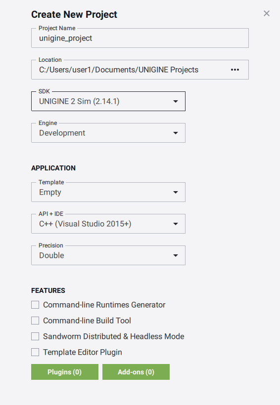

  3. Specify the following parameters:
    • Project name — specify the name of your project. Project name — specify the name of your project.
    • Location — specify the path to your project folder. Location — specify the path to your project folder.
    • SDK — choose the UNIGINE SDK edition. SDK — choose the UNIGINE SDK edition.
    • API+IDE — choose C++ to start working with the C++ API.
      This parameter depends on a platform:This parameter depends on a platform:
      • On Windows, you can create C++ Visual Studio 2022 project.On Windows, you can create C++ Visual Studio 2022 project.
      • On Linux you can create C++ GNU make project.On Linux you can create C++ GNU make project.
      You can also can create C++ CMake projectYou can also can create C++ CMake project
      This parameter depends on a platform:On Windows, you can create C++ Visual Studio 2022 project.On Linux you can create C++ GNU make project.You can also can create C++ CMake project
    • Precision - specify the precision. In this example we will use double precision.Precision - specify the precision. In this example we will use double precision.
    Read more about these parameters in this article Read more about these parameters in this article
    Project name — specify the name of your project. Location — specify the path to your project folder. SDK — choose the UNIGINE SDK edition. API+IDE — choose C++ to start working with the C++ API.
    This parameter depends on a platform:On Windows, you can create C++ Visual Studio 2022 project.On Linux you can create C++ GNU make project.You can also can create C++ CMake projectPrecision - specify the precision. In this example we will use double precision.Read more about these parameters in this article

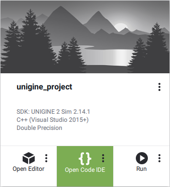

  1. If you created the C++ project for Visual Studio:如果您为Visual Studio创建了 C ++项目
    1. Choose your C++ project in the UNIGINE SDK Browser and click the Open Code IDE button to open the project in IDE.
      在UNIGINE SDK浏览器中选择您的C ++项目,然后单击Open Code IDE按钮以在IDE中打开该项目。

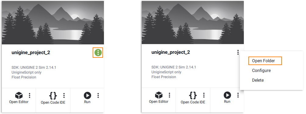

    If you created C++ GNU make project:如果创建了C++ GNU make project
    1. On the created C++ project, click on the Other Actions button and then the Open Folder button.
      在创建的C ++项目上,单击Other Actions按钮,然后单击Open Folder按钮。

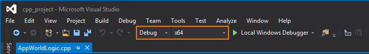

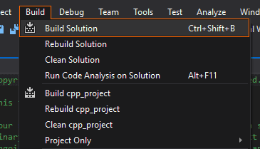

  3. If you use Visual Studio, do the following:如果使用Visual Studio,请执行以下操作:
    1. Before compiling your code, check that the appropriate platform and configuration settings for your project are set correctly.
      在编译代码之前,请检查是否为您的项目正确设置了合适的平台和配置设置。

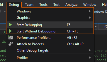

    2. Build your project by clicking Build -> Build Solution in Visual Studio.
      通过单击Visual Studio中的Build -> Build Solution来构建项目。
    3. Start your project by clicking Debug -> Start in a proper mode in Visual Studio.
      Visual Studio中以适当的模式单击Debug -> Start来启动项目。
