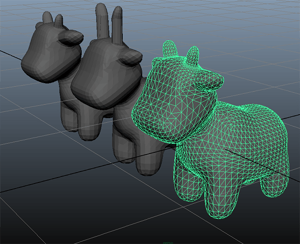

This section shows the way of exporting meshes with blend shapes in the FBX format from Autodesk Maya. It contains an example mesh of a calf, which has 2 blend shapes (morph targets).本节展示了从Autodesk Maya导出FBX格式的混合形状网格的方法。它包含一个小牛的示例网格,它有2个混合形状(变形目标)。

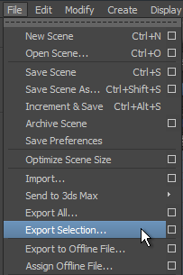

  2. In the main menu, click File -> Export Selection...在主菜单中,单击File -> Export Selection...

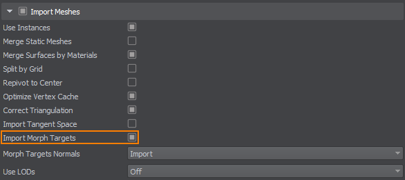

  1. Import the *.fbx file with the Import Morph Targets option enabled.启用 Import Morph Targets 选项并导入*.fbx文件。

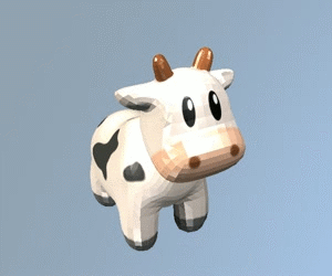

After assigning the component to the mesh, the result looks as follows:将组件分配给网格后,结果如下:
