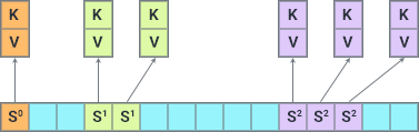

A hash map container template. The hash map stores items represented by key-value pairs in an unspecified order. Data are stored in the following way:
This approach to data storage may deem appropriate only in case you need the hashmap address to remain unchanged. For a more performance-friendly way to store hashmap data, use HashMap class.
Hash map can be used, for example, for searching among nodes by their names.
