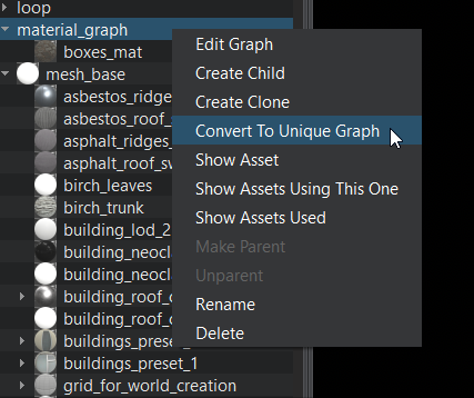

Converting to Unique Graph#
If you want to make some material inherited from mesh_base into a unique graph material at the top level of hierarchy, you must reparent it to some graph base material and then in the context menu (available on the right mouse click) select Convert To Unique Graph.
In this case, the material will be turned into a default template material and won't preserve previous parameters and any logic. We are working on a smart conversion which must be available later.
