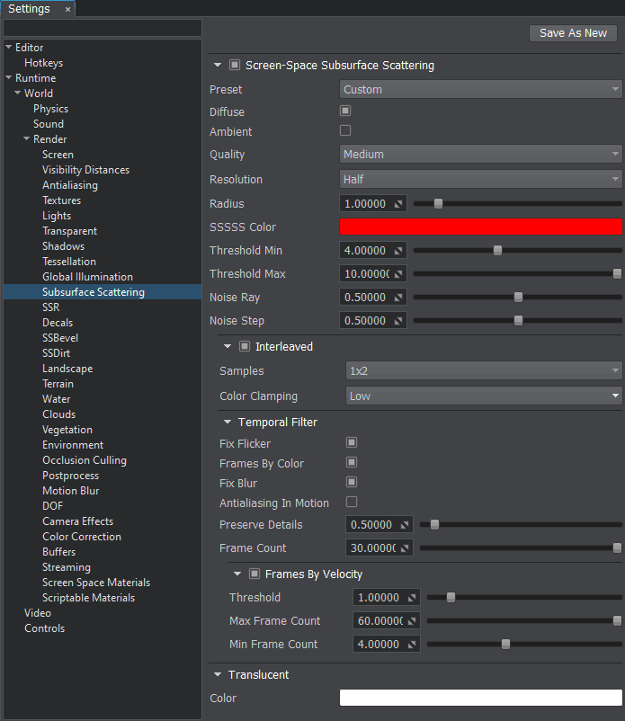

Настройки подповерхностного рассеяния
Common Parameters
Common Parameters#

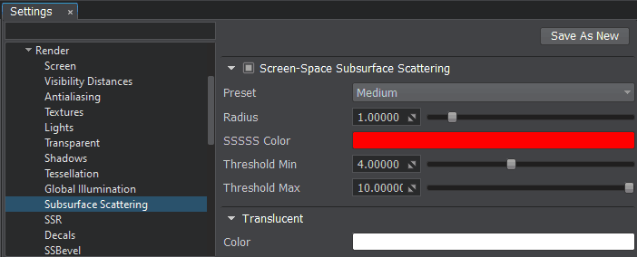

Screen-Space Subsurface Scattering
Консольная команда: sss_enabled (API)
Preset SSSSS (Screen-Space Subsurface Scattering) preset used at the moment. To customize the SSSSS effect options at run time you should activate the Custom preset: Одно из следующих значений:
  • Low (по умолчанию)
  • Medium
  • High
  • Ultra
  • Extreme
  • Custom
Консольная команда: render_sssss_preset (API)

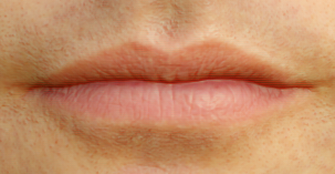

Radius subsurface scattering radius — distance in the screen space, within which colors will be sampled.It controls how much wrinkles, pores and cavities will be blurred and highlighted. The higher the value, the farther subsurface scattering reaches. Too high values result in the ghosting effect. By the minimum value of 0, no subsurface scattering is rendered.
Диапазон значений: [0.0f, inf]. Значение по умолчанию : 1.0f.
Консольная команда: render_sssss_radius (API)
Radius = 1
Radius = 1Radius = 1
Radius = 0.2
Radius = 0.2Radius = 0.2
SSSSS Color subsurface scattering color used to simulate the subsurface component of skin lighting, i.e. the light that bounces inside of the subsurface tissue layers (epidermis and dermis) before exiting.For skin, subsurface color is reddish, due to blood circulating in skin tissues. To use this option, SSSSS effect (см. SSSSS) should be enabled.
vec4(1.0f, 0.0f, 0.0f, 1.0f) - default value
Консольная команда: render_sssss_color (API)
Threshold Min threshold of SSSSS (Screen-Space Subsurface Scattering) for the material's Translucent parameter equal to 0 (minimum translucency). To use this option, the SSSSS effect (см. SSSSS) should be enabled.
Диапазон значений: [0.0f, inf]. Значение по умолчанию : 4.0f.
Консольная команда: render_sssss_min_threshold (API)
Threshold Max threshold of SSSSS (Screen-Space Subsurface Scattering) for the material's Translucent parameter equal to 1 (maximum translucency). To use this option, the SSSSS effect (см. SSSSS) should be enabled.
Диапазон значений: [0.0f, inf]. Значение по умолчанию : 10.0f.
Консольная команда: render_sssss_max_threshold (API)

Настраиваемые параметры#
SSS custom settings
Diffuse value indicating if the SSSSS (Screen-Space Subsurface Scattering) calculation for diffuse lighting (directional lights) is enabled. If this option is not required, disable it to save performance. To use this option, the SSSSS effect (см. SSSSS) should be enabled. вкл. по умолчанию.
Консольная команда: render_sssss_diffuse (API)
Ambient value indicating if the SSSSS (Screen-Space Subsurface Scattering) calculation for ambient lighting (environment) is enabled. If this option is not required, disable it to save performance. To use this option, the SSSSS effect (см. SSSSS) should be enabled. выкл. по умолчанию.
Консольная команда: render_sssss_ambient (API)
Quality quality of the SSSSS (Screen-Space Subsurface Scattering) effect. Одно из следующих значений:
  • Low - low quality
  • High - high quality
  • Ultra - ultra quality
Консольная команда: render_sssss_quality (API)

Resolution resolution of the SSSSS (Screen-Space Subsurface Scattering) effect. Одно из следующих значений:
  • Full - full resolution
Консольная команда: render_sssss_resolution (API)
Noise Ray intensity of the ray noise used for SSSSS (Screen-Space Subsurface Scattering) calculation to reduce banding artifacts of tracing. Higher values make banding less visible. To use this option, the SSSSS effect (см. SSSSS) should be enabled.
Диапазон значений: [0.0f, 1.0f]. Значение по умолчанию : 0.5f.
Консольная команда: render_sssss_noise_ray (API)
Noise Step intensity of the step noise used for SSSSS (Screen-Space Subsurface Scattering) calculation to reduce banding artifacts of tracing. Higher values make banding less visible. To use this option, the SSSSS effect (см. SSSSS) should be enabled.
Консольная команда: render_sssss_noise_step (API)
Interleaved Rendering Options
Параметры рендеринга с чередованием#
Enabled value indicating if the interleaved rendering mode for SSSSS (Screen-Space Subsurface Scattering) is enabled. This option enables rendering of the effect in only half or quarter of all pixels with subsequent reconstruction of neighboring pixels using the data from previous frames, significantly improving performance.
The effect is cumulative and works best with Temporal Filter, which reduces ghosting and noise artifacts.
выкл. по умолчанию.
Консольная команда: render_sssss_interleaved (API)
