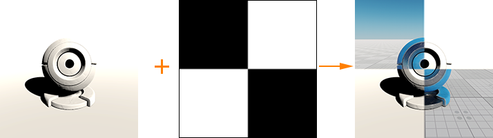

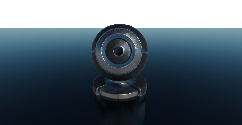

By using the mask, you can control the area of debug material visibility. For example, by using the mask, you can create a smooth transition between the image that displays a rendering buffer and the final image. Or you can combine these images as follows:
Diffuse Lighting Image (debug_lights material) Combined with Final Image

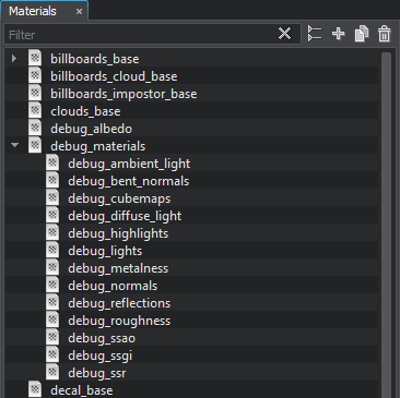

UNIGINE provides a set of preconfigured debug materials that allow debugging lighting, reflections, screen space effects, and so on. These materials are available in the Materials Hierarchy Window:
Debug Materials Presets in Materials Hierarchy
Such materials are inherited from debug_materials. You can apply one of them as is, or inherit a new material from one of them and change the parameters, apply a mask texture, or toggle the states on and off.

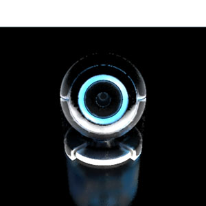

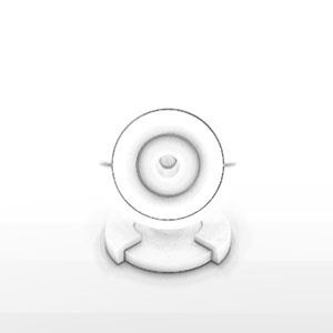

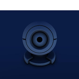

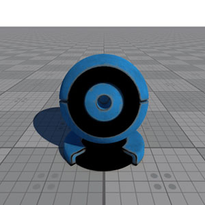

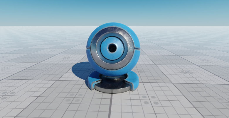

The following pictures demonstrate some of the preconfigured debug materials applied to the scene:
debug_ssao Material
debug_ssr Material
debug_ambient_light Material
debug_diffuse_light Material
