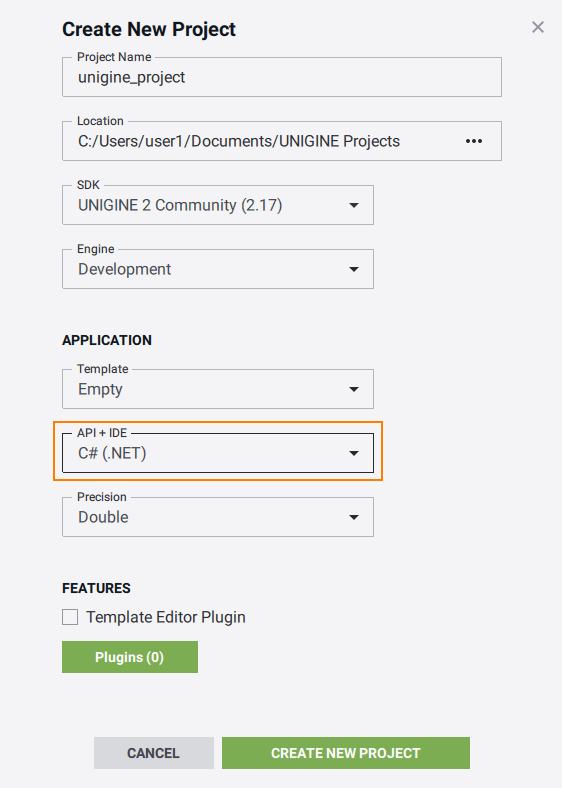

  1. Open the SDK Browser and create a new C# project. To do this, select C# (.NET) in the API + IDE list of the Application section.
  2. Run the Editor by clicking Open Editor.

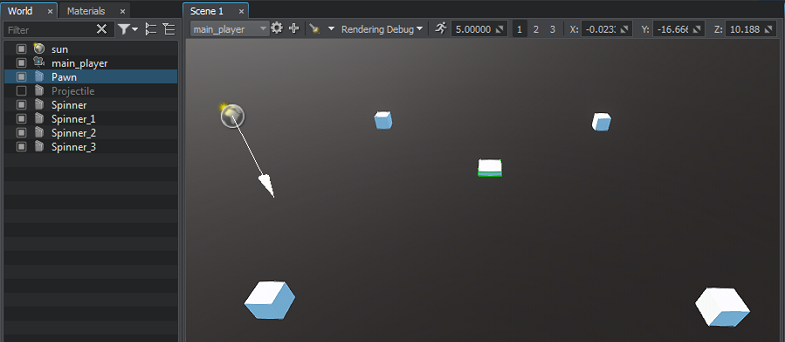

  3. Prepare the world: delete or disable unnecessary objects, such as static_content, dynamic_content, etc.

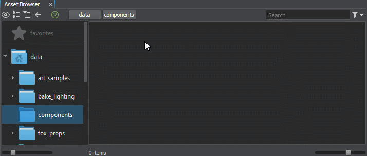

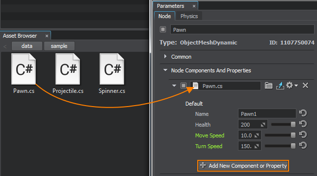

For each of our objects, we should describe logic in a separate C# component. Therefore, we should do the following:
  • Create a C# component for each game entity.
  • Open the source code in the default IDE by double clicking any *.cs asset.

As we implemented our game logic in the components, we can actually start using them. But first, we should create game objects. It is possible both via UnigineEditor and code.
Creating a Scene via Editor#
  1. Create a World light source to illuminate the whole scene.
  2. Add a new camera to the world and adjust its position. This will be our default camera, so check on its Main Player flag.
  3. Create a Box primitive to represent Pawn. Assign the Pawn component by clicking Add New Component or Property and dragging the asset to the corresponding field. You can also drag the component from the Asset Browser to the node in the Editor Viewport. Adjust the parameters of the player.

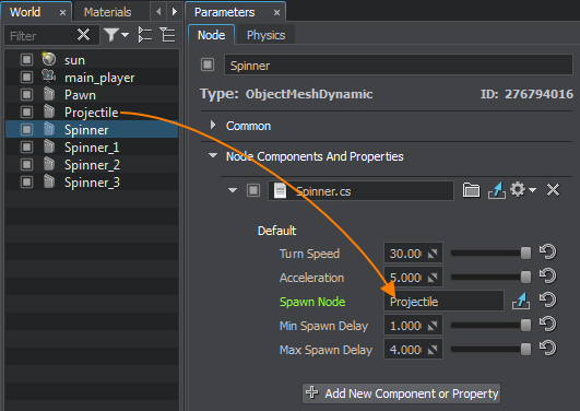

  4. Create another smaller box — a template for projectiles. We can disable it since its clones will be used.
  5. Create the required number of objects for Spinners at the same height as Pawn, assign the corresponding component to them and adjust the parameters. Specify the spawn node by dragging the Projectile node to the field.
    On this step the scene looks as follows:

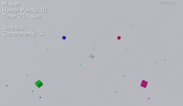

Running the Project#
Select a desired play preset on the toolbar and click the Play button to run an instance of the application.
