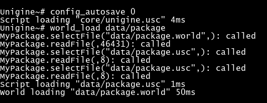

The MyPackage class has overridden ReadFile(), SelectFile(), GetFileName() and GetNumFiles() functions. The class operates with two files located in the my_data folder.
In the Main() function we create an instance of the MyPackage class and add it to the FileSystem before initializing the engine using the PreloadExternPackage() method.
Output#
The following result will be shown in the console:
