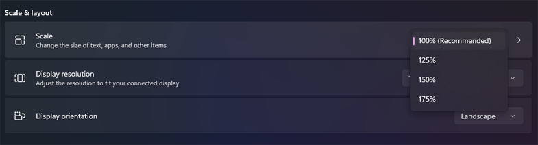

The standard DPI for most systems is 96 DPI, which means 96 pixels are rendered per inch. Higher DPI values indicate that more pixels are packed into the same physical space. For example, 120 DPI (125% scaling) or 144 DPI (150% scaling), increase the perceived size of GUI elements while maintaining visual clarity.
System scaling (or DPI scaling) is the process of adjusting GUI elements, text, textures, etc. to appear at a consistent size regardless of the display resolution. When a user sets their system scaling (commonly configured under Display Settings -> Scale in modern OSes) to 125%, 150%, or 175%, the OS effectively increases the window size.
Then, a DPI change aware application responds by applying a corresponding scale factor (the OS-provided multiplier, e.g. 1.5 for 150%) to all internal components.
For example:
  • 100% (96 DPI): 1 logical unit = 1 physical pixel (no scaling, displayed elements remain at their original pixel size)
  • 150% (144 DPI): 1 logical unit = 1.5 physical pixels (displayed elements are enlarged by 1.5x)
  • 200% (192 DPI): 1 logical unit = 2 physical pixels (displayed elements are enlarged by 2x).

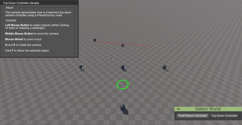

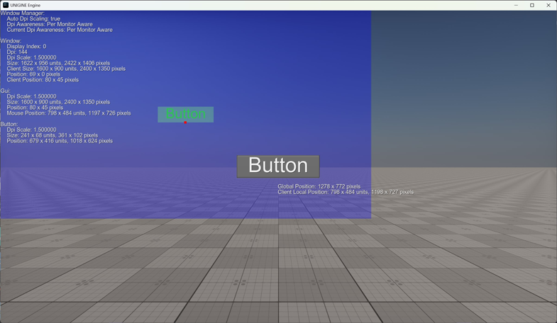

Example #1. System scaling: 125%.
When doing size and position calculations it's important to do them in one unit system (pixels or logical units) and then convert the results to the target, unit system, if necessary. Intermixing of pixels and logical units in calculations might likely lead to incorrect behavior and appearance at DPI scales > 100%, as can be seen here with the offset primitive shapes in WidgetCanvas.
WRONG
AppSystemLogic.cpp
WidgetCanvasPtr canvas = WidgetCanvas::create();
WindowManager::getMainWindow()->addChild(canvas, Gui::ALIGN_OVERLAP);
${#HL}$ivec2 window_size = WindowManager::getMainWindow()->getClientRenderSize(); // pixels - WRONG ${HL#}$
vec2 text_position = vec2(window_size) * .5f; // units
int text = canvas->addText();
canvas->setTextSize(text, 40);
canvas->setTextText(text, "Text");
canvas->setTextPosition(text, text_position); // text position is expected to be in units
Widgets are offset from their expected positions and do not accurately reflect the scene layout.
FIXED
AppSystemLogic.cpp
${#HL}$window_size = WindowManager::getMainWindow()->getClientSize(); // units - CORRECT ${HL#}$
Widget offsets fixed by using consistent unit types.

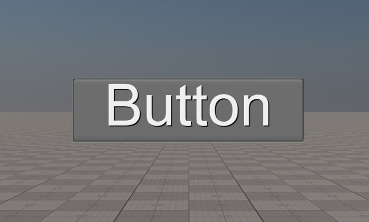

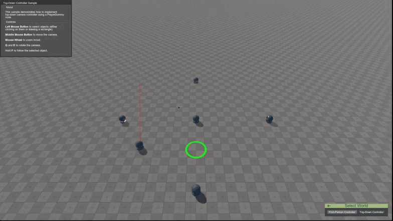

Example #3. Same GUI at 200% scaling.
Auto DPI Scaling disabled. The font and the background texture become blurry and visually degraded with the parameter toggled off.
Auto DPI Scaling enabled. Both the font and the background texture look sharp.

      The following example demonstrates how to create a debug overlay to detect coordinates misalignment:
      AppSystemLogic.h
      #ifndef __APP_SYSTEM_LOGIC_H__
      #define __APP_SYSTEM_LOGIC_H__
      #include "UnigineLogic.h"
      #include "UnigineWidgets.h"
      class AppSystemLogic : public Unigine::SystemLogic
          int init() override;
          int update() override;
          Unigine::WidgetLabelPtr info_label;
          Unigine::WidgetLabelPtr mouse_info_label;
          Unigine::WidgetButtonPtr button;
          Unigine::WidgetCanvasPtr info_canvas;
          int polygon_client_window{-1};
          int polygon_button{-1};
          int polygon_mouse{-1};
          int text_button{-1};
          Unigine::Math::vec4 polygon_button_color{0.5f, 1.0f, 0.5f, 0.3f};
          Unigine::EventConnections connections;
      #endif // __APP_SYSTEM_LOGIC_H__
      AppSystemLogic.cpp
      #include "AppSystemLogic.h"
      using namespace Unigine::Math;
      int AppSystemLogic::init()
          info_canvas = WidgetCanvas::create();
          polygon_client_window = info_canvas->addPolygon();
          polygon_button = info_canvas->addPolygon();
          text_button = info_canvas->addText();
          polygon_mouse = info_canvas->addPolygon();
          info_canvas->setTextText(text_button, "Button");
          info_canvas->setTextSize(text_button, 60);
          WindowManager::getMainWindow()->addChild(info_canvas, Gui::ALIGN_LEFT | Gui::ALIGN_OVERLAP | Gui::ALIGN_BACKGROUND);
          info_label = WidgetLabel::create();
          info_label->setFontSize(16);
          info_label->setFontOutline(1);
          WindowManager::getMainWindow()->addChild(info_label, Gui::ALIGN_LEFT | Gui::ALIGN_OVERLAP);
          mouse_info_label = WidgetLabel::create();
          mouse_info_label->setFontSize(16);
          mouse_info_label->setFontOutline(1);
          WindowManager::getMainWindow()->addChild(mouse_info_label, Gui::ALIGN_OVERLAP);
          button = WidgetButton::create("Button");
          button->setFontSize(60);
          button->setFontOutline(1);
          WindowManager::getMainWindow()->addChild(button, Gui::ALIGN_CENTER);
          button->getEventPressed().connect(connections, [this]()
              polygon_button_color = vec4(0.0f, 1.0f, 0.0f, 0.3f);
          button->getEventReleased().connect(connections, [this]()
              polygon_button_color = vec4(0.5f, 1.0f, 0.5f, 0.3f);
          Input::setMouseHandle(Input::MOUSE_HANDLE_USER);
      int AppSystemLogic::update()
          String info;
          auto print_dpi_awareness = [&info](const char *title, WindowManager::DPI_AWARENESS awareness)
              info += String::format("\t%s: ", title);
              switch (awareness)
                  case WindowManager::DPI_AWARENESS_CUSTOM:            info += "Custom";            break;
                  case WindowManager::DPI_AWARENESS_UNAWARE:           info += "Unaware";           break;
                  case WindowManager::DPI_AWARENESS_SYSTEM_AWARE:      info += "System Aware";      break;
                  case WindowManager::DPI_AWARENESS_PER_MONITOR_AWARE: info += "Per Monitor Aware"; break;
              info += "\n";
          auto print_int = [&info](const char *title, int value) { info += String::format("\t%s: %d\n", title, value); };
          auto print_float = [&info](const char *title, float value) { info += String::format("\t%s: %f\n", title, value); };
          auto print_ivec2 = [&info](const char *title, const ivec2 &value, const char *measure)
              info += String::format("\t%s: %d x %d %s\n", title, value.x, value.y, measure);
          auto print_units_and_pixels = [&info](const char *title, const ivec2 &units, const ivec2 &pixels)
              info += String::format("\t%s: %d x %d units, %d x %d pixels\n", title, units.x, units.y, pixels.x, pixels.y);
          // window manager
          info += "Window Manager:\n";
          info += String::format("\tAuto Dpi Scaling: %s\n", WindowManager::isAutoDpiScaling() ? "true" : "false");
          print_dpi_awareness("Dpi Awareness", WindowManager::getDpiAwareness());
          print_dpi_awareness("Current Dpi Awareness", WindowManager::getCurrentDpiAwareness());
          info += "\n";
          // window
          info += "Window:\n";
          EngineWindowPtr window = WindowManager::getMainWindow();
          print_int("Display Index", window->getDisplayIndex());
          print_int("Dpi", window->getDpi());
          print_float("Dpi Scale", window->getDpiScale());
          print_units_and_pixels("Size", window->getSize(), window->getRenderSize());
          print_units_and_pixels("Client Size", window->getClientSize(), window->getClientRenderSize());
          print_ivec2("Position", window->getPosition(), "pixels");
          print_ivec2("Client Position", window->getClientPosition(), "pixels");
          info += "\n";
          // gui
          info += "Gui:\n";
          GuiPtr gui = window->getSelfGui();
          print_float("Dpi Scale", gui->getDpiScale());
          ivec2 unit_gui_size = gui->getSize();
          ivec2 pixel_gui_size(gui->toRenderSize(unit_gui_size.x), gui->toRenderSize(unit_gui_size.y));
          print_units_and_pixels("Size", unit_gui_size, pixel_gui_size);
          print_ivec2("Position", gui->getPosition(), "pixels");
          ivec2 unit_gui_mouse_position(gui->getMouseX(), gui->getMouseY());
          ivec2 pixel_gui_mouse_position(gui->toRenderSize(unit_gui_mouse_position.x), gui->toRenderSize(unit_gui_mouse_position.y));
          print_units_and_pixels("Mouse Position", unit_gui_mouse_position, pixel_gui_mouse_position);
          info += "\n";
          // button
          info += "Button:\n";
          print_float("Dpi Scale", button->getDpiScale());
          ivec2 unit_button_size(button->getWidth(), button->getHeight());
          ivec2 pixel_button_size(button->toRenderSize(unit_button_size));
          print_units_and_pixels("Size", unit_button_size, pixel_button_size);
          ivec2 unit_button_position(button->getPositionX(), button->getPositionY());
          ivec2 pixel_button_position(button->toRenderSize(unit_button_position));
          print_units_and_pixels("Position", unit_button_position, pixel_button_position);
          info += "\n";
          info_label->setText(info);
          // mouse info
          String mouse_info = "\n";
          ivec2 global_mouse_position = Input::getMousePosition();
          ivec2 unit_local_mouse_position = window->globalToLocalUnitPosition(global_mouse_position);
          ivec2 pixel_local_mouse_position = global_mouse_position - window->getClientPosition();
          mouse_info += String::format("Global Position: %d x %d pixels\n", global_mouse_position.x, global_mouse_position.y);
          mouse_info += String::format("Client Local Position: %d x %d units, %d x %d pixels\n",
                                       unit_local_mouse_position.x, unit_local_mouse_position.y,
                                       pixel_local_mouse_position.x, pixel_local_mouse_position.y);
          mouse_info_label->setText(mouse_info);
          mouse_info_label->setPositionX(unit_local_mouse_position.x);
          mouse_info_label->setPositionY(unit_local_mouse_position.y);
          // canvas
          info_canvas->setPosition(0, 0);
          info_canvas->setWidth(unit_gui_size.x);
          info_canvas->setHeight(unit_gui_size.y);
          const float line_size = 3.0f;
          const float dpi_scale = window->getDpiScale();
          auto update_polygon = [this, dpi_scale](int id, const vec2 p0, const vec2 p1,
              const vec2 p2, const vec2 p3, const vec4 &color)
              info_canvas->clearPolygonPoints(id);
              info_canvas->clearPolygonIndices(id);
              info_canvas->addPolygonPoint(id, vec3(p0.x, p0.y, 0.0f) / dpi_scale);
              info_canvas->addPolygonPoint(id, vec3(p1.x, p1.y, 0.0f) / dpi_scale);
              info_canvas->addPolygonPoint(id, vec3(p2.x, p2.y, 0.0f) / dpi_scale);
              info_canvas->addPolygonPoint(id, vec3(p3.x, p3.y, 0.0f) / dpi_scale);
              info_canvas->setPolygonColor(id, color);
          // client window
          update_polygon(polygon_client_window,
              vec2(0.0f, 0.0f),
              vec2(0.0f, itof(unit_gui_size.y)),
              vec2(itof(unit_gui_size.x), itof(unit_gui_size.y)),
              vec2(itof(unit_gui_size.x), 0.0f),
              vec4(0.0f, 0.0f, 1.0f, 0.3f)
          // button
          update_polygon(polygon_button,
              vec2(itof(unit_button_position.x), itof(unit_button_position.y)),
              vec2(itof(unit_button_position.x), itof(unit_button_position.y + unit_button_size.y)),
              vec2(itof(unit_button_position.x + unit_button_size.x), itof(unit_button_position.y + unit_button_size.y)),
              vec2(itof(unit_button_position.x + unit_button_size.x), itof(unit_button_position.y)),
          info_canvas->setTextColor(text_button, vec4(0.0f, 1.0f, 0.0f, 0.5f));
          info_canvas->setTextSize(text_button, ftoi(60 / dpi_scale));
          info_canvas->setTextPosition(text_button, (vec2(unit_button_position) + vec2(34.0f, -10.0f)) / dpi_scale);
          // mouse
          update_polygon(polygon_mouse,
              vec2(unit_local_mouse_position) + vec2(-5.0f, -5.0f),
              vec2(unit_local_mouse_position) + vec2(-5.0f, +5.0f),
              vec2(unit_local_mouse_position) + vec2(+5.0f, +5.0f),
              vec2(unit_local_mouse_position) + vec2(+5.0f, -5.0f),
              vec4(1.0f, 0.0f, 0.0f, 1.0f)
      Coordinate misalignment caused by mixing pixel and logical units without proper DPI scaling.
