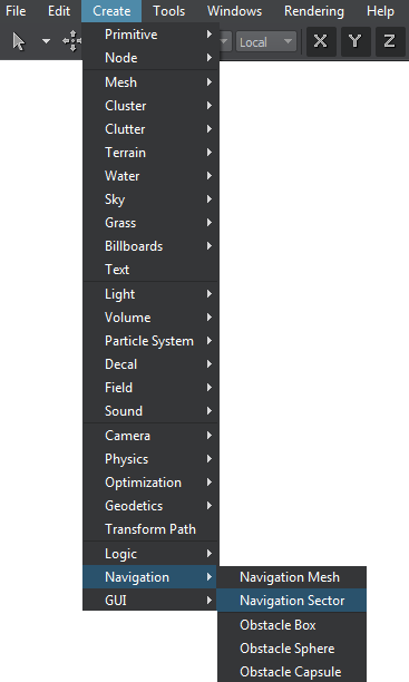

To create a navigation sector via UnigineEditor:要通过UnigineEditor创建导航扇区,请执行以下操作:
  1. Run UnigineEditor.跑步UnigineEditor。
  2. On the Menu bar, click Create -> Navigation -> Navigation Sector.在菜单栏上,单击Create -> Navigation -> Navigation Sector
  3. Click somewhere in the world to place the navigation sector.单击世界上的某个地方以放置导航部门。

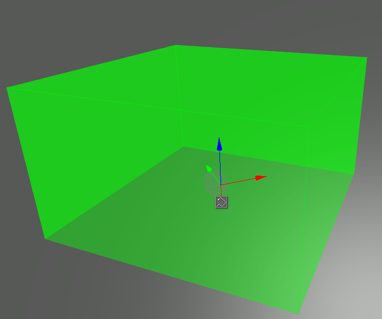

    A navigation sector导航部门

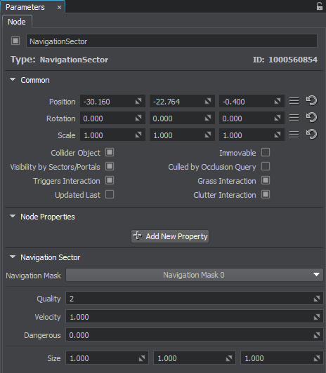

    A new navigation sector is added to UnigineEditor and you can edit it via the Parameters window.新的导航扇区已添加到UnigineEditor中,您可以通过参数窗户。
The created navigation sector only provides an area within which 2D and 3D routes are calculated. The routes themselves should be created from the code.创建的导航扇区仅提供一个在其中计算2D和3D路线的区域。路线本身应该是从代码创建
Editing Navigation Sector
编辑导航区#
In the Node tab of the Parameters window, you can adjust the following parameters of the navigation sector:Parameters窗口的Node选项卡中,可以调整导航扇区的以下参数:
Navigation Mask The Navigation mask of the navigation sector must match the Navigation mask of the route that is calculated within it. Otherwise, the sector does not participate in pathfinding. By using the Navigation mask, you can specify sectors that must be ignored during pathfinding.导航扇区的Navigation掩码必须比赛在其中计算的路线的Navigation掩码。否则,该部门将不参与寻路。通过使用Navigation掩码,可以指定在寻路过程中必须忽略的扇区。
Quality Quality of optimization for route calculation. This value specifies the number of iterations that are used to find the shortcut. The higher the value, the longer the route calculation will take.路线计算的优化质量。此值指定用于查找快捷方式的迭代次数。值越高,路线计算将花费的时间越长。
Velocity Scaling factor for velocity of the point that moves inside the navigation sector along the calculated route.沿计算的路线在导航扇区内移动的点的速度的比例因子。
Dangerous
Danger factor that indicates if a moving point should try to avoid the navigation sector.危险因素,指示移动点是否应尽量避开导航区域。
If the danger factor exceeds the maximum danger factor set for the route, the navigation sector is excluded from pathfinding calculations.如果危险因素超过为路线设置的最大危险因素,则导航扇区将从寻路计算中排除。
Size Size of the navigation sector's box along the axes.沿轴的导航扇形框的大小。
